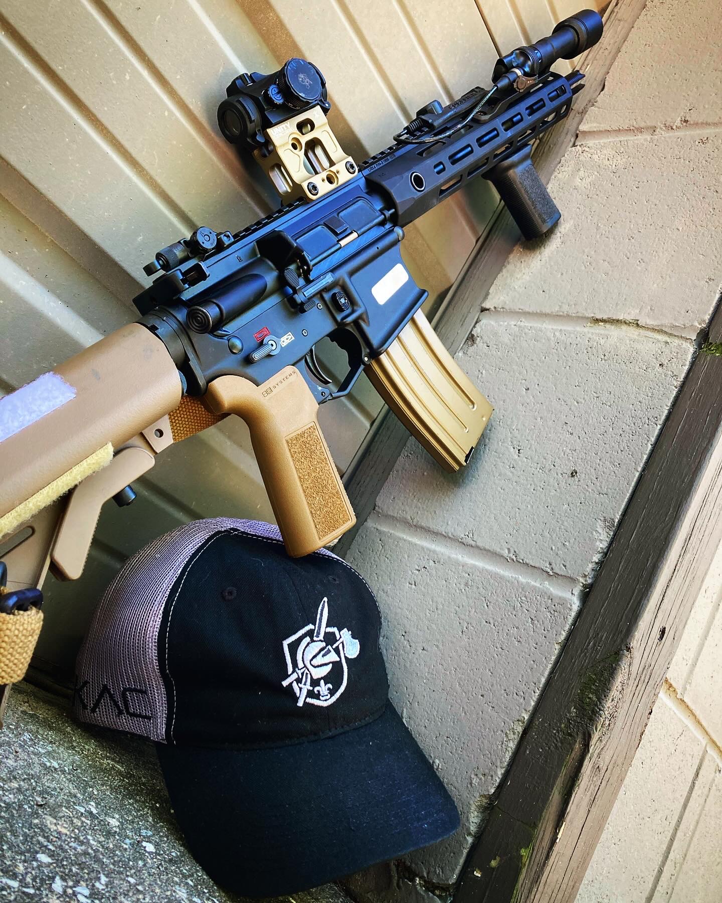

    Long story short, I'm giving KAC small frame uppers another try after getting burned by them ~10yrs ago.
    This thread will showcase my findings on how the current factory KAC SR-15 11.5" [with 3.2 BCG] upper stacks up against a few known good uppers to include a 11.5" FBI ODG "Fed" upper, a Centurion 11.5" upper, and a Colt 11.5" "Old HRT" upper for the comparison.

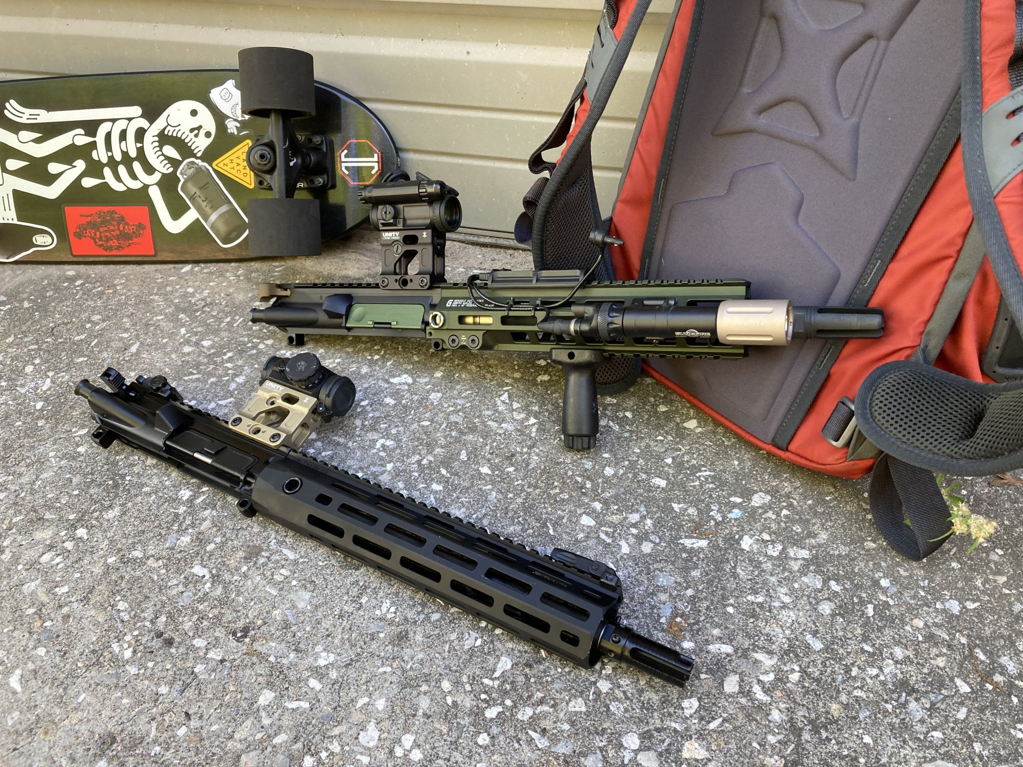

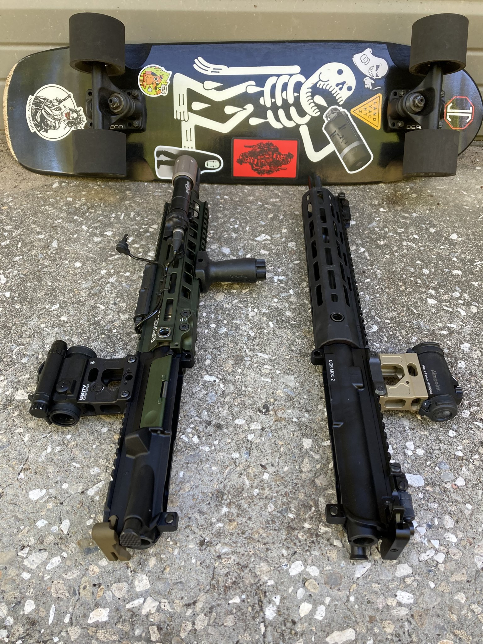

    Uppers to be tested:
    -KAC SR-15 11.5" Mod 2 E3 with 3.2 BCG, with Aimpoint T2 on Unity 2.26" riser.
    -FBI Fed near clone upper: FCD upper, BRT 11.5" barrel, Geissele "Fed" ODG HG, LMT E-BCG, and SF 4-prong FH, with Aimpint Comp M5 on Unity 2.26" riser.
    -Centurion 11.5" flat top, A2 front sight, with FF extended C4 quad, and SF 4-prong FH, with Holosun RD on MI 1.93" riser.
    -Colt heavy "Fed HRT" 11.5" flat top, A2 front sight, KAC RAS M4 HG, Bootleg Adjustable BCG, and SF Closed-tine FH, with Aimpoint Comp M5s.

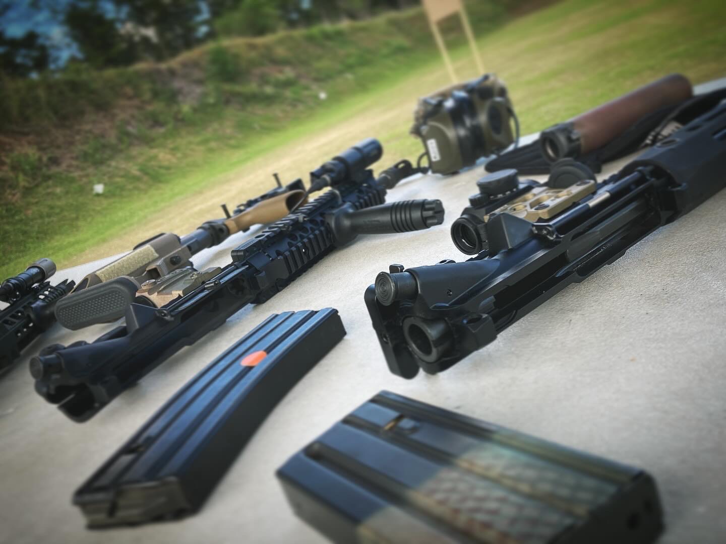

    Actions Observed:

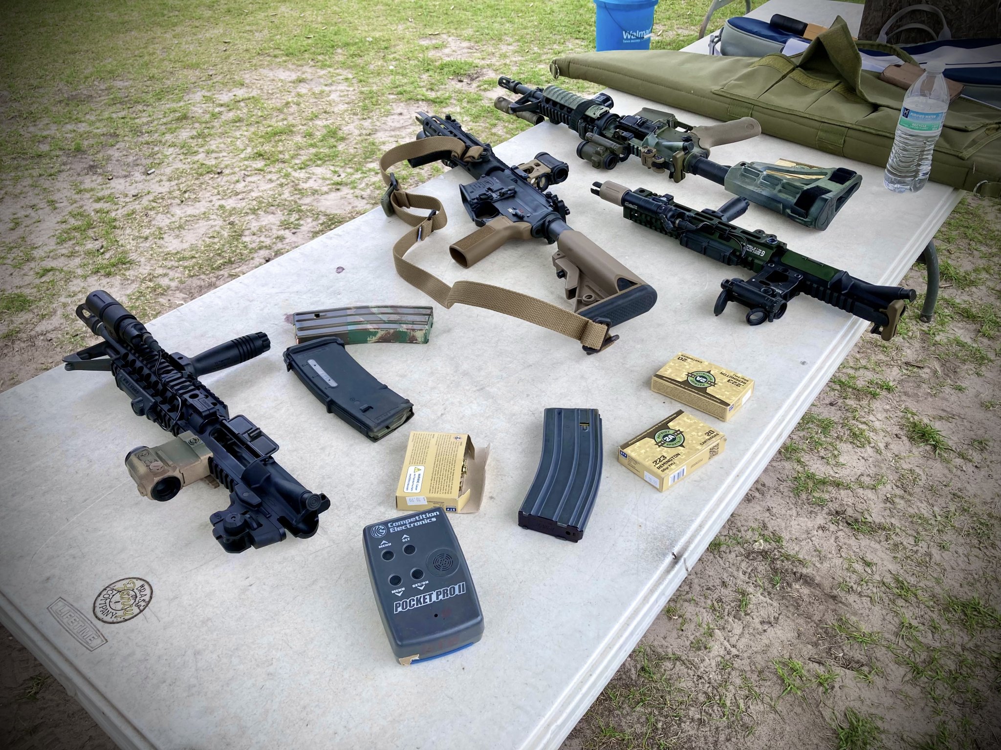

    I brought out all four 11.5" uppers, and a token 10.3" Crane spec suppressed rifle for flavor.
    300rds of PPU 55gr and 60rds of Federal M855 were fired amongst all four of the 11.5" uppers.
    The goal on this outing was to fire 3-6 round fast strings to gauge reliability, felt recoil impulse, how much the dot was jumping, and and how confident I felt in the follow-up-shots after each trigger pull.
    I used the KAC buffer for all of these tests to keep it consistent. Ejection for all of the uppers was from 3-4 o'clock and they ejected at normal distance.
    Take Aways:
    Failures: There was one stoppage in the Centurion upper. One of the PPU cartridges didn't seat all the way in the chamber and the bolt was half way cammed into battery. The cartridge would not easily extract, so I collapsed the stock and mortared it without having to apply much force. I observed that the casing was dented below the shoulder. I don't know if it was loaded into the magazine that way or if it became dented upon ejecting it, but I put it back in the same upper and it fired/extracted/ejected just fine. Until I see more of a pattern, I'm going to chalk that one up as ammo related.
    Dot Jump: The movement of the dot while firing quickly was similar amongst all of the rifles in the group. The Colt [old style] HRT upper was probably the worst, but not by much. The others were very comparable.
    Felt Recoil Impulse and Confidence Getting Into the Gun: The felt recoil to my shoulder was similar between the KAC and BRT Geissele Fed upper, as was the Centurion similar to the Colt HRT upper. The interesting part was how the impulse displayed itself in each upper. The KAC seemed to have the most notable delayed impulse. It felt like it was punching my shoulder all the same as the Fed upper, but it was doing it in such a way that I felt more confident in driving the gun on target, getting into it, and shooting quickly. I'll have to repeat this test with a timer to determine if this is mostly perception or it I was faster on it.
    The felt recoil impulse on the Centurion and the Colt were similar to each other, but the gross recoil was slightly more from the Colt. This was expected.
    The Centurion and the Fed upper felt just as fast, but the recoil impulses were just different. The Centurion [by comparison with the Fed upper] had a more abrupt recoil impulse. With the dot jump being about the same, I found that I could knuckle down into the gun and shoot as fast wit the Centurion as I could with the Fed upper [just with more effort in thinking about controlling the gun through the string].
    Suppressed: I couldn't help myself, so I fired 6rds through each upper with a Surefire SB2 [except I didn't shoot the KAC upper suppressed because I haven't changed out the muzzle device yet]. All of the uppers ran reliably without adjusting or changing anything. They all ejected to the 1 to 2 o'clock. The Fed upper felt the best so far as recoil impulse out of the bunch. There will be dedicated suppressor tests down the road.

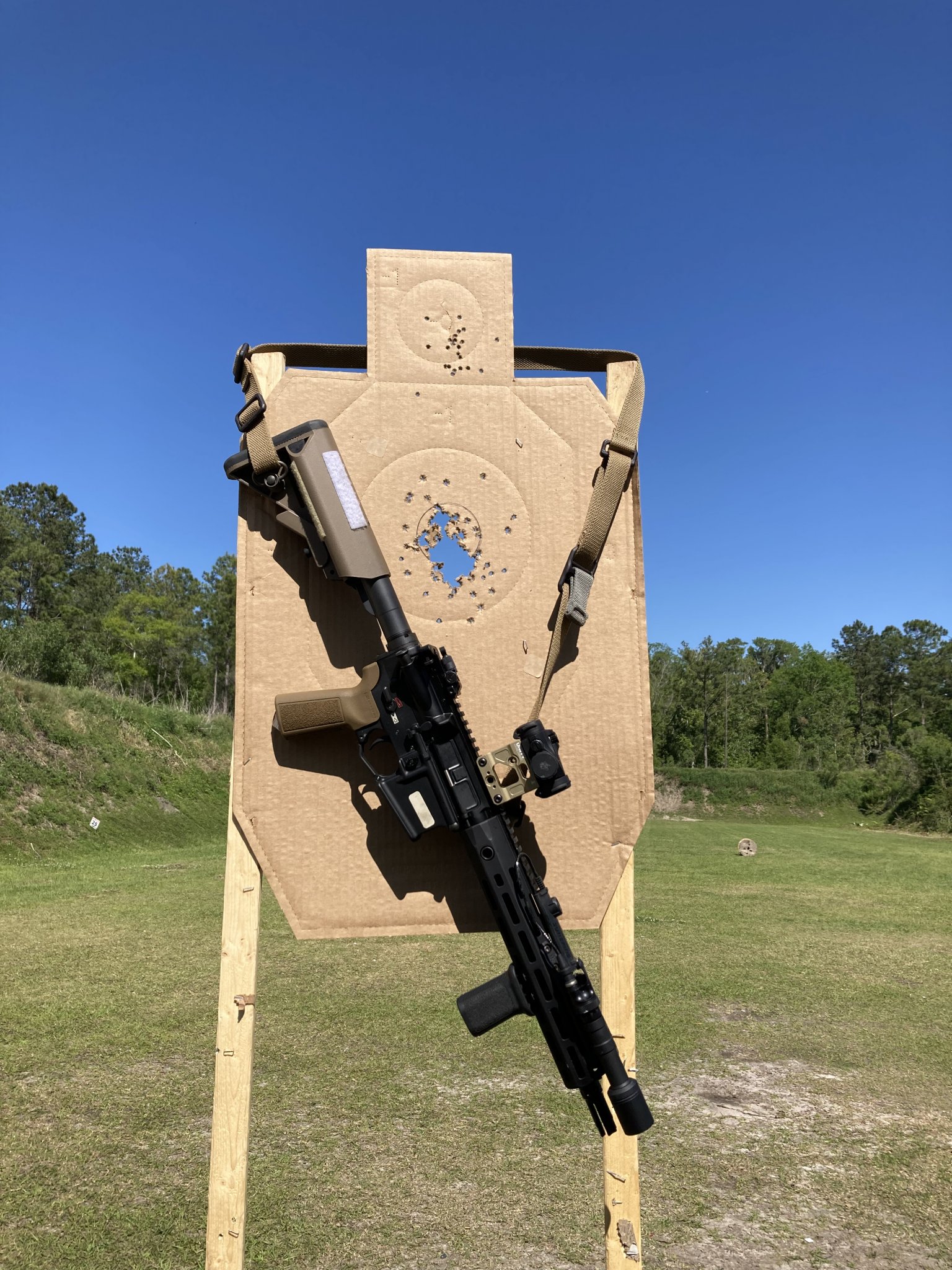

    I brought out the Centurion and Colt uppers for accuracy testing.
    I shot one 5-shot group with each of ammo type to get a feel for general accuracy potential from each upper.
    The ammo types are the following. PMC 55rg FMJ, Black Hills 77gr SMK, FGMM 77gr SMK (.223), IMI 77rg SMK, & Frontier 75gr BTHP.
    Scope that was used to test is a NF NXS 2.5-10 in a Giessele mount. Trigger in the lower used is a SSA-E.
    Firearm was shot off of bags. All groups were shot at 100yds.
    Take Aways
    Failures: 0
    Centurion accuracy results:
    PMC 2.1"
    Black Hills 1.1"
    FGMM .5"
    IMI 1.3"
    Frontier 2.7"
    Colt accuracy results:
    PMC 3"
    Black Hills 2"
    FGMM 1.5"
    IMI 1.1"
    Frontier 1.6"
    Thoughts:
    I used five shot groups in an attempt to conserve my more expensive match grade ammo while still trying to showcase realistic performance of the cartridge/upper pairings.
    The 5 shot group done with the Centurion upper using the FGMM was intersting. I'm curious if I can repeat those results.
    The Colt upper was putting the IMI into a .5" pattern until I fired the last round. It's entirely likely that should have been a ~.5" group but then I got in the way of it.
    In the Centurion, the PMC shot better than the Frontier "Match" ammo...:ROFLMAO:
    I was surprised by the results of both uppers. They both did very well in general for CHF CL mil-spec type barrels.
    I'm excited to see what the Fed and KAC uppers will do.

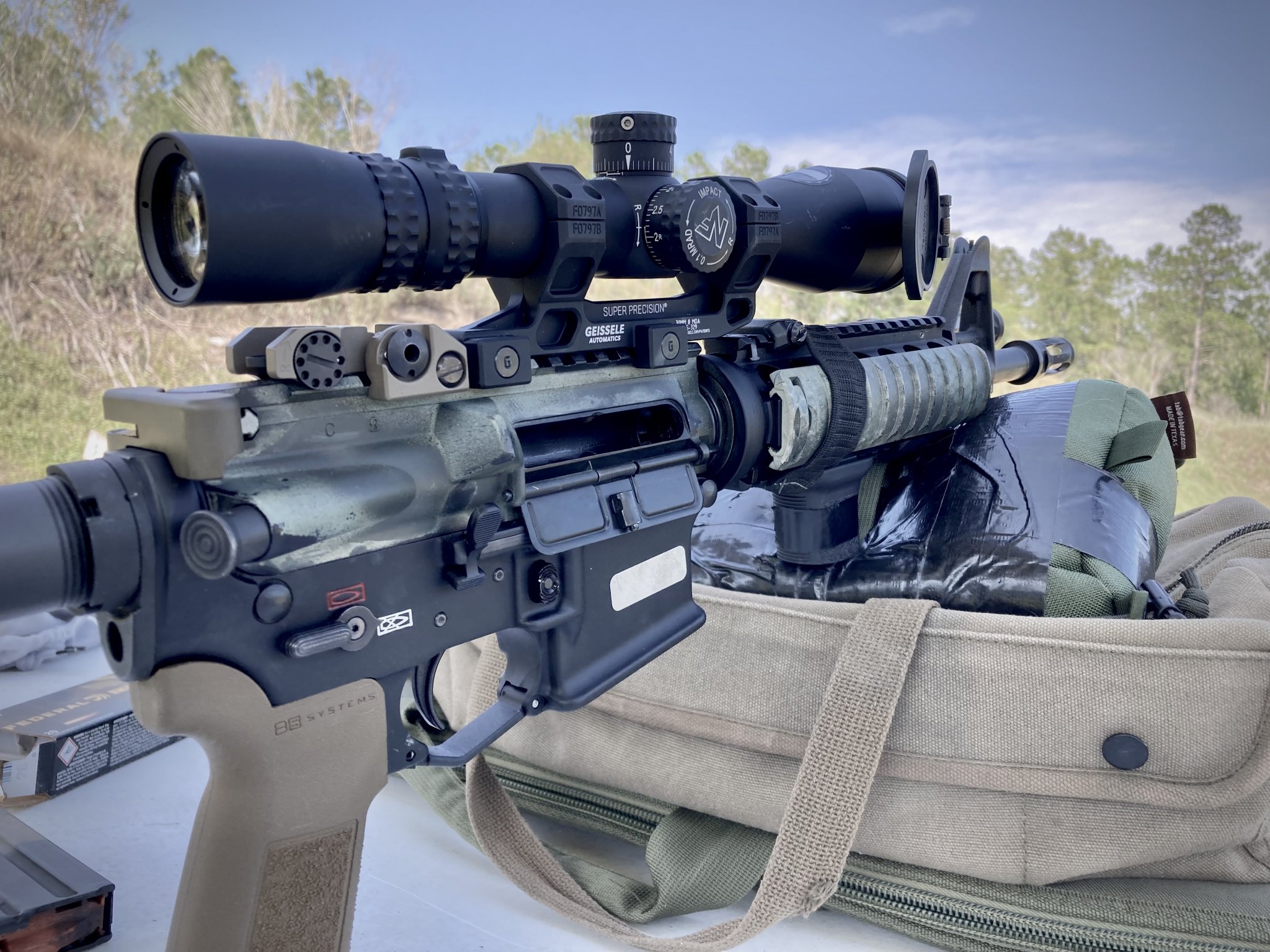

    I brought out the KAC and Fed uppers for accuracy testing.
    Take Aways
    Failures: 0
    KAC upper accuracy results:
    PMC 1.9"
    Black Hills 1.9"
    FGMM .9"
    IMI 1.1"
    Frontier 2.2"
    Fed Clone upper accuracy results:
    PMC 2.1"
    Black Hills 1.4"
    FGMM 1.1"
    IMI .9"
    Frontier 3.6"
    Thoughts: No real surprise, all four of these barrels shot at least "decent" with most of the match grade ammo. All but the Colt barrel had at least one sub minute 5-shot group and even it wasn't lagging too far behind the others. Frontier match ammo sucks. I should probably invest in more FGMM 77gr based on its performance in this test.
    I found that I would feel confident in taking any of these uppers [with it's known good shooting ammo] to a DMR match, and probably do well with it under 500yds if needed.
    I wish I could afford the time and ammo to shoot five 5-shot groups of each ammo type through each upper, but currently time and money are the resources I don't have. I hope the limited data provided here gives at least an idea of how each upper preforms accuracy wise.

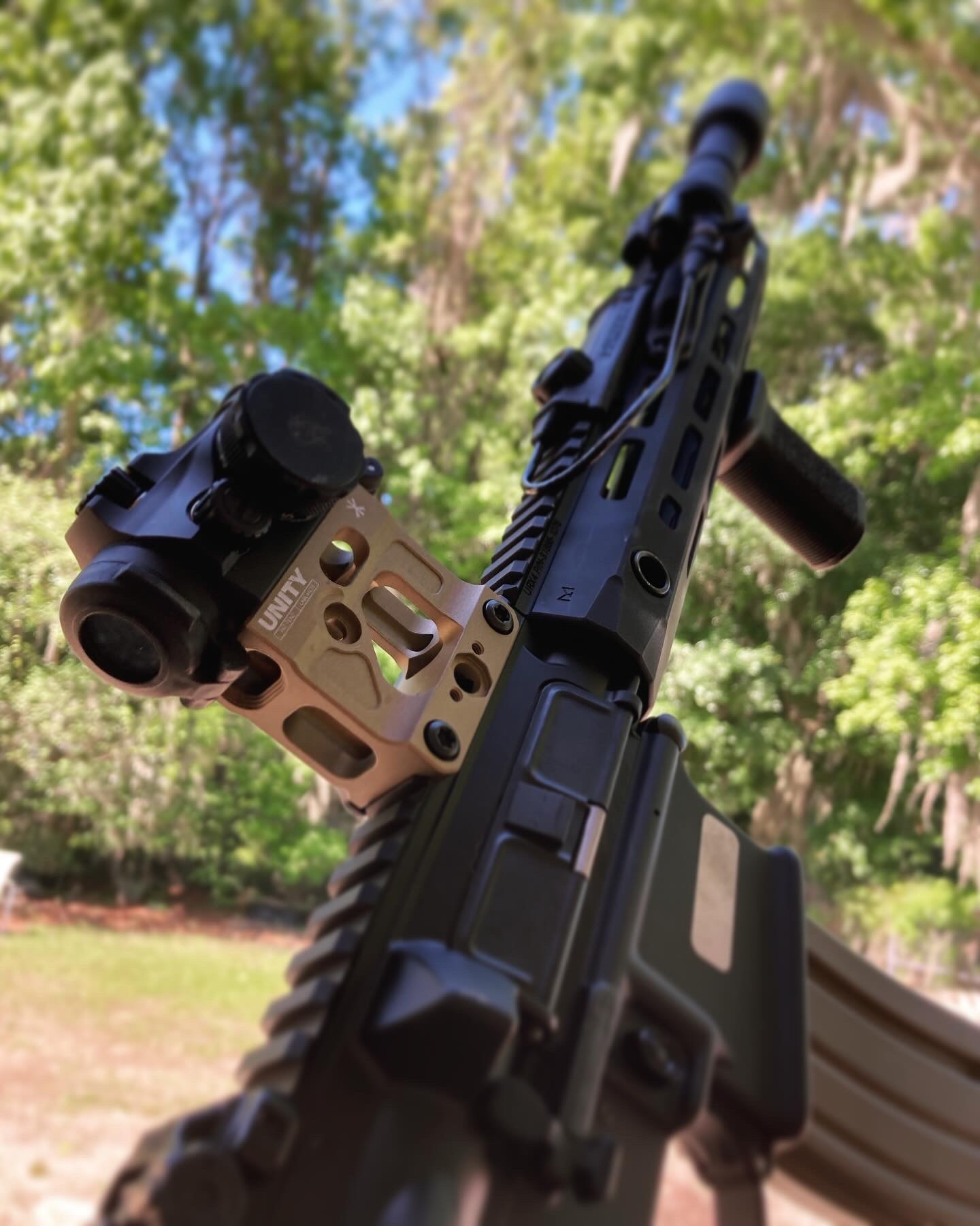

    Wow, those Unity mounts really look tall; those Aimpoints could use guy wires! I might have to try one sometime.
    For a truly heads up position while shooting and for passively aiming through night vision, this is the way.
    Just make sure you account for your height over bore. I've missed varmint sized targets up close by forgetting this key concept. :LOL:

    Laughs in KAC SR15 upper / LMT MARS-L lower 😘😘😘
    @clcustom1911
    That's by no means a new lower either. I just never took off the sticker. It's now rubbed/faded off white and have no more legible markings on it.
    It's now a point of pride to keep it there and see how it wears [and if it will ever just fall off].
    Eventually I'll paint over it.
    BTW, nice master hybrid gun. I'm beginning to see the way.:cool:
