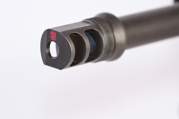

When thunderbeast converts a cb can to direct thread they take a cb brake and semi permanently mount it in. By semi permanently I mean you can't / shouldn't try to do it at home.
Cb brake
I think they do the exact same thing when they make direct thread cans originally.

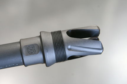

Once it is converted back to cb you can go either way. It won't affect anything as long as you adhere to Thunderbeasts recommendations on minimum barrel lengths (5.56 11.5" and 300win 18"). Thunderbeast makes cb flash hiders as well which doesn't really have a blast baffle.
Cb flash hider
This is all assuming you have a 30 cal ultra 7. If you have a 6.5 ultra 7 don't run it on the 300win. You're fine either way on the 5.56.
