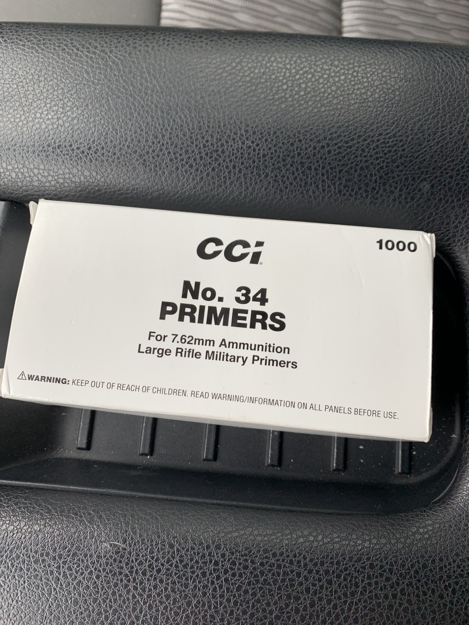

CCI 34 large rifle primers for regular bolt gun ok?
mw22481
Feb 2, 2019
59
1
Hello was just wondering if it’s ok to use
CCI 34 large rifle primers for reloading in my 6.5CM and 6.5-06.... the box says for “7.62x21 military cartridges. See pic below . I was able to pick some up 1000count recently. Not what I would want to shoot with but times are tough rt now with availability. Can’t find the Bench rest primers. Any help is appreciated. Thanks
Yes, it is fine to use them. Best practice is to load a few at lower charges and work back up checking your velocity and pressure as always. Remember that these have slightly harder primer cups, and may show less pressure signs than whatever you were using previously.
