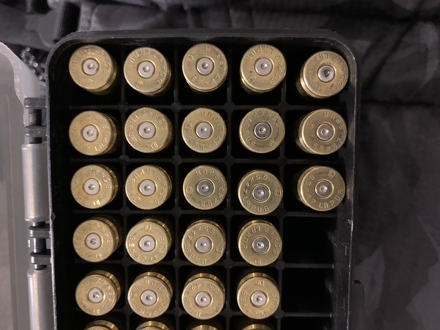

I recently made the switch from 6.5 creed to a 25x47. I had a small stash of CCI400’s I planned to use during the primer shortage since I switched to Lapua small primer brass. Loaded up a 2 rounds per charge weight from 39.6 to 41 gr H4350 and pierced a primer at 41 gr. Backed off to 39.8 and loaded 43 rounds for a small match last weekend and saw quite a bit of cratering and 1 very close to piercing. Do I just need to back down even more or am I going to struggle with pierced primers no matter what until I can find some 450’s or BR4’s? I’ve also seen where the 400’s are not recommended for use in AR’s so what are they good for?
Good for most anything. You may have to tweak your powder charge a bit, but that's all. The 400s have a bit softer cup than the 450s and BRs, but you can get them to work. Also, if you are using a Rem700 that has not had the firing pin bushed, cratering primers is common.
CCI #400 really have no place except moderate 223 loads or lower pressure loads like 22 hornet.
I agree with you on that one but many use them for the mid sized rounds.
I personally don't want to risk torching the face of any of my bolts and years ago standardized on the 450's but still have a couple 1000 cci400 primers that may end up getting used for small pistol loads.

Thanks for all the reply’s so far. I’m using the blackjack ACE 131 gr bullet .030 off the lands, impact action, 26” Bartlein barrel in 25x47.
39.6: 2812, 2829
39.8: 2853, 2849
40.0: 2886
40.2 no reading
40.4 no reading
40.5: 2911
40.6: 2927, 2922
40.8: 2923, 2927
41.0: 2949, 2952 blown primer
I’ll probably test 39-39.5 next and start looking for new primers.

The 40.7 gr area would be interesting to explore for sure. Have you looked for any issues with your bolt and firing pin. Making sure that your firing pin is not extending too far and making sure that it fits you bolt face properly by bushing the firing pin might solve your issue.
He allready stated he was using an Impact action so sloppy fit wouldn't be an issue, the real issue is using a primer that is rated for moderate pressure rounds and the 25x47 certainly doesn't fit that criteria.
Has anyone had to bush an impact bolt? I did a search and couldn’t find anything. I do really like the 40.6-40.8 range and it’s tempting to try again but I’m pretty sure the primers wouldn’t hold up. I don’t want to risk messing up my new action for a little velocity gain. Even at 2800 my dope is 1 mil less than my 6.5 CM was at 1000

I always wondered about the primer dimensions on that chart so I measured a CCI 400 and a CCI 450.
Cup ThicknessCup DiameterCup Height No Anvil
CCI 400.0195.1754.1102
CCI 450.0259.1755.1131

Small pistol primers are not the same a small rifle primers. They have a cup thickness of .017".

Did you specifically find the spec for small pistol MAGNUM vs the 400s?
Edit-
Looks like .017 vs .020.
If loads were worked up, I wouldn't sweat 400s for pistol in a pinch.
