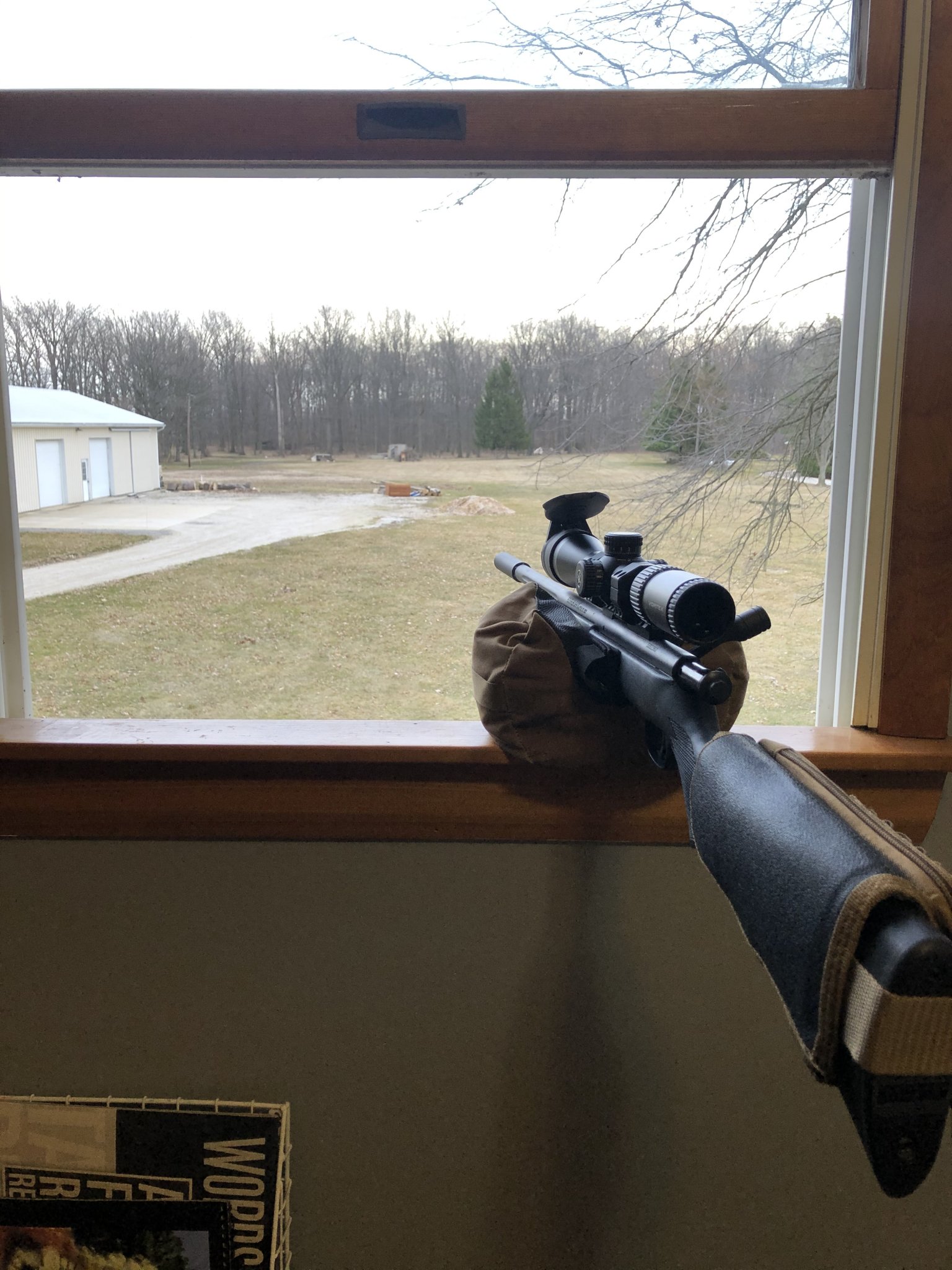

    Heres me shooting out my back, 2nd story window. 180yds on the dot to the shooting pit. 22moa holdover or dial up.

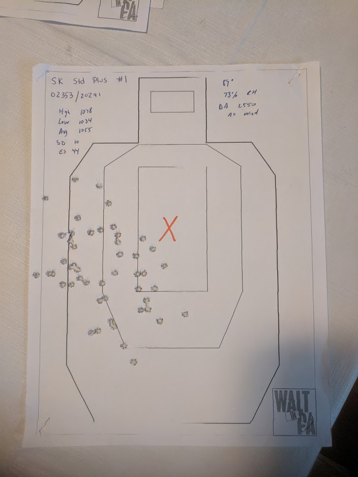

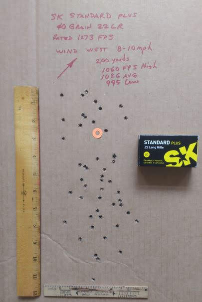

    Looks to be slightly better than my results on ES and SD, but groupings at 200 looks very similar to what I've gotten so far.
    Thanks for copying those over. Love to see large groups at yardage for some of the .22 stuff
