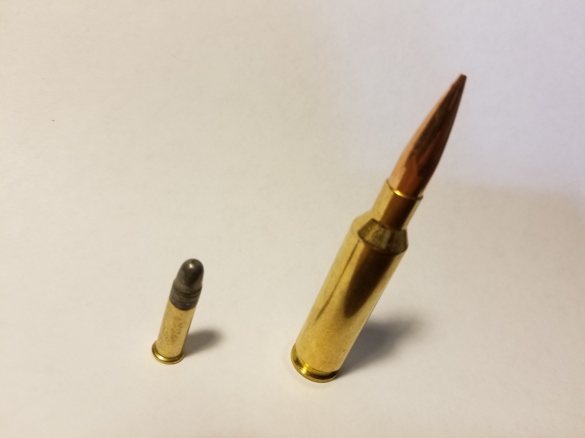

Hypothetically, let's say I own a .22lr rifle with a 16in barrel that is threaded 1/2x28. I also own a TBAC Ultra 9 with a 6.5 aperture. I then mount a 223BA brake (the only brake they offer in 1/2x28 that will fit the TBAC Ultra 9) and mount the suppressor to that threaded brake. Would this damage the suppressor or barrel in any way? I am trying to avoid another tax stamp and 9 month weight for a .22lr suppressor but if it must be, it must be. Thanks in advance.
It should be “safe”. My only reservation is that .22 is dirty as hell. Many/most rimfire cans come apart for cleaning, and it is just stupid how fast they fill with carbon and lead. I would be a little worried about putting so many city miles on my expensive TBAC U9, that’s all.
