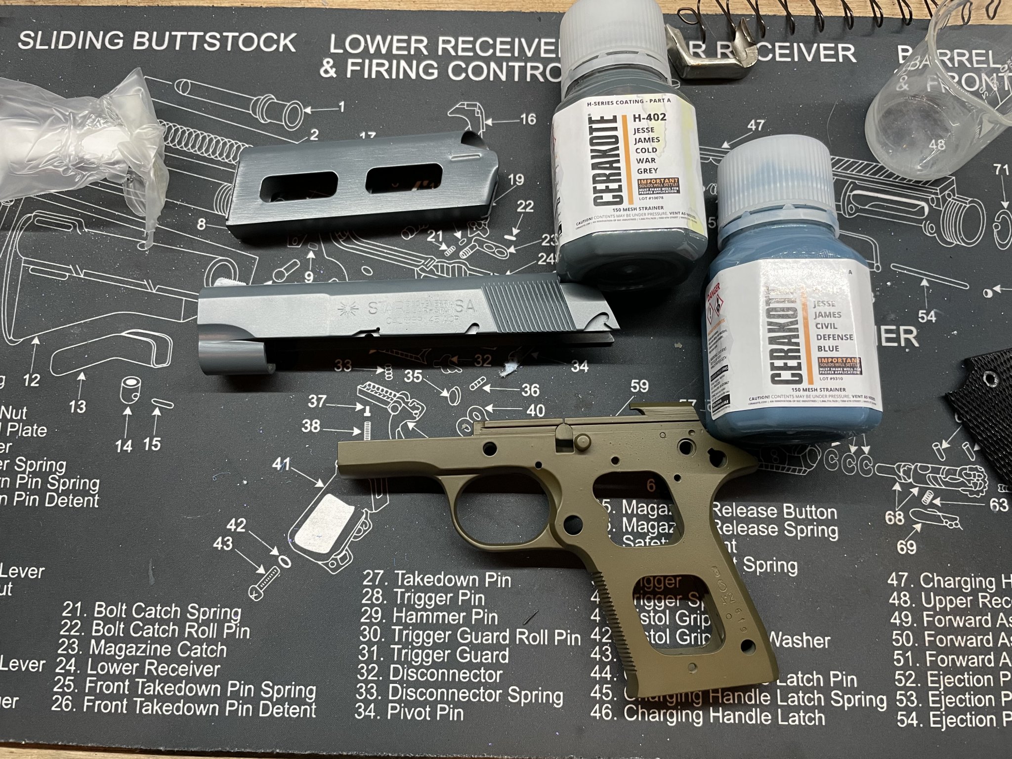

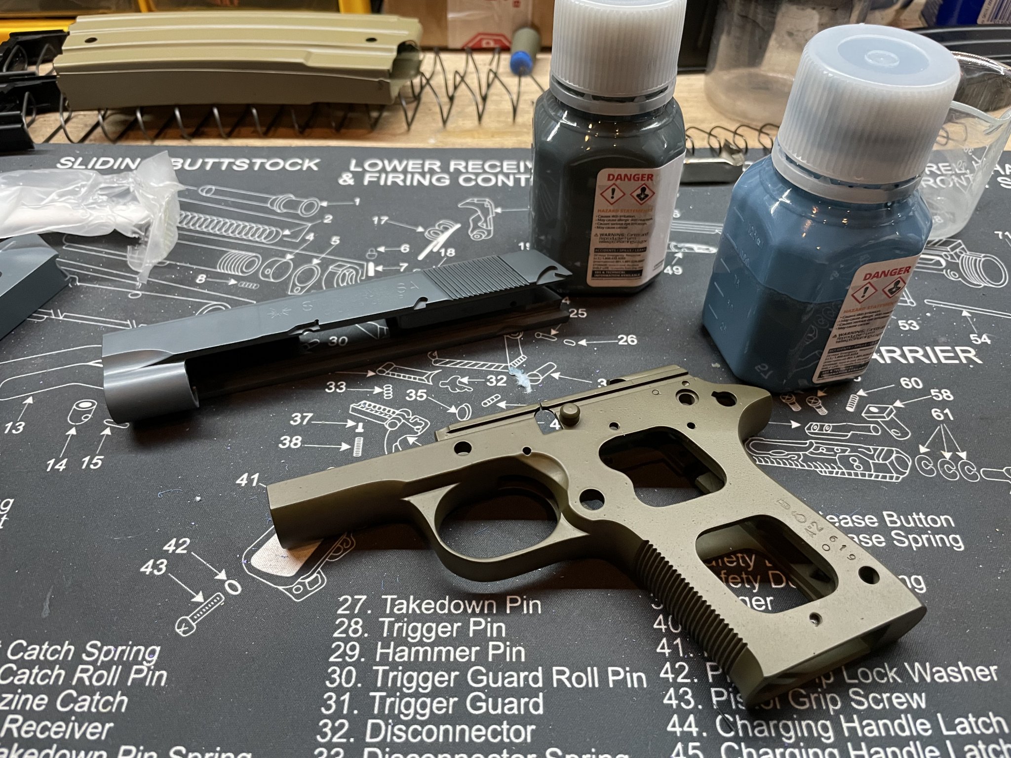

So I was Cerakoting my Star PD .45, Cold War Grey on the slide and Civil Defense Blue on the frame. For reasons unknown the frame changed from blue to brownish green in the oven. I prepped the surface well. Sand blast, wipe with acetone and heat up the parts to rid of any residue. The blue looked great going into the oven. Oven was at 275*. I checked about 45 min in and the frame had changed color. The grey slide looks great.
The brown/green color actually looks really cool so I think i'm going to leave it. Unfortunately, it doesn't go well with the grey slide so I'll probably respray it to black or tan.
Has this color shift happened to anyone else? Any idea what caused it? I don't want this to keep happening.
Thanks
