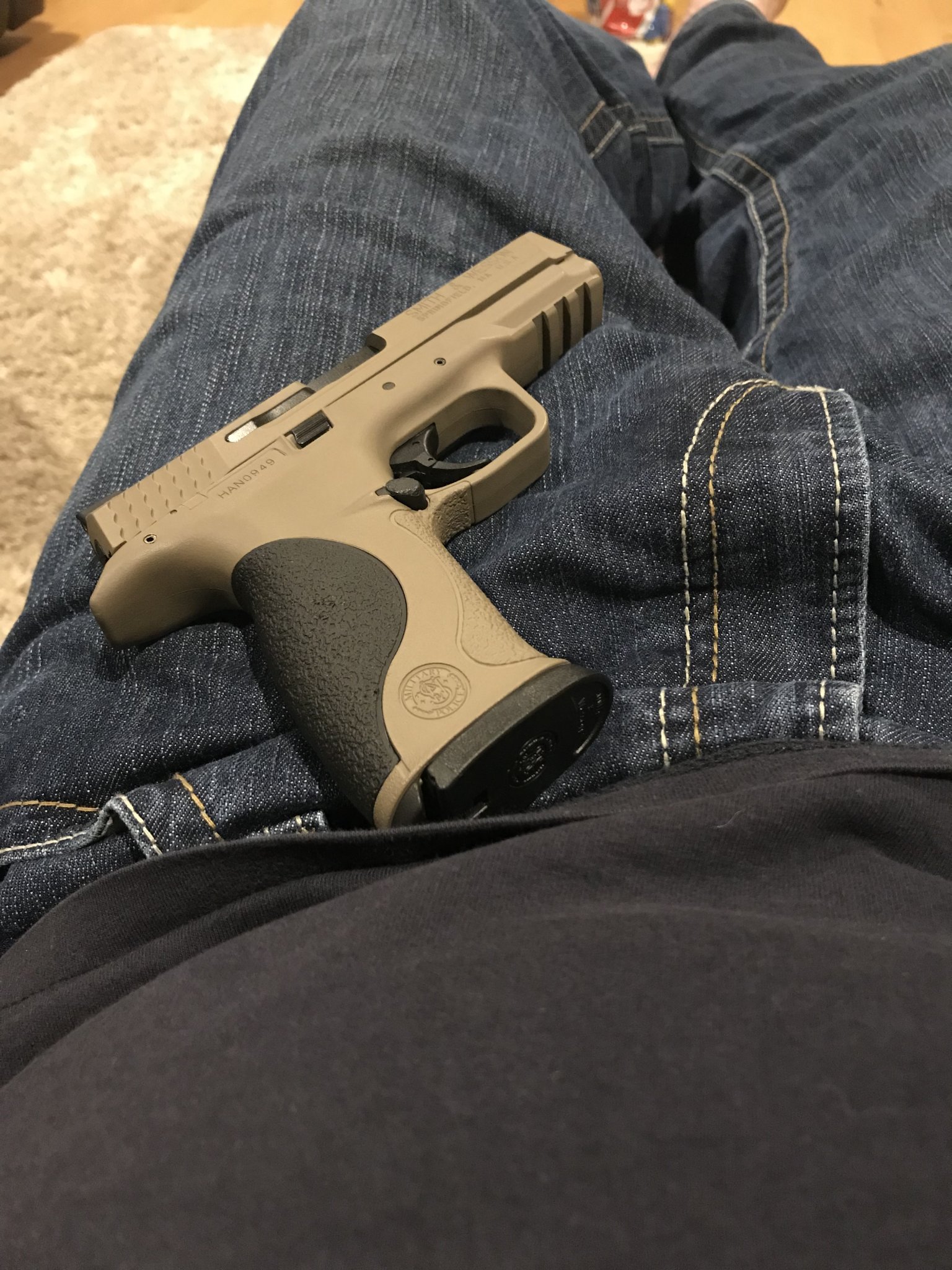

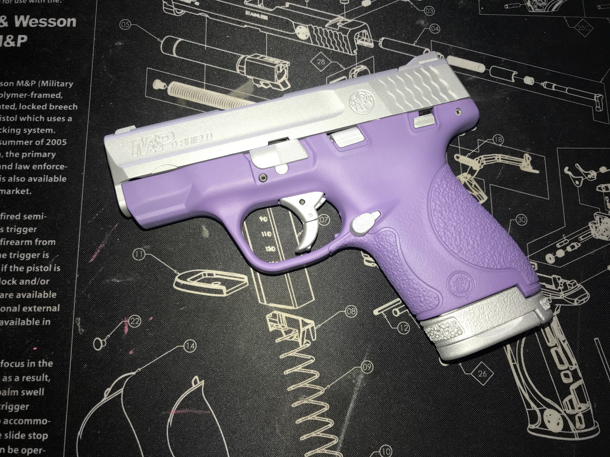

Just a quick update... I got some wheels on this beast and found out who the manufacturer is so I was able to get ahold of their tech support people to find out about how it was insulated. Fortunately, it’s 1” fiberglass batt insulation on all walls and doors, so I’m good to go!! Just need to order my heating elements and controls! In the meantime, the smoker I converted to a curing oven, while too small for rifles, does a fine job with handguns!
