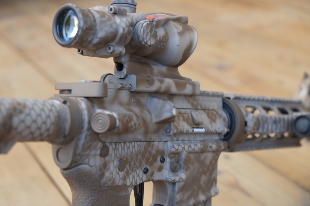

Here is something that I would have never figured out with going to the school .... Patterns and optics! Did this last week! ImageUploadedByTapatalk1405340914.904569.jpg
Stay safe.
Sarge
