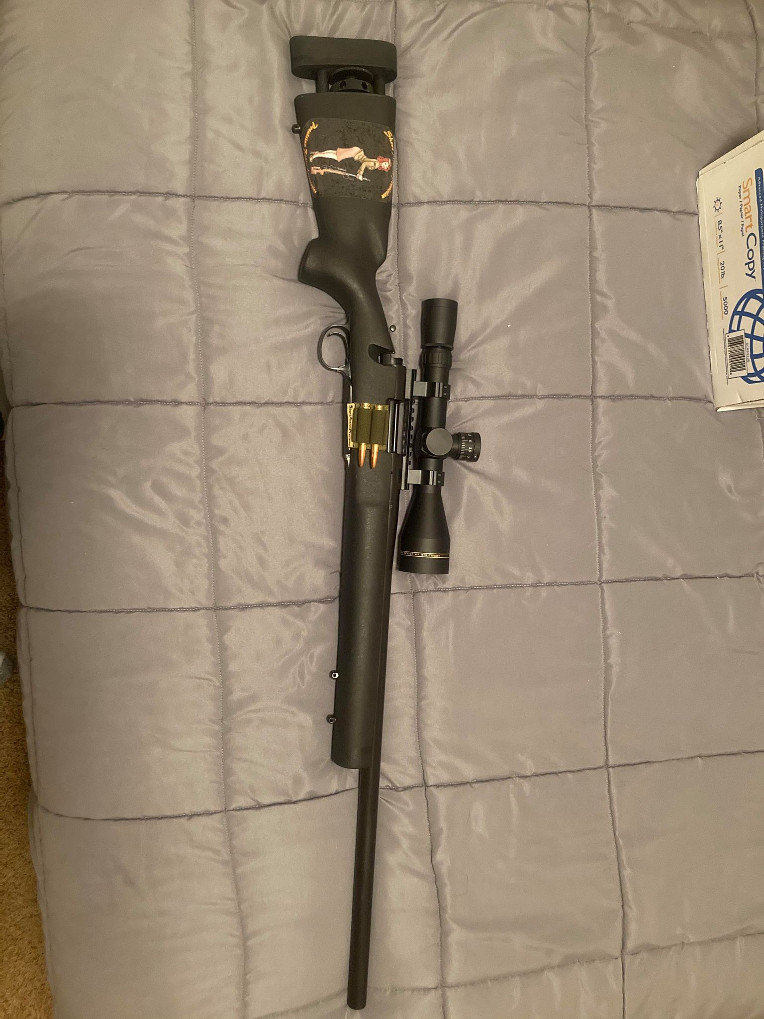

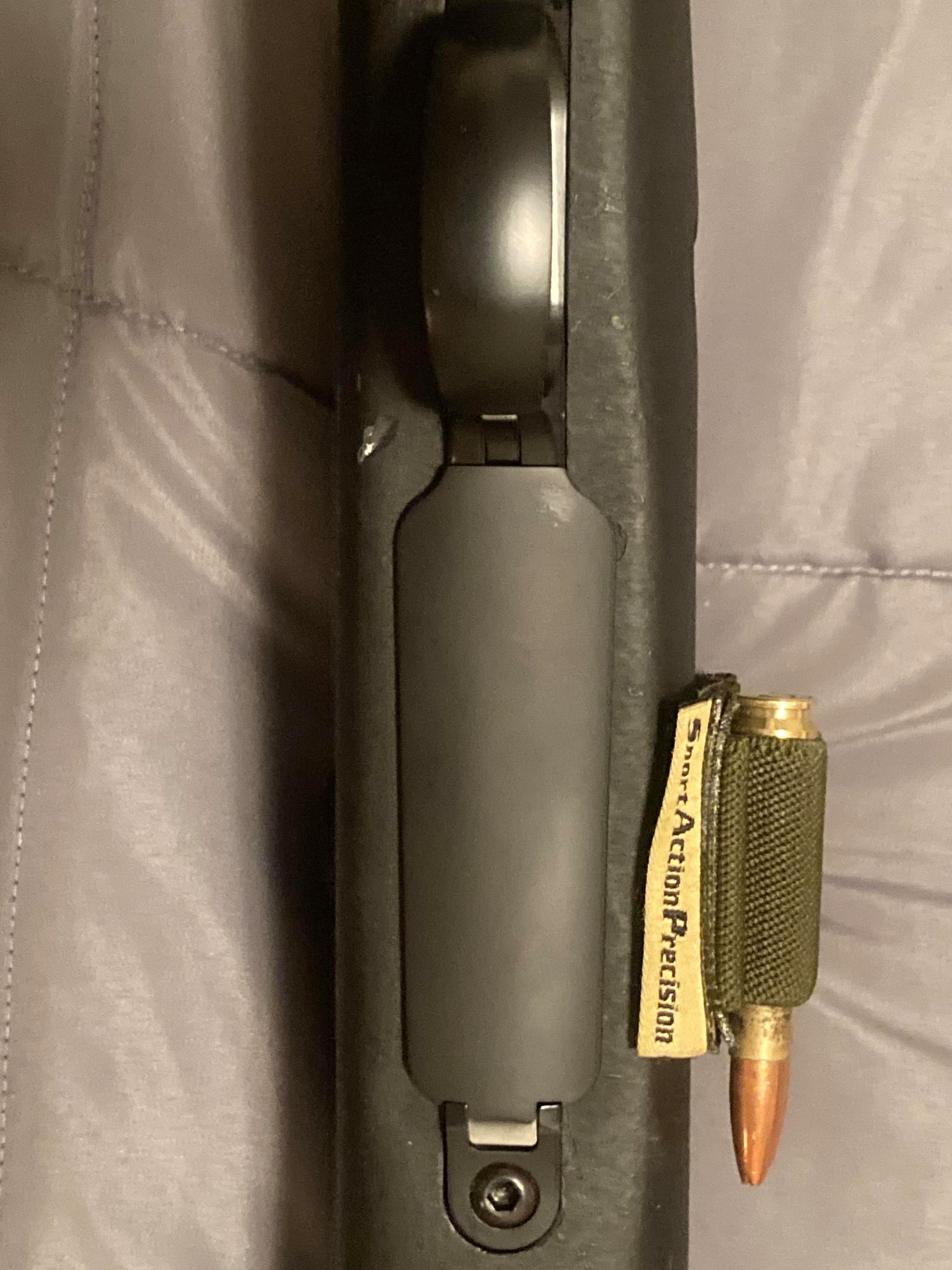

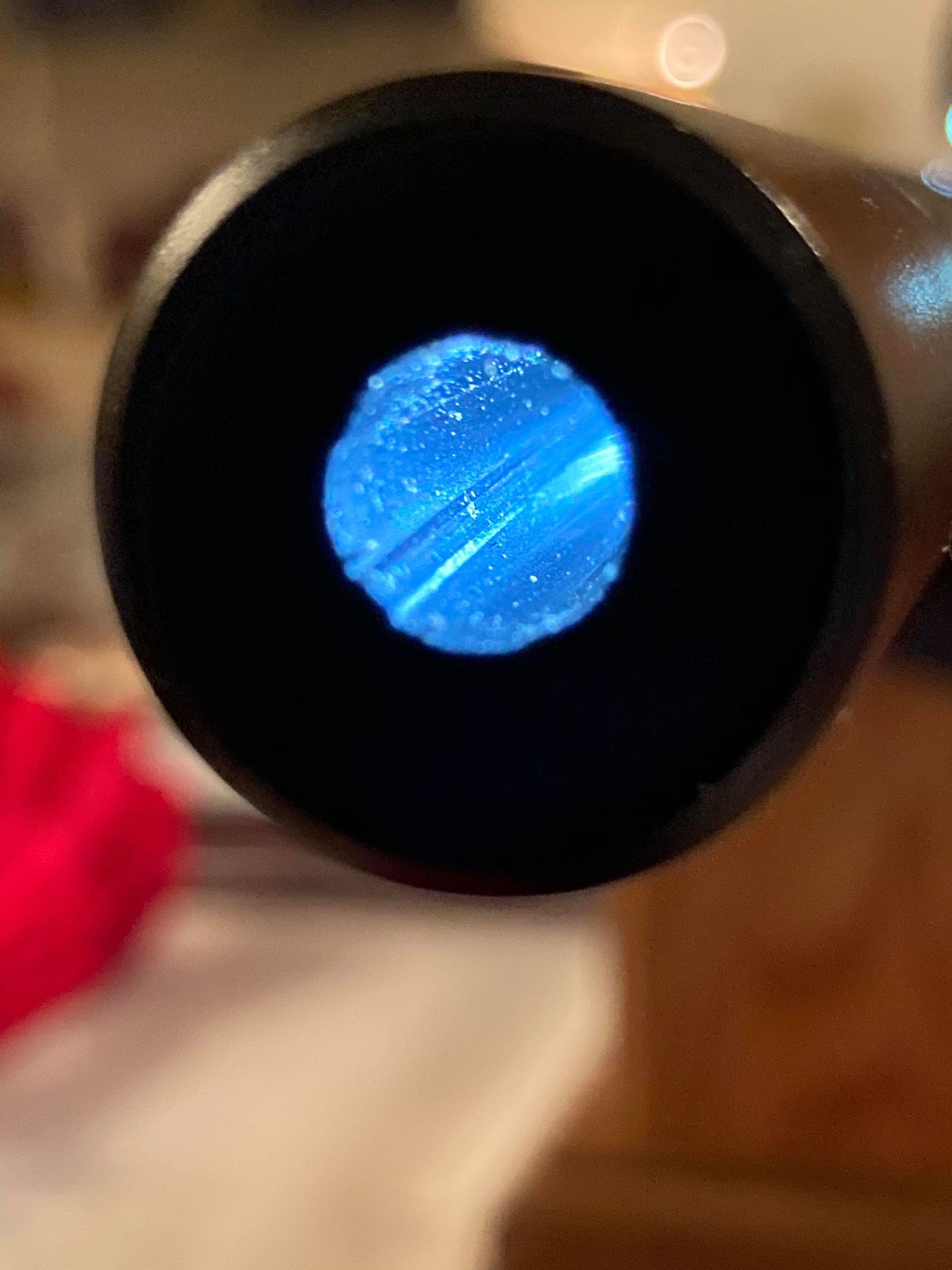

Recently had my 700 cerakoted. Came out good not perfect but pretty good. However, I found that the first inch of the barrel has been cerakoted. I thought that they had taken out the rifling by sandblasting but I think its ok. I thought I cleaned the barrel better but it looks like I still have some media in it. Is there any way to clean out the cerakote? I'm guessing I need to clean the hell out of it? Any ideas or should I even worry about it? I just noticed it when I put it together. Also is there any way to touch up the floor plate where the bare aluminum is? Is there any paint similar to graphite cerakote? The really really good news is that since the bolt is apart, I was able to check the timing/primary extraction. Its actually good to go. Least it has that going for it.
Cleaned the hell out of it, no paint at all in the barrel was all residue left from it being blasted. Took a good a lot of bushing/wiping to get it out. With that said, I cannot get all of the grit out of the barrel, chamber, bolt, or bolt body. Should I just take a bottle of pb blaster and just flush the parts out? Stick the parts in a parts washer? I have noticed that now the extractor tears the hell out of my brass and a few spots on the lugs are in the white so I guess they may have hit the face? Also is there any way to touch up spots?

i mean, there is that potential....i dont think its likely, seeing as Cerakote is only applied a few thou thick......but its possible.
i would send a few rounds down range to check.....it could be a big nothing burger.
it if IS effecting accuracy, the only way to remove cerakote is to physically remove it....solvents wont touch it......the safest way to abraid it out is to just send rounds down range.....i would be surprised if it took more than a dozen rounds or so to get it all out of the barrel.

Just brush the shit out of it. It might have some lubricity, but it not a delicate particle, so i can’t imagine it playing nice if you run it over with a bullet.

If you brush it and scratch it up a bit and then soak a patch with acetone or brake cleaner and let the patch sit on the site overnight that will loosen it up.

Whenever I blast barrels for cerakote, I plug them before blast and of course during coating. There is always a tiny amount of media in the barrel. I hose the barrels out with high pressure water, and then do a normal clean/oil/dry routine before reassembly. That media will wear out your barrel faster than anything.
