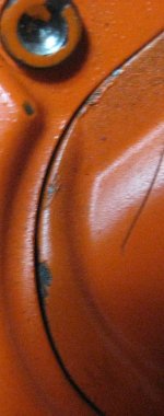

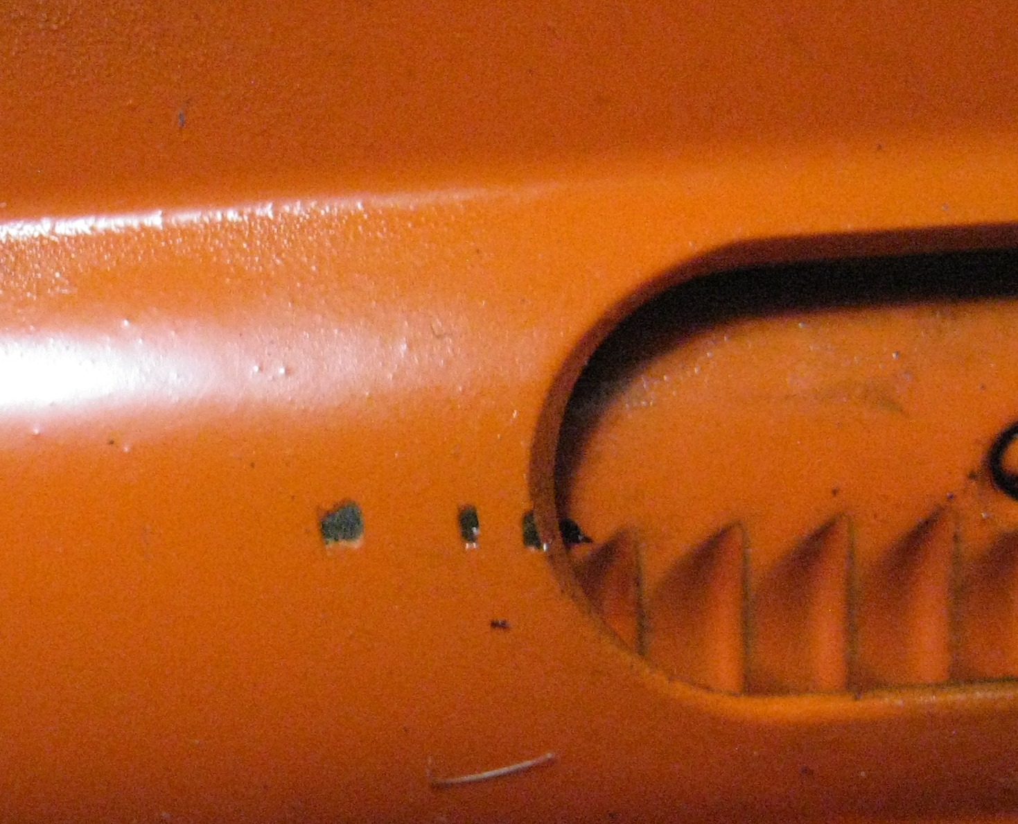

I don't know about that application, but.... Cerakote will chip. I'm sure if you engrave over Cerakote it will chip around the engraving... but again, this is just my experience with the product. If you are painting black over black, it's not too noticeable. Cerakote is a hard finish.

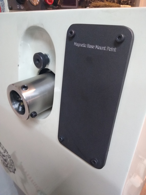

This is a magnetic base mount plate on my lathe. Cerakote cobalt, engraved after the fact.
If you engrave before cerakote, you get a subdued look. If you engrave after, the markings stand out alot.
Looks like that particular coating was improperly applied. I don’t know that I would judge the product based on that sample.
