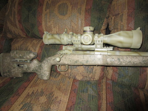

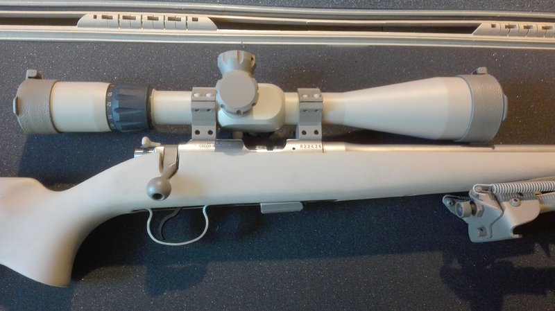

i just taped off what i didnt want to paint and the lenses. Nice coat of desert sand and fde on the turrets rings and caps. If u want the turrest in the same color just tape of the indication marks and off u go.
let us know how it came out. I'll be doing the next one shortly
