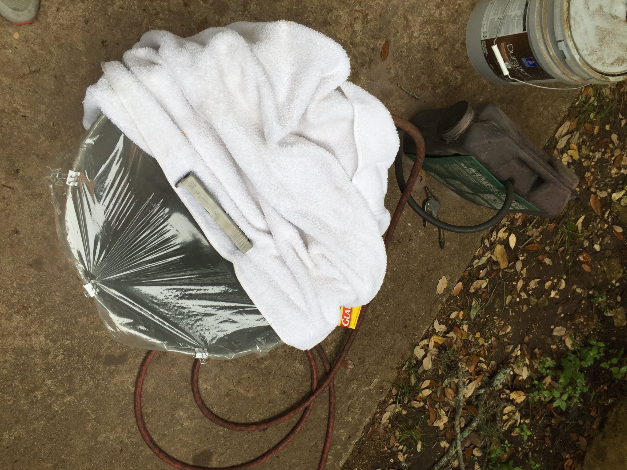

    It doesn’t have to be fancy, a trash can with a towel to stick your arms under and saran wrap to see will work as a cabinet. Then a cheap sand blaster and whatever media you want, bead blast/aluminum oxide etc
