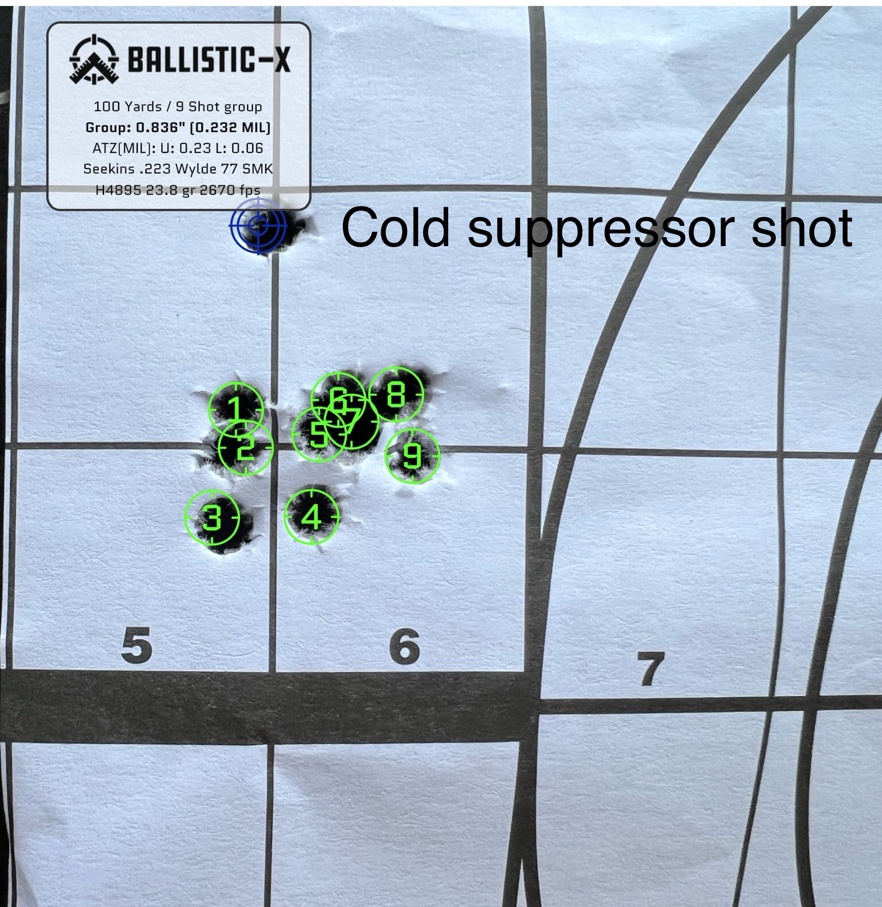

CFE 223 is adequate for 55’s and pray/plinking, I’ve yet to find a good precision load with it but to be honest I think I tried three or four variations only.
I shoot 77gr SMKs over CFE233 but wouldn't pay $325 for it, for whatever that's worth. I'd find something more temp stable, cleaner at that price
What’s your load out of curiosity- I have a ton of the powder unfortunately
I guess I deleted some stuff, I can only find notes for a Wylde 16" Noveske, although I shoot it out of 2 other barrels. I've tried charges from 24gr up to 25.7gr.
1.865"cbto, 24.9gr, shot 0.6moa, lowest SD, 2650fps. Be aware that's 96.8% fill & IMO, at the upper end of pressure for a powder that isn't the most temp stable. Crimping added 55fps and SDs went to hell. I could have been over crimping, I really don't do that ever

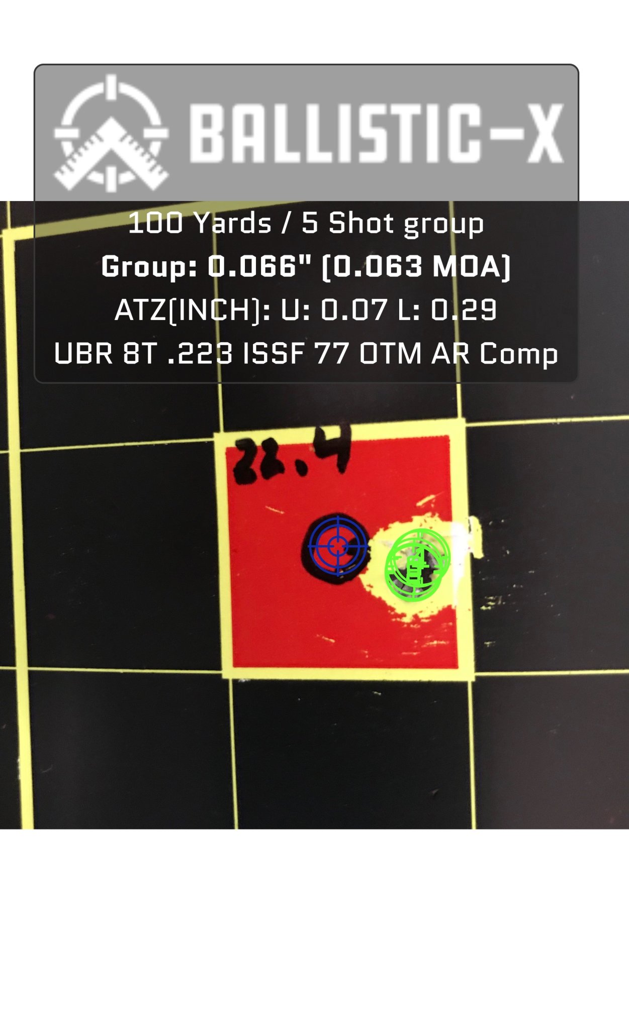

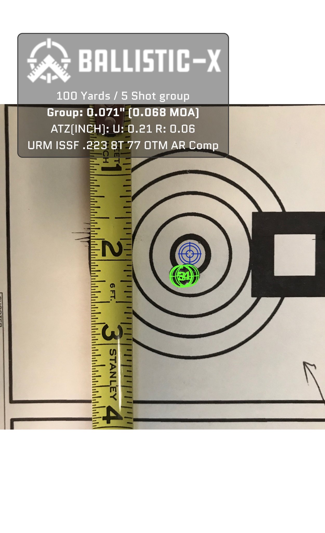

AR Comp with 77 OTMs:
