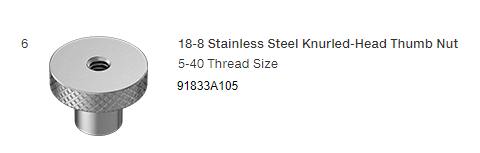

I just picked up a little knob from McMaster Carr I could spin onto one of my old cleaning rod sections:

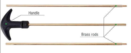

Using it on one of these single rods (already had a kit I bought but never ruse the rods outside of pistol barrels:
