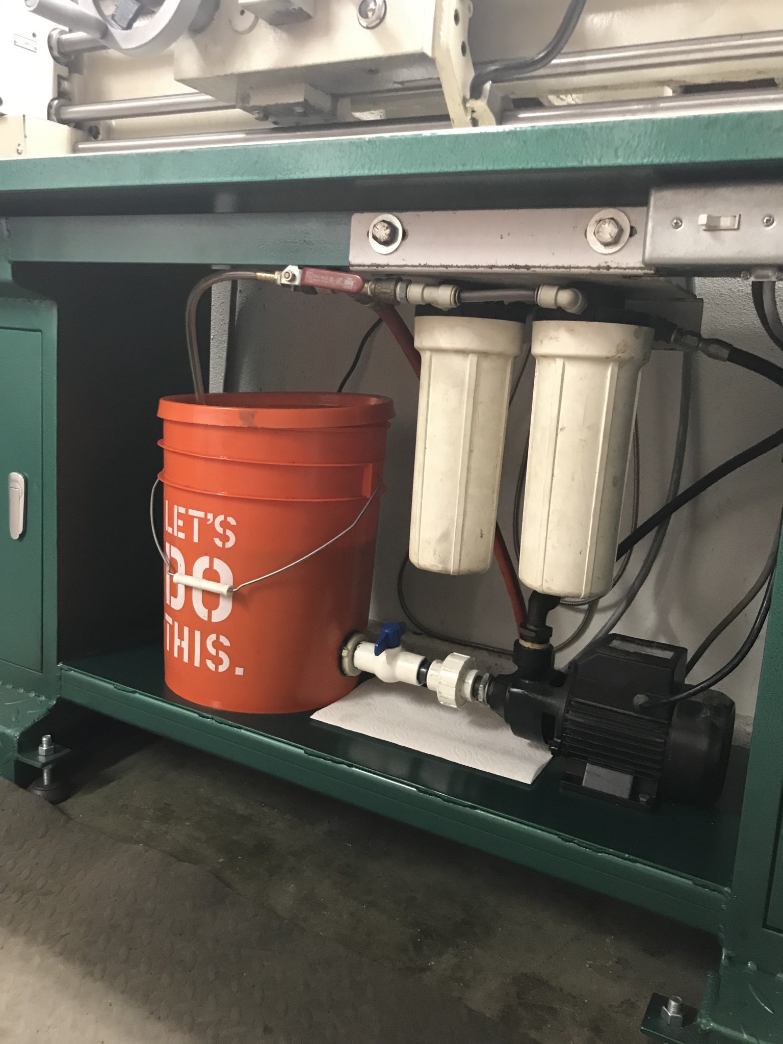

Cheap water pump from HF. Puts out around 40psi with dark cutting oil. Whole house water filter from Home Depot. 7gal bucket, brass fittings and what not. High pressure super swivel from Ebay I have around $200 into my whole setup. Well worth it.
Looks like Ill be building something similar to yours. Parts are on the way.

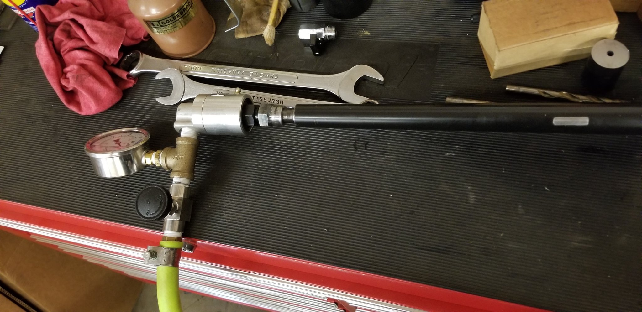

I don't believe this is true at all, it is however a matter of opinion. The through bore flush is very nice to have and will dramtically cut down on time it takes to chamber a barrel, and some will suggest that tool wear is decreased as well. I have the Gretan through bore. For $140 plus the pump you choose it is well worth it to me.

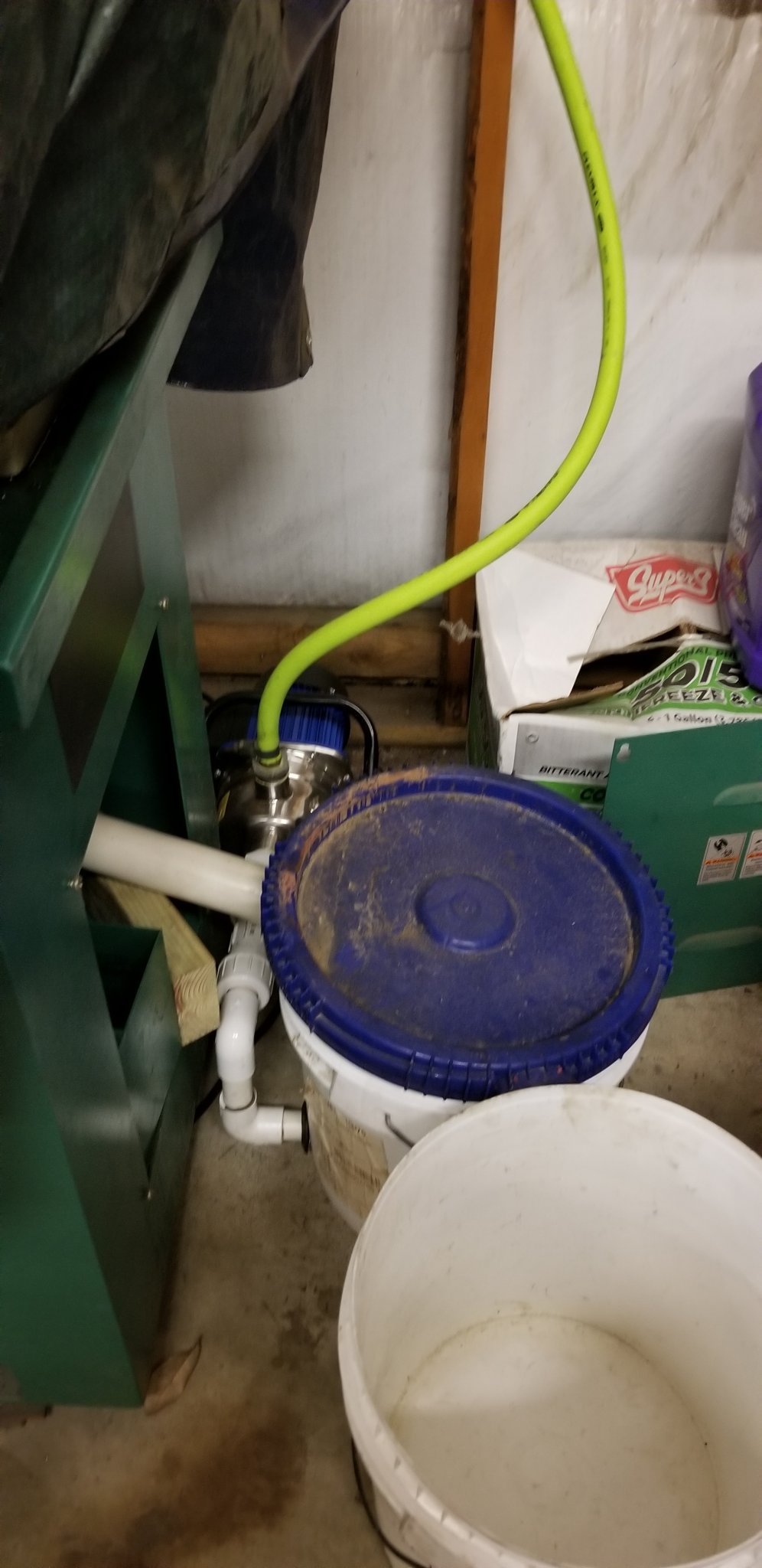

What pump and filter did you go with and where from
got both from amazon

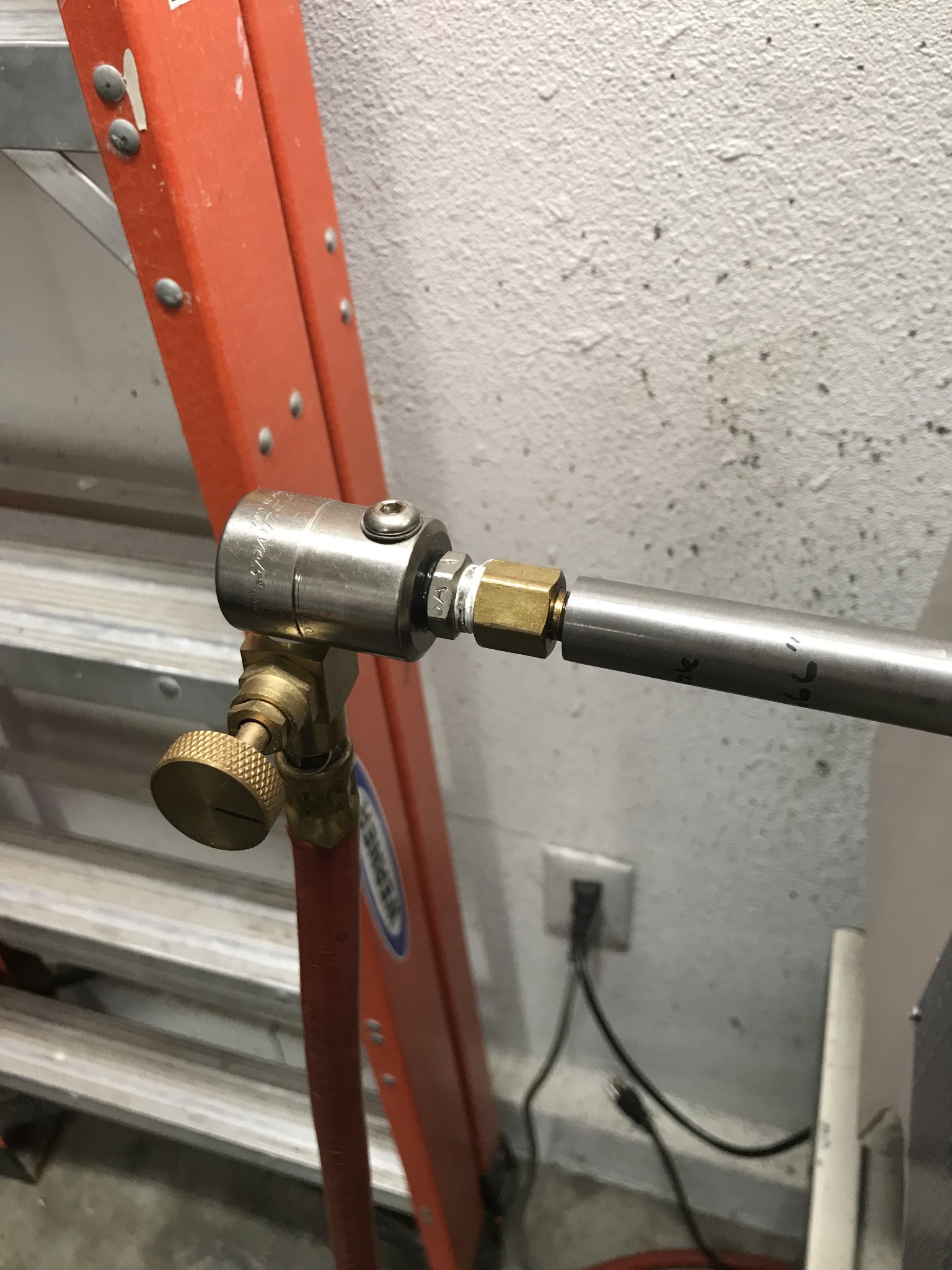

Ok i got my rotary union in and are they supposed to be this stiff to turn. Seems like it will put undue pressure on barrel. Just seems pretty tight to turn
What rotary union did you get? At first I ordered one that looked like it would work but it was really stiff so I then ordered a duebin like everyone else and it turns way better.
