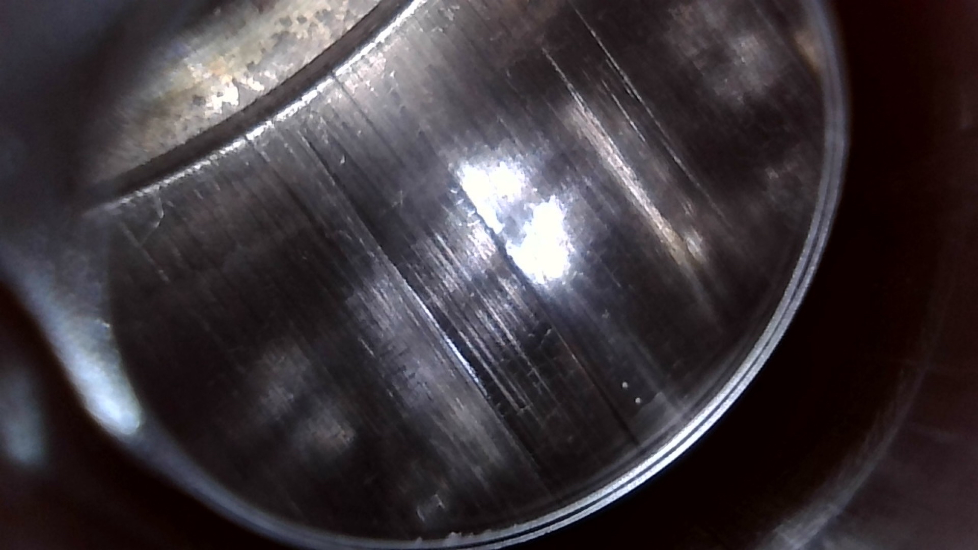

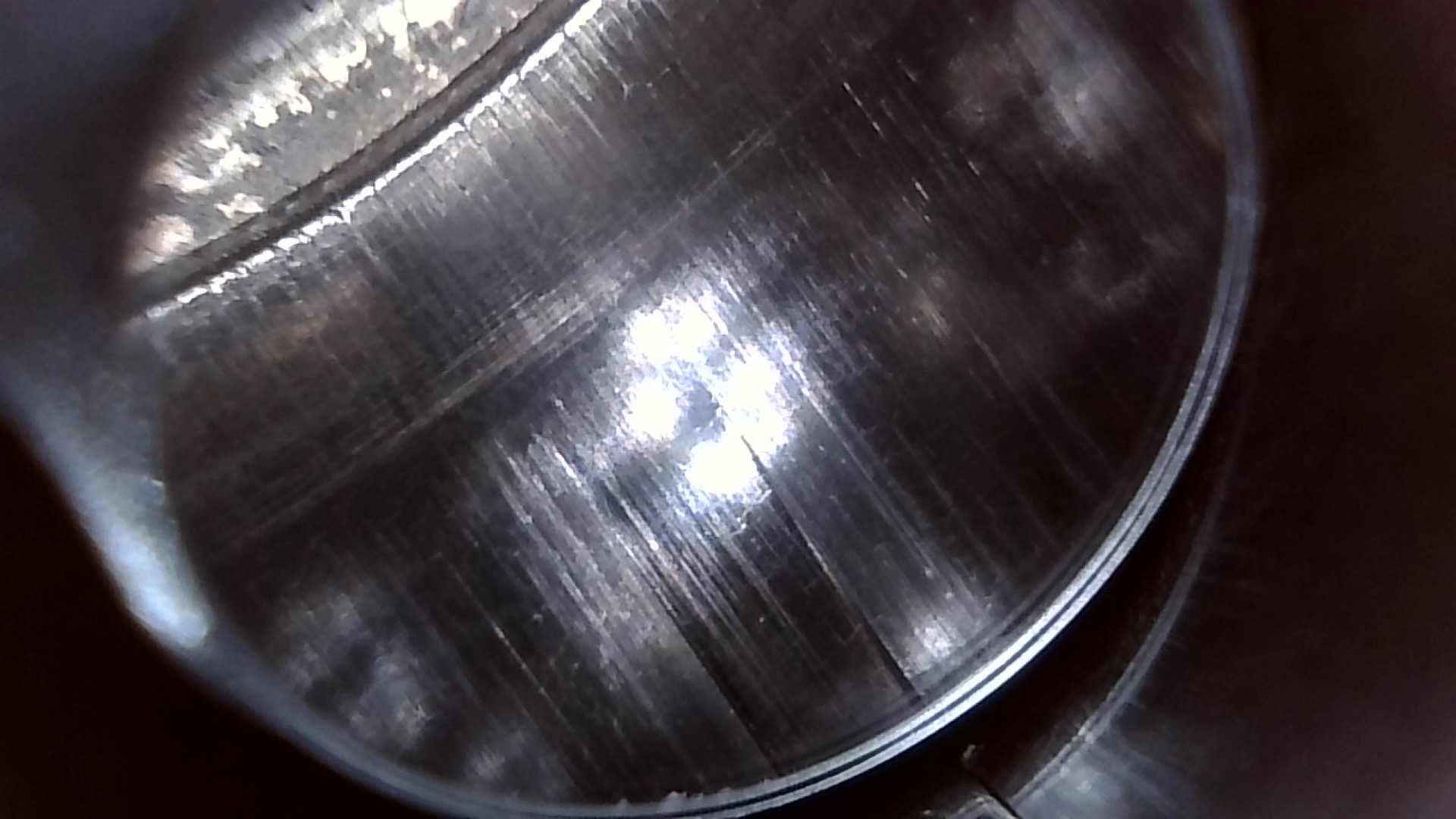

The seller said that it had at most 10-20 rounds through it. When I bore scoped the barrel there was no carbon fouling and only a little copper build up, and the throat still had reamer marks on the rifling. From this I believe the barrel was only test fired by CLE and not the original owner. What was disappointing though was the reamer was clearly not centered on the bore when the chamber was cut. I could clearly see the freebore section on the upper half of the chamber, the lower half still had the rifling extending all the way to the case mouth. This didn't look good at all but decided to break-in the barrel and start load development, you never know it may just shoot... Unfortunately, and as expected, the rifle has not produced consistent accuracy. I've got a couple loads which showed promise, shooting 1/2 MOA @ 100 with a single 5 shot group, but then opening up to 1.5 MOA on the next.

The target does not lie. Yank the barrel, take the loss, get a new barrel done correctly..
Or not -- and accept your downrange performance and results.
Cut-rifled Kriegers are generally much better than mass-produced "Consumer-grade" tubes.
I definitely am not accepting the results so far. The barrel on this gun now is a 10 twist Krieger, which is why the chambering job was so disappointing... If I keep this rifle it'll get another Krieger or a Bartlein, probably a little slower twist.
A gunsmith might be able to fix that with a finish reamer w/o screwing up headspace

Re-reaming the chamber centered on the bore will cause other issues IMO. It'll make the chamber at the shoulder, neck, etc oblong.
