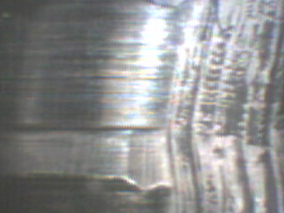

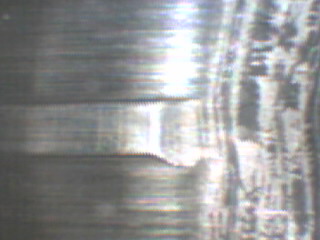

Just thought I'd see if some of the barrel experts have seen something like this before, and what might cause it. I'm new to the bore scope thing so I know things can look worse than they are, but I see two concerning things here compared to other barrels I've looked at, that may or may not be. The first is that it appears there are "ridges" or grooves (going from top to bottom) in the chamber as it approaches the lands. The second is that the start of the lands appear rotationally "Smooshed' also going from top to bottom. Where the top of the land is fairly sharp/clean and the bottom of the land has been "smooshed" downward. All of the lands display similar deformation.

Honestly not horribly, it replaced a factory barrel that shot pretty darn well, and it shoots about the same as that. I expected it to shoot better, and was always a bit disappointed in it, but figured it was just me or I had not found the right ammo etc. Recently I bought a borescope and was pretty surprised I saw the above compared to other factory/custom barrels I have. It's certainly not shooting shotgun patterns, I'm just more curious as to what would cause such "damage".
It almost looks like your chamber reamer was dull. I've looked at my barrels (Bartlein, Rock Creek, AI, White Oak) with a Lyman borescope and the throats on them look cleanly cut. Yours look like the beginning of the rifling was distorted by the chamber reamer and the transition from chamber to throat is not cut cleanly. Who chambered your barrel?
Reactions: MarinePMI
Wow, what a shit show! The leade angle looks really steep, and the wavy pattern in the freebore is weird too. I can’t imagine a reamer cutting that badly. I’d expect the wiped burr off the leade to have broken off during firing. Looks like everything went wrong there...
Did you buy this new? Was it a prefit, or a smith turned a blank for you? That’s just terrible looking.

I'm just curious in the cause, even reviewing lots of various pictures of types of chamber/rifling damage I didn't really see anything like it. I could see a dull reamer doing the "smooshing" of the lands, but what caused that wavy pattern in the freebore is what intrigues me the most. However I know next to nothing about chamber reaming so I figured I'd ask here we might have someone that has seen something similar.
Not good. I've seen worse a lot worse. CNC's are great for making parts but they can also produce a lot of substandard chambers if you're not careful. One solution is to go in with a throating reamer and clean it up or set the barrel back a bit and rechamber.

I absolutely HATE cleaning and am a big proponent of less is better when it comes to bores. My concern is with the lead preceding the actual throat. Like Supersubes mentioned, the "wavey" marks are peculiar A.F. I would imagine that those wave patterns are going to do an exceptional job of catching and accumulating carbon right where it can cause issues.
2nd concern would be with the trailing edge of that land. It is going to tear and form the bullet jacket in a manner that will impede the best seal for the rest of the trip down the track of that land/groove juncture. If that is actually a thing, you could expect some very uneven throat erosion biased toward that side.
You didn't mention caliber but smaller bores like .224 and 6mm'ish will be more prone to all concerns above.

What does the rest of the chamber look like? This reamer was doing a really bad job of cutting, and I’d guess things are probably undersized because of that. Not surprising it doesn’t extract well, or fouls up. 22’s are low pressure so the case might not show much, but what does the fired brass look like? Now that we know it’s a 22lr, I’m even more shocked it came out so ugly. So little material gets removed in a 22lr chamber job.
I wouldn’t stand for that kind of work for a second, and I’d get pretty assertive about a replacement or a refund. If I sold a job like that to somebody, I’d be fucking embarrassed!

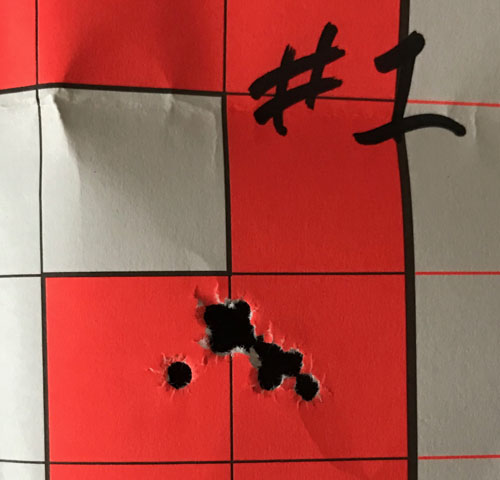

They returned it with a test target with five 10 shot groups, and it's very hard to argue with the results. They used a machine rest just for the barrel and it must be indoors because it noted that it was climate controlled. At 50 yards all of them are under 1" outside to outside with Eley Match black box (groups below, squares are 1"). On average I'd say center to center all 5 groups are around 5/8-3/4" and they did state it performed about "average" of their barrels tested. Though one has to wonder how good it would shoot without the chamber damage.
I have mixed feelings about it. I'm surprised they had no idea as to what could have caused the damage, and they didn't really want to discuss it. I just figured that a shop that chambered thousands of barrels, and no doubt removed/inspected tons of factory barrels would have an very good idea about what causes pretty much any type of chamber/rifling damage over the years.
At the end of the day, it shoots way better than I ever could, but certainly something went very wrong in the chambering process, and you have to wonder how well it might shoot if it didn't have the chamber damage. There's also the points others have brought up about long term issues such as uneven throat erosion, faster accuracy fall off between cleanings, faster chamber fowling causing cycling issues etc. At this point I'll likely just shoot it and make sure I clean it more frequently than I normally would a .22 barrel. While I was not overly impressed with the issues trying to contact them, get responses, return packaging, etc. I was not treated with disrespect, no one was rude to me etc. I doubt I'd purchase from them again, but I also won't go out of my way to bad mouth them either.
