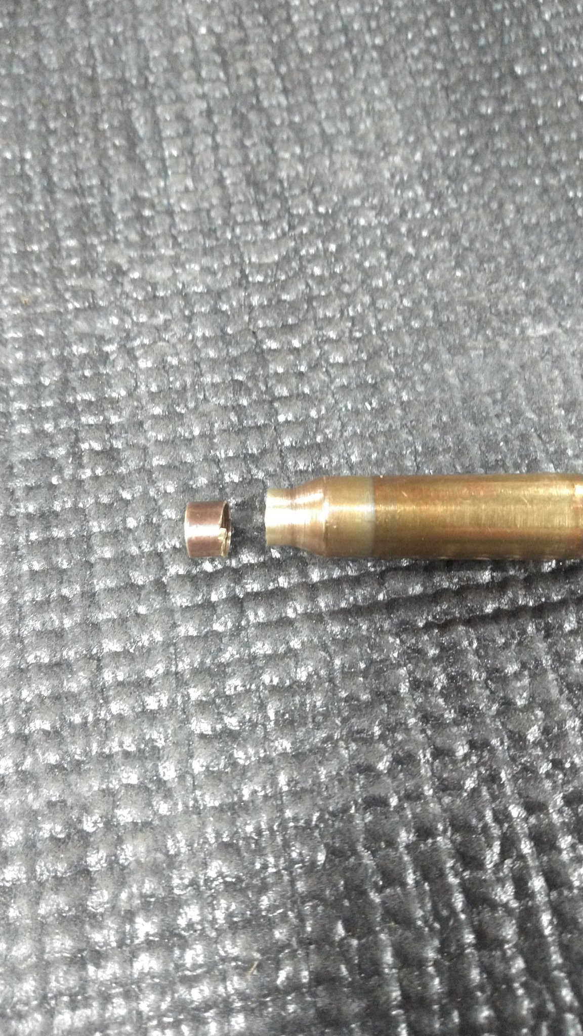

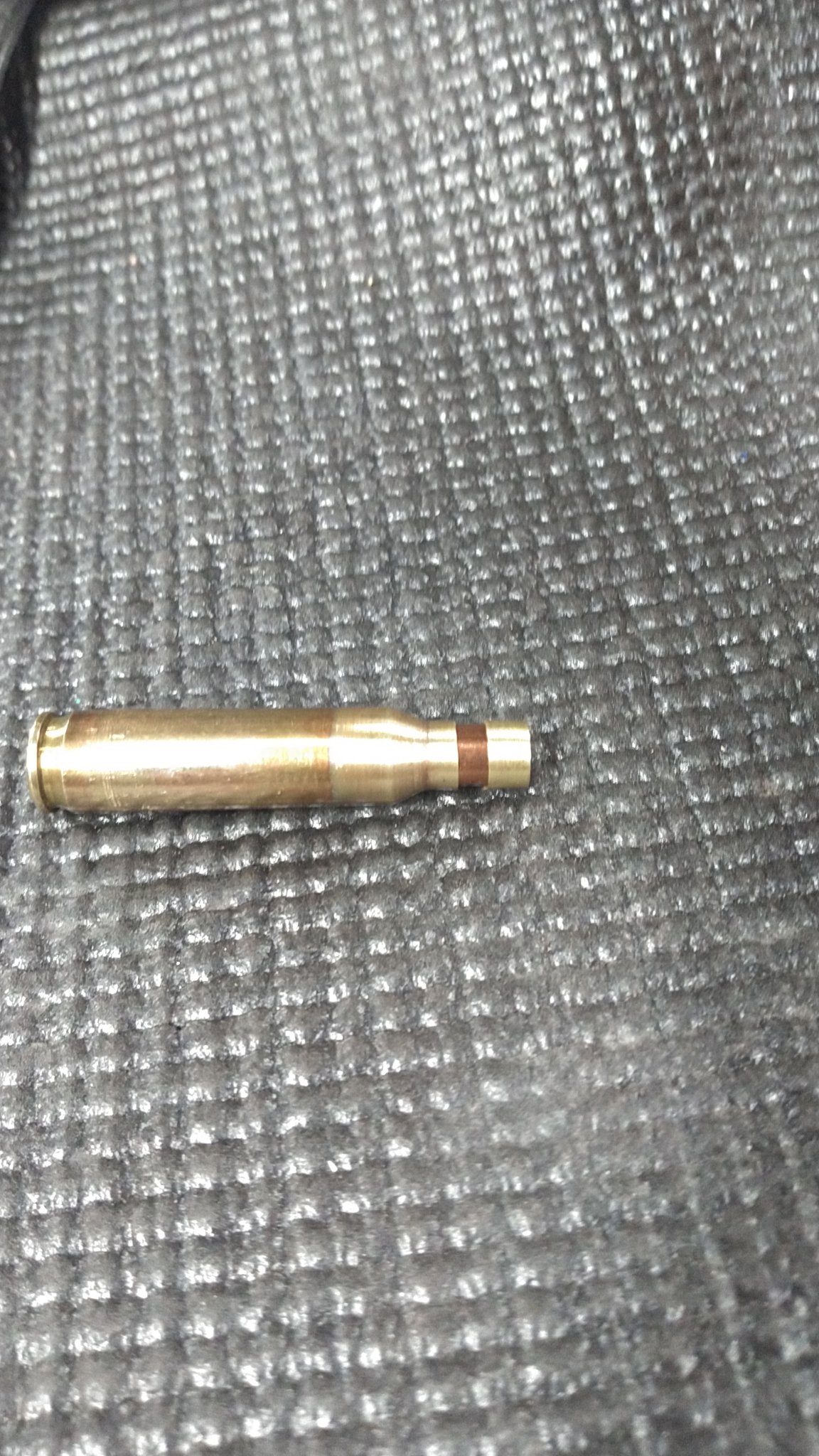

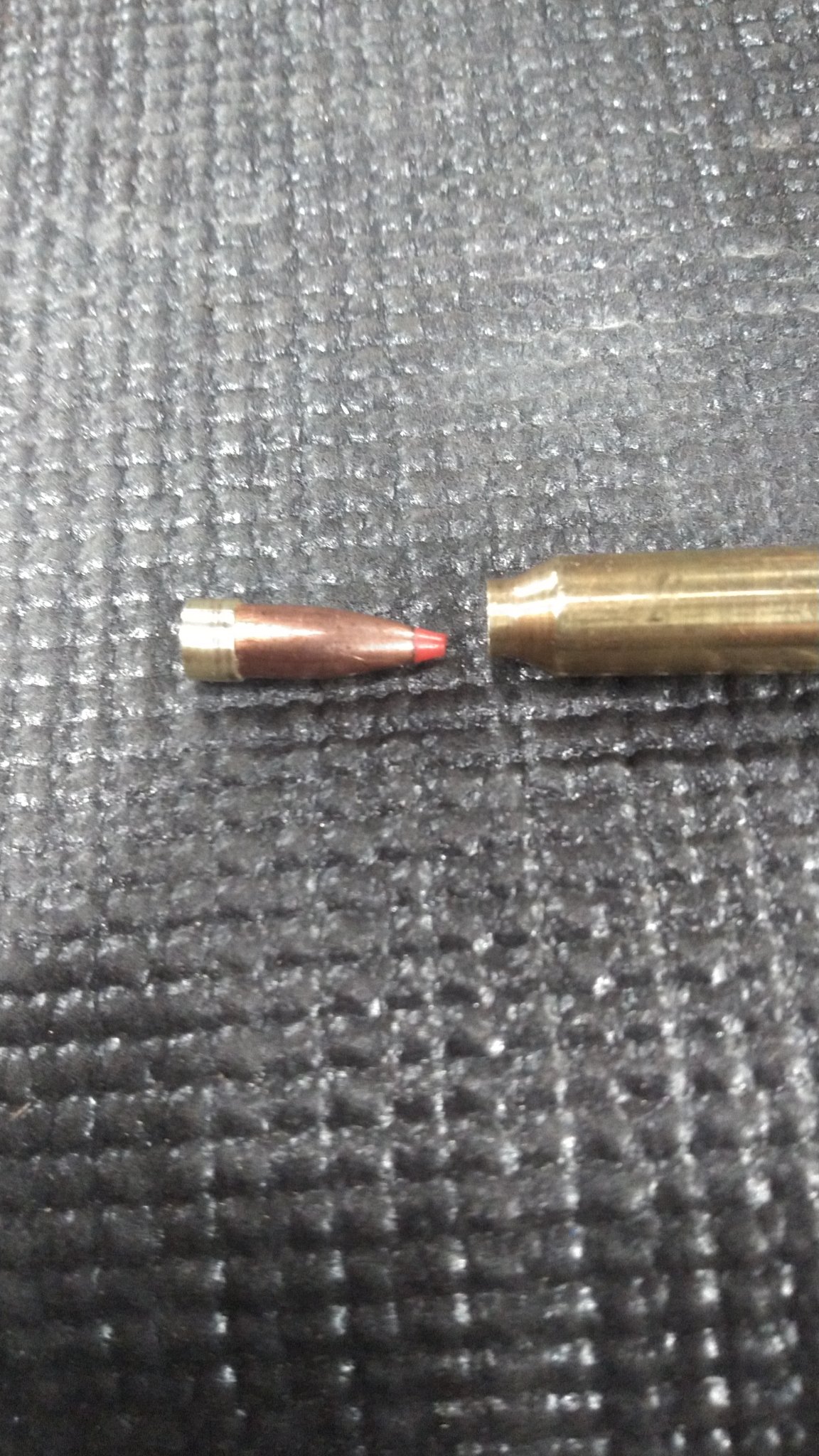

    Pull bolt and slip case rim under the extractor and reinstall, once you close the bolt it will set the max case length, remove case and measure.
    I also drilled the primer out to 3/16 so I could slip a punch in there to tap the bullet back out a little for reuse.
    Holy shit, that's genius. Thank you so much!
