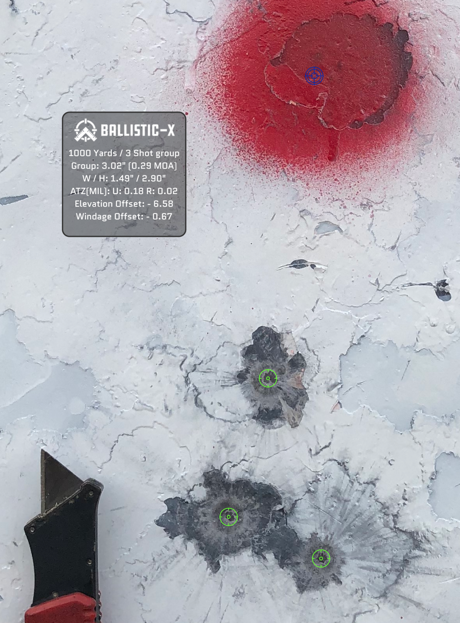

Don’t sweat it unless you see a problem. I jump mag length 215 BHs .07” (300WM) and they shoot half MOA or better to 1250y if I don’t fuck up the execution. Gives you an opportunity to figure out a heavy load too, for single loading if you want to try F TR with a heavier bullet.
