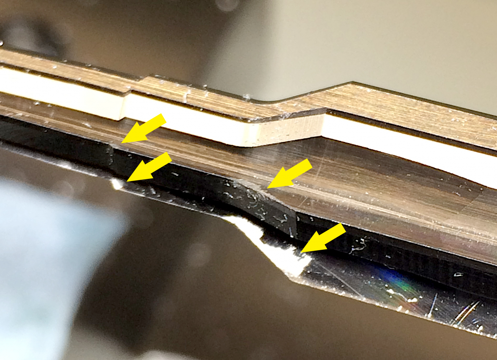

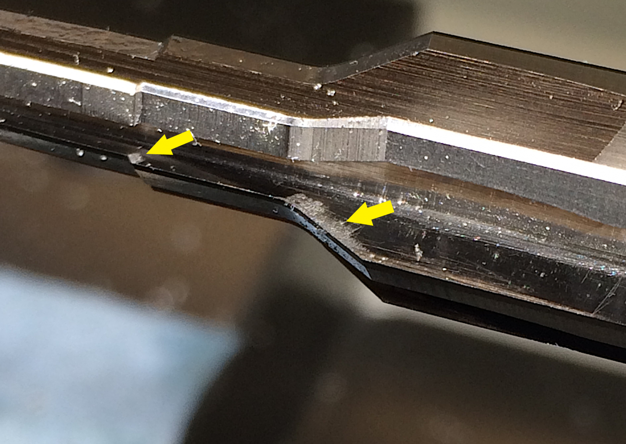

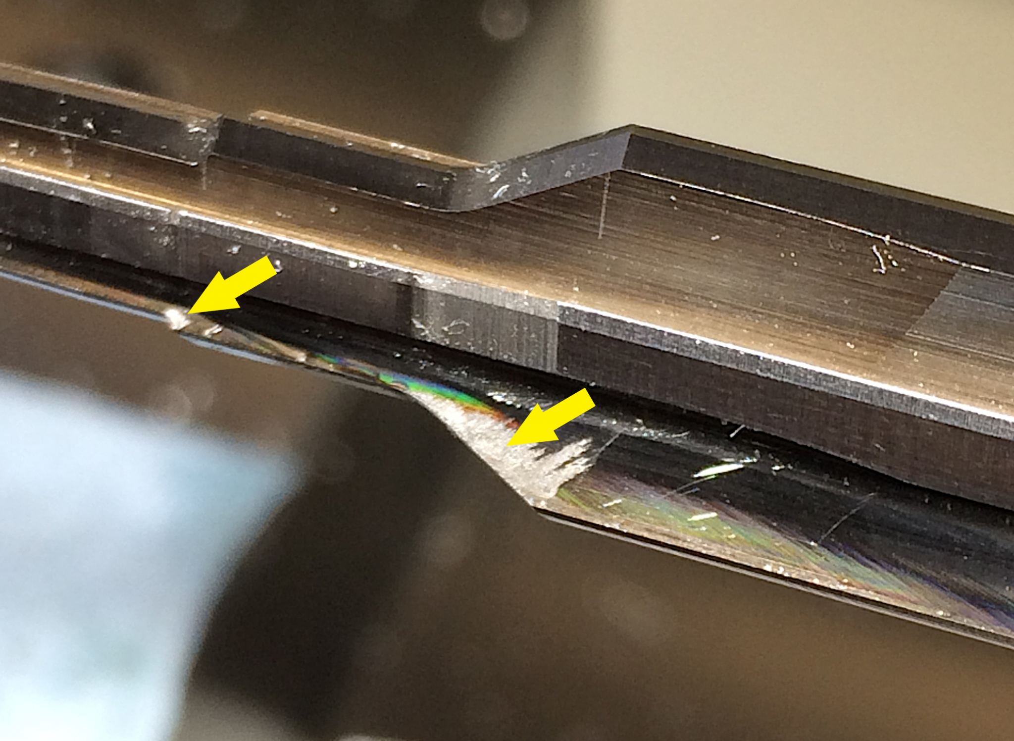

I'm looking for some opinions regarding the wear showing on a PTG 6 Creedmoor finishing reamer.
The PTG reamer has 6 flutes, each flute has two facets (primary and secondary relief angles). The wear is visible on the cutting edge at the case mouth and shoulder sections (shown with yellow arrows in photos) below the junction of the primary relief angle and the cutting edge. The reamer has cut 2 chambers, using low rpm (90), high sulfur cutting oil (generously applied), fed into the bore about 0.050" per pass (reamer and chamber cleared of chips each pass), mounted on a floating reamer holder. On all my chamberings I've gone slowly, following mainstream processes.
Is this wear typical? Is it some type of build up residue from SS barrel? The reamer was purchased new - I didn't notice anything unusual, but wasn't specifically looking at these areas. The surface finish of the chamber walls are perfect, but the shoulder has fine striations corresponding to the wear areas. Photos are of the same reamer, rotated to show different flutes. I wanted to get some feedback before trying to stone it or otherwise restore.

Looks like material build-up more than wear. 🤷‍♂️ Those areas are subject to the most direct cutting action and pressures. Wear would be on the very edge and reducing the diameter of your reamer.

@smoooth1 I ran a fine point brass pick over the area and think you may be correct. It feels like very slight deposit. Under magnification the primary cutting angle looks clean. Might try a fine oil stone slip - carefully run it along that side of the flute.

That’s build up. As for pre boring and or roughing reamer prior to finish reaming, don’t believe everything you read or hear, learn from experience. Unless you are cutting hundreds of chambers your finish reamer is all you need. I’ve cut many chambers with nothing but finish reamers and have yet to wear one out or need it sharpened. Good cutting oil, the correct speed and feed, and watch heat build up. If the barrel and or the reamer is getting hot to where you can’t touch it stop and let it cool. This will also help to lesson build up.

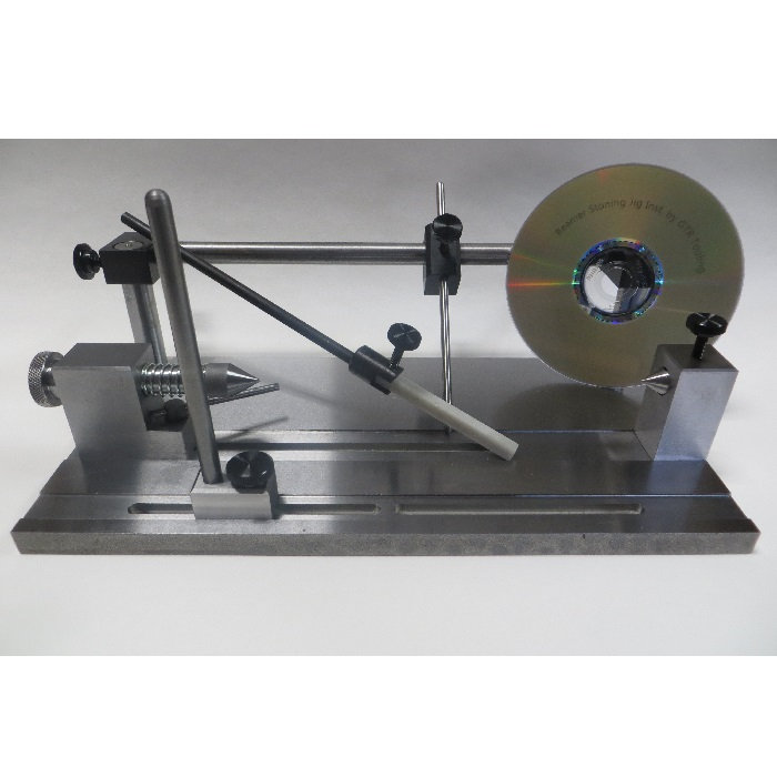

First off, Dave kiff cant put a good edge on a reamer edge if his life depended on it. And, his heat treat is all over the map
Prebore in steps to reduce reamer
work.
Should not take more than .3 or
4 of forward travel to finish.
And,
God gave us
Arkansas, ruby and diamond hones and stones for a reason
Learn how to use them.
Use a good forced oil flow from the front end.
Reamers vary in life cycle
Some better than others.
Hugh hendricks still makes the best imo.
If you can wait for him.
If you are doing production, go carbide.

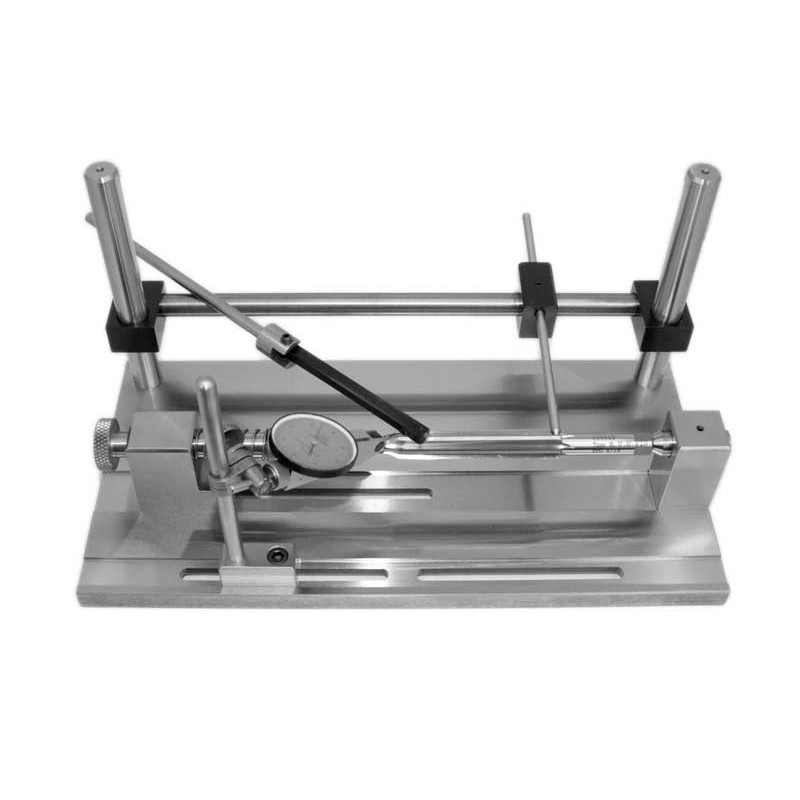

That's a broad statement. But I do have a jig set up to fix the fixable. If I specificlally order 'up sharp'after coat, chances are better.
