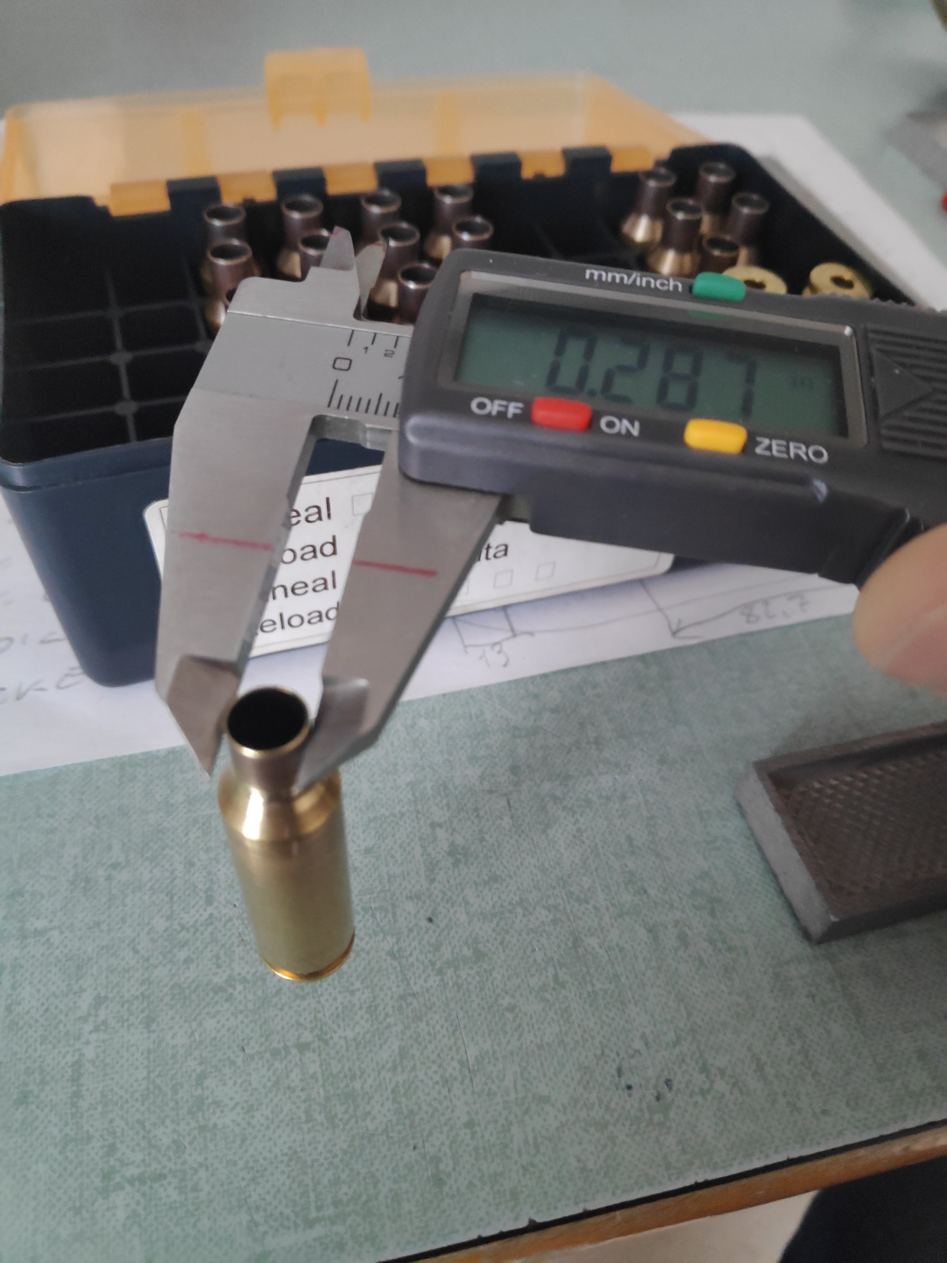

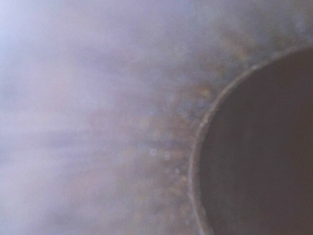

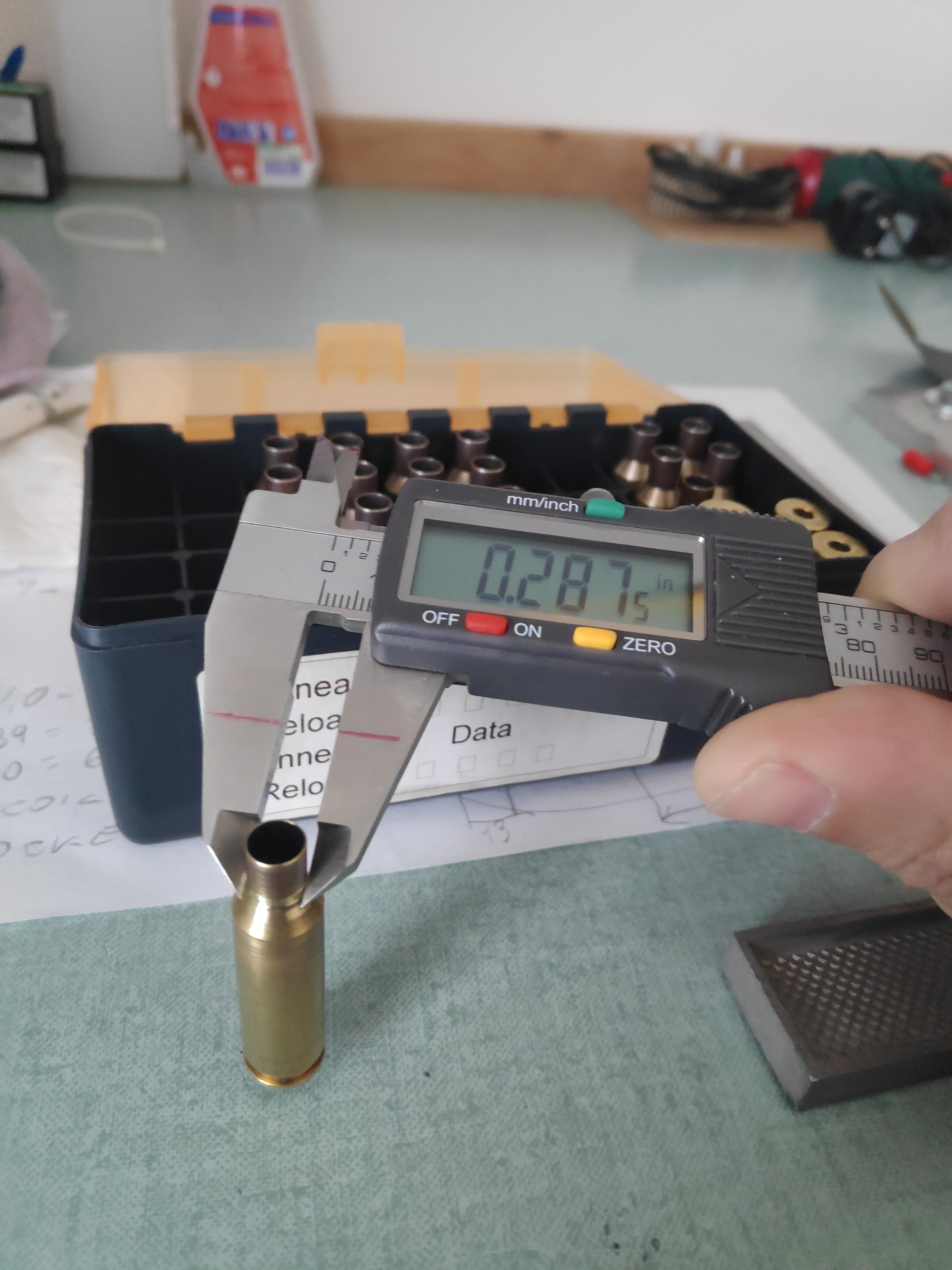

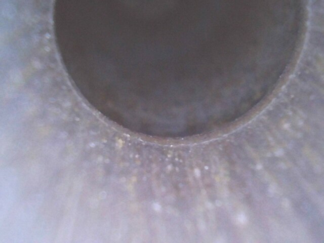

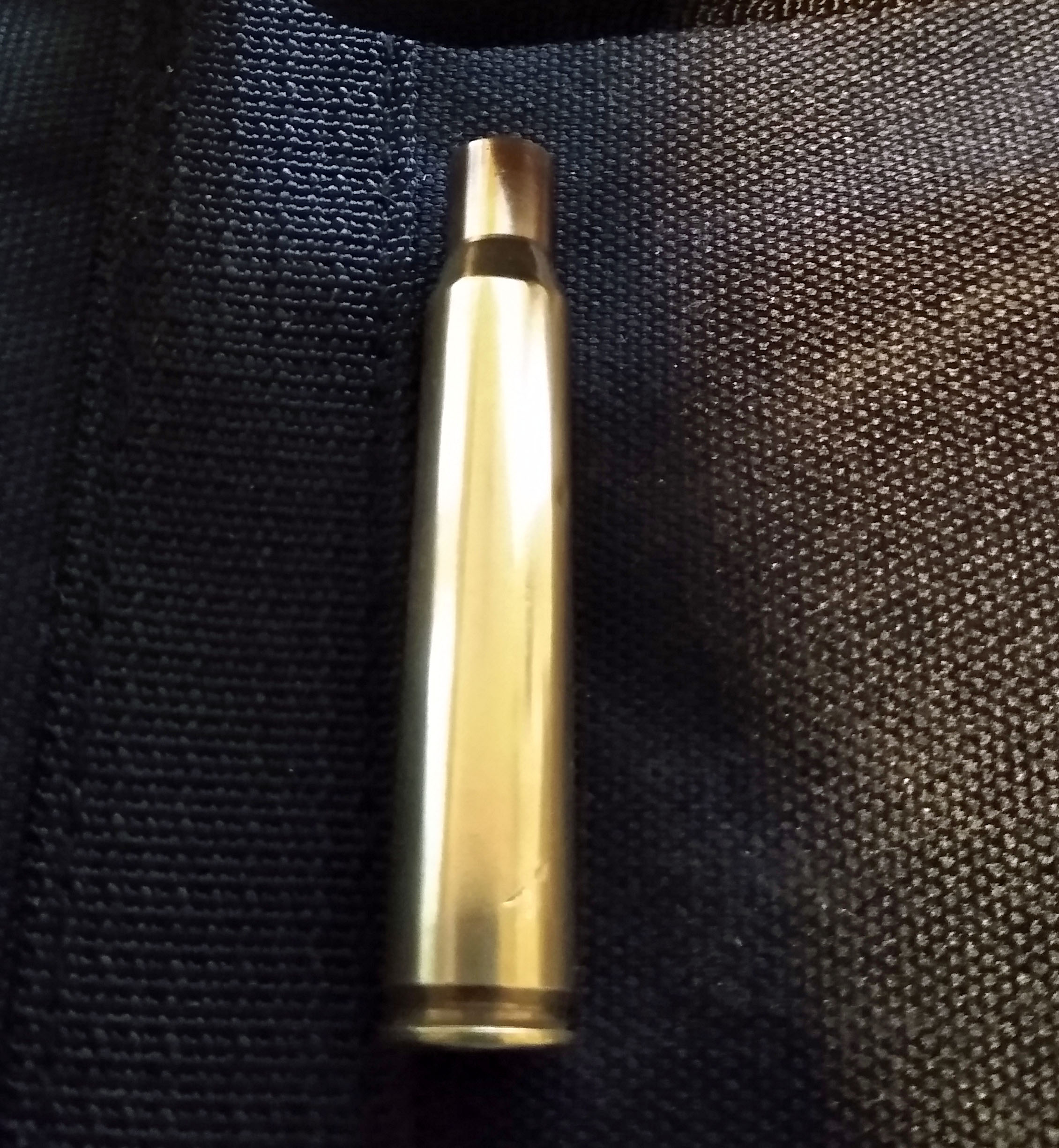

Some pics:
0.030” increase is huge, that’s your issue.
It looks like the mandrel die might also flaring your brass neck 0.001”…
Which leads me to believe the mandrel die is seated too far into the press. If so, this may also be partially collapsing the neck, creating the 0.030” bulge.
Are you getting a hard stop on the press ram before it can fully raise?
Hi only 0.0025"
I've one 21st century mandrel die with Windows, the case do not break the upper of the die.
Some pics:
That looks like a donut to me, but it's pretty difficult to tell from those photos. Milling the case in half or cleaning the case down to bare brass would make it easier to see. You can also take something like a paper clip and slide it inside the neck to see if it hangs up or snags, right before the shoulder rather than just sliding past.
In my opinion, the best solution is to buy new brass. How many pieces do you have?
About 90pcs
But find some cases of this caliber are too difficult now.
But I can turn, I've a basic neck turning stuff.
Turning only for remove the donut are possible with a 30º cutter?
I can't really answer that. Turning just the outside will still leave a bump or ridge on the inside, even if you trim after you've mandrel through it, due to spring back. I would think you need to turn the outside & inside of the neck to completely remove the bump.

Hello everyone,
at this point we need to put some order on the methodologies and equipment, but also on the points of view. assuming that the maximum headspace is 1.4710" .
I would proceed as follows: I anneal the cases with induction, in this way, if I have to anneal an original lapua case, I insert it at a certain height in the coil and let it cook for 4.2sec.
But in this case, where I have to anneal the shoulder/neck joint better, I inserted the case further into the coil but always for the same annealing time. I resized the case with FL die with bushing (.286") to 1.4690" of headspace.
The bolt closes by gravity by itself.
I then widened the neck and the shoulder/neck joint with the mandrel to 0.2625" maintaining headspace at 1.4690" but the bolt does not close by gravity but must be forced slightly.
I consequently annealed again with a 0.2630" mandrel and turned the neck until reaching graze the shoulder with a thickness of about 0.013".
At this point the bolt closes better, not only by gravity but it goes much better.
But I have a doubt... should I continue with this solution maintaining 1.4690" of headspace or should I follow the advice of Wheeler's video and bring headspace to 1.4690"-0.002"? so - 4 thou from 1.4710" of the fired case? In the meantime I'm looking for a way to get a Forster FL no bushing Honed die to .286" here in Italy.
Am I making the right choice or can I safely stay with the Forster FL Bushing die?
Last test are chambering with the bullet seated...

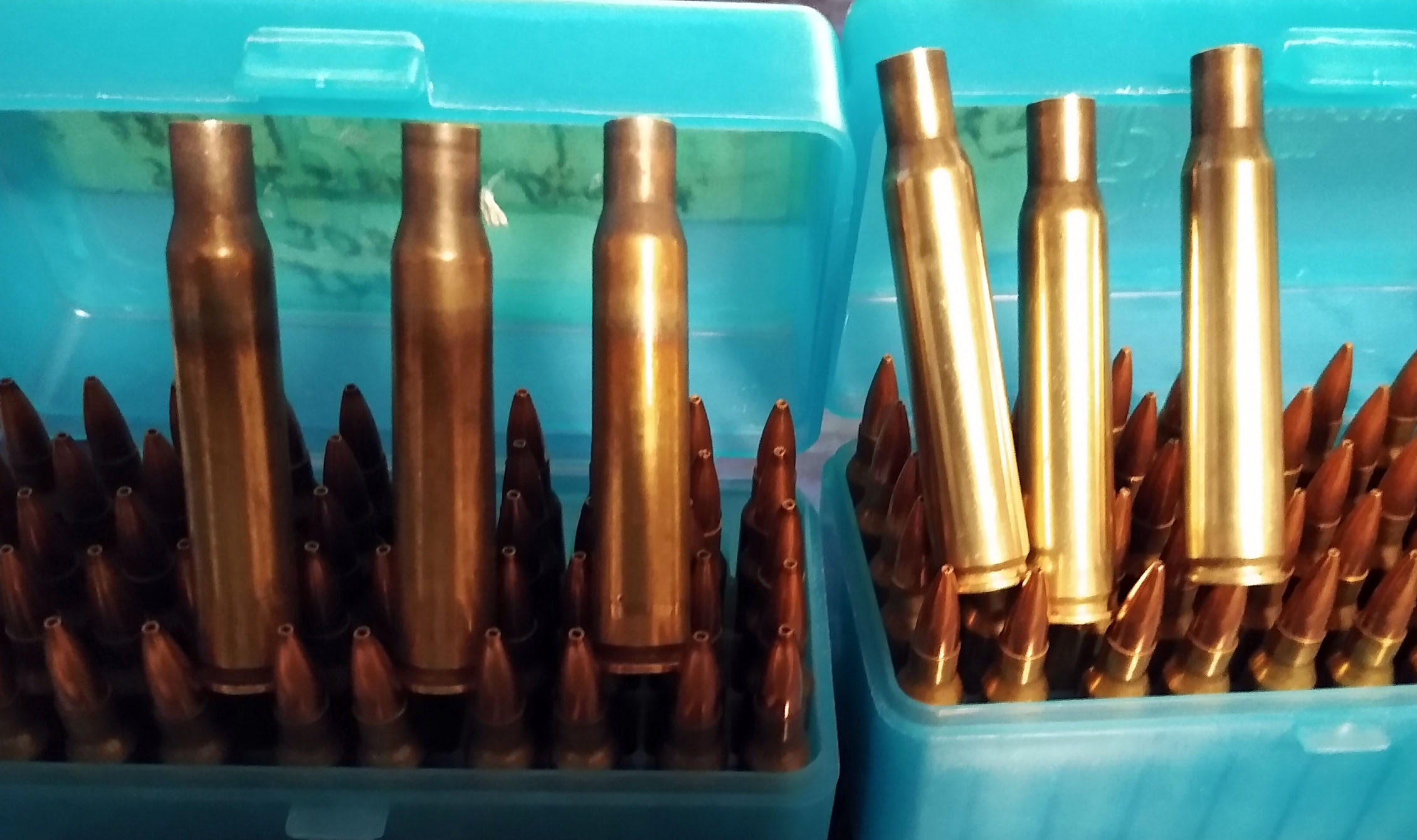

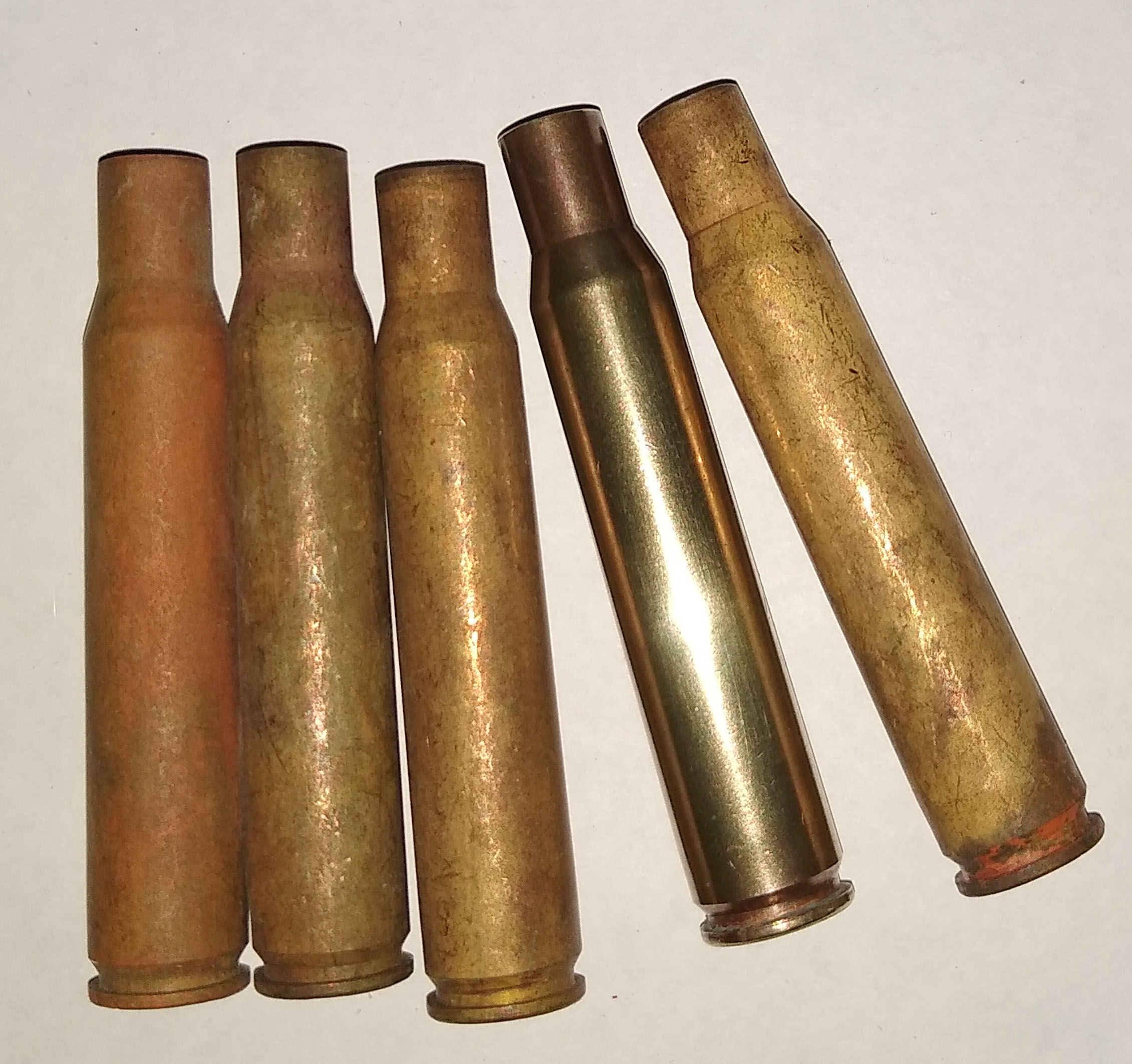

FL sizing is the way too go and I'm still against partial annealing after every firing . I've proven to myself #3 firings and partial annealing extends case life ,without sacrificing accuracy or over working brass . After De-capping , ultrasonically cleaning, partial annealing, sizing ,measuring to uniform OAL 1942-43 LC & SL M2 .30 Cal. once fired cases . I loaded within 1.0 grain of maximum charge for M1 Garand and repeated it #50 times without a single lost case ,split neck , torn rim or lose primer pocket . I did eventually cut two cases ,so as to accurately measure wall thickness for potential case head separation . Happy to report those cases could go another 10-? reloads .
Garand extractors aren't easy on case rims , I've lost a few commercial cases due too torn rim but not a single Military case !.
An the cases I started with WERE UGLY !.
