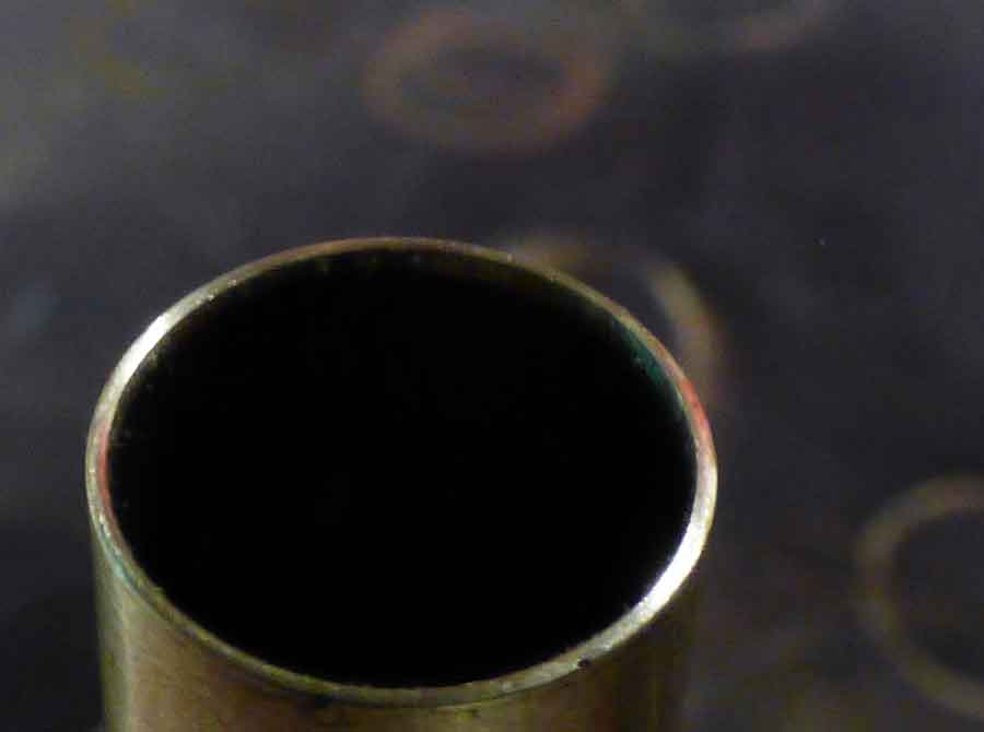

I don't know if it's brass flow or what but inspecting fired cases doesn't show much if any inside chamfer left. I also touch the mouth of each case against some 400 or 600 Al2O3 paper held in my palm. Slow, PITA but I think touching the mouth helps to eliminate crack initiation at the mouth and aids inspection. Done lightly it doesn't remove much brass.
I then snap a close up of each case and examine them on the computer.
Not really :)
I tried to get some pictures, but all my fired cases still have the chamfer intact. Its hard to see because its not shiny. I just went over some 223s I shot this morning and some re-sized .308, 6.5 creed, and 300wm brass.
