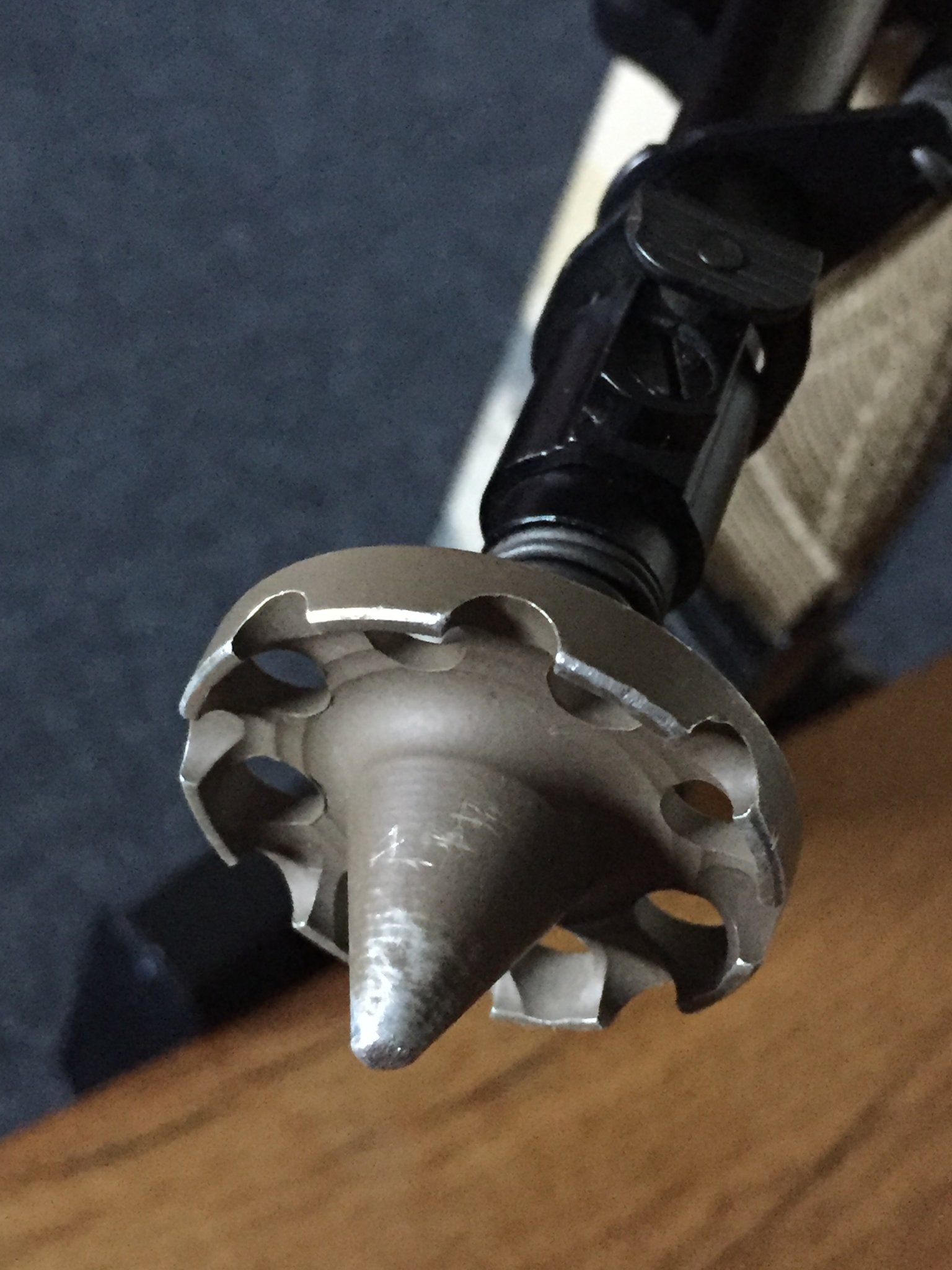

I like the tac supply talons as well. They just look better. On extended periods of use on rough concrete the aluminum will wear and round over more than the stainless probably, but I dont mind, they still are pointy enough to grab onto anything.
yes those look good I was wondering about the wear also thanks
Ill try to get a pick of them this weekend after a couple years use.
Really its just since I made myself a super abrasive concrete shooting bench that theyve worn down, theyve gouged the concrete pretty good in equal turn though making some nice ruts in it. For the bench texture thing of a grinding wheel or grip tape, its going to sand down anything.
When I was just shooting off of a wood bench or dirt or small rocks up until 6 months ago it was no issue, they stayed sharp. Now they are rubbing down but the concrete bench is just a beater.
I am half tempted to see how well hawk hills wold hold up but I dont want to drop the money on more cleats just to move a current set to storage in their place. Ill let a cousin or friend get them.
