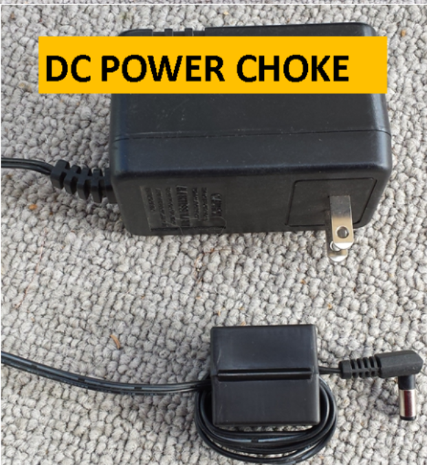

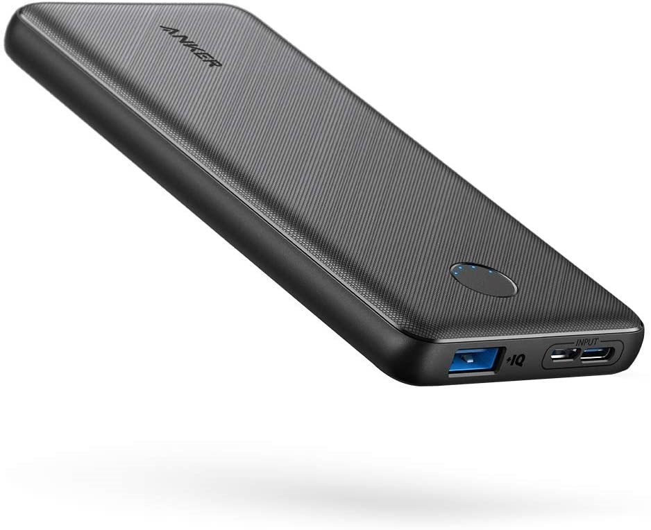

    I went to powering my CM with DC only and having no other electrical devices near by (e.g. cell phone, computer, no florescent lighting and not AC or heating going on to move the air). Doing this pretty much solved my drifting issues.
    The power pack I use is like this (a different brand):
    How does this hook up and what is the output of this power-pack? Thx
    "The one I use has an output of DC 5V at 2.4A and has a battery capacity of 10,000 Milliamp Hours." (edit correction for misinformation) The one I use for my CM has an output of DC12V at 3V having a battery capacity of 6,000 mAh. The other I use it on trips to charge my phones, a backup for my laptop, powers my rifle barrel cooler, etc., etc. When I'm using it for my CM, it hardly drains much power when charging 50-100 cases as I typically do.
    For output, you plug in a USB cable into the power unit with whatever male end needed, like for the ChargeMaster it's a 5.5 x 2.1mm adapter.
    The one I use has an output of DC 5V at 2.4A and has a battery capacity of 10,000 Milliamp Hours. I use it on trips to charge my phones, a backup for my laptop, powers my rifle barrel cooler, powers my ChargeMaster 1500, etc., etc. When I'm using it for my CM, it hardly drains much power when charging 50-100 cases as I typically do.
    Thanks man! So if I understand correctly, the Chargemaster will run on 5v at 2.4A? And this is a more stabile power source than the wall adapter?
    Along with what's mentioned above about interference from cell phones, florescent lights, etc. Static is another thing that will cause scales to drift. Get rid of those plastic reloading trays, plastic funnels, or anything else that's plastic on the reloading bench. Once you do that, you'll see a big improvement with stability. The black plastic powder bottles and jugs are Ok, as they are a special plastic that's made to eliminate static.
    Also, don't wear polyester or synthetic blend clothing when reloading, as that induces static. 100% Cotton is the way to go.
