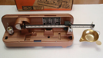

Using a Lyman M5 with a Dandy Auto tickler. Nearly as fast and more precise.

I had a keypad failure on a chargemaster years ago. Called RCBS and they wanted nearly as much to fix it as to buy a new one. It went in the trash and I haven’t bought one to replace it.
John
Lyman M5? Just looked on Lyman site, can’t find it. Do you have a link? TY
HA! Doesnt surprise me, try a catalog from the 60s lol
But the dandy trickler works with all beam scales the same
