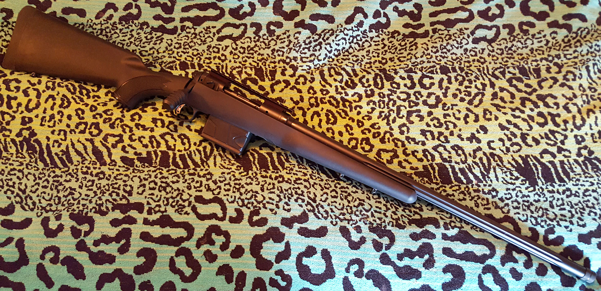

My Savage 10 FCP-SR "FrankenGun"...
started like this:
Shot ragged holes from day one and is presently a consistent .75 MOA shooter -
I suspect shit ammunition or some issue with the shooter. Apologies. Mine is 3 years old - I think I got the last Model 10 FCP-SR in 6.5 Creedmoor 'cause I looked all over the Internet to find it. Haven't seen one since but would buy it NIB if I did.
