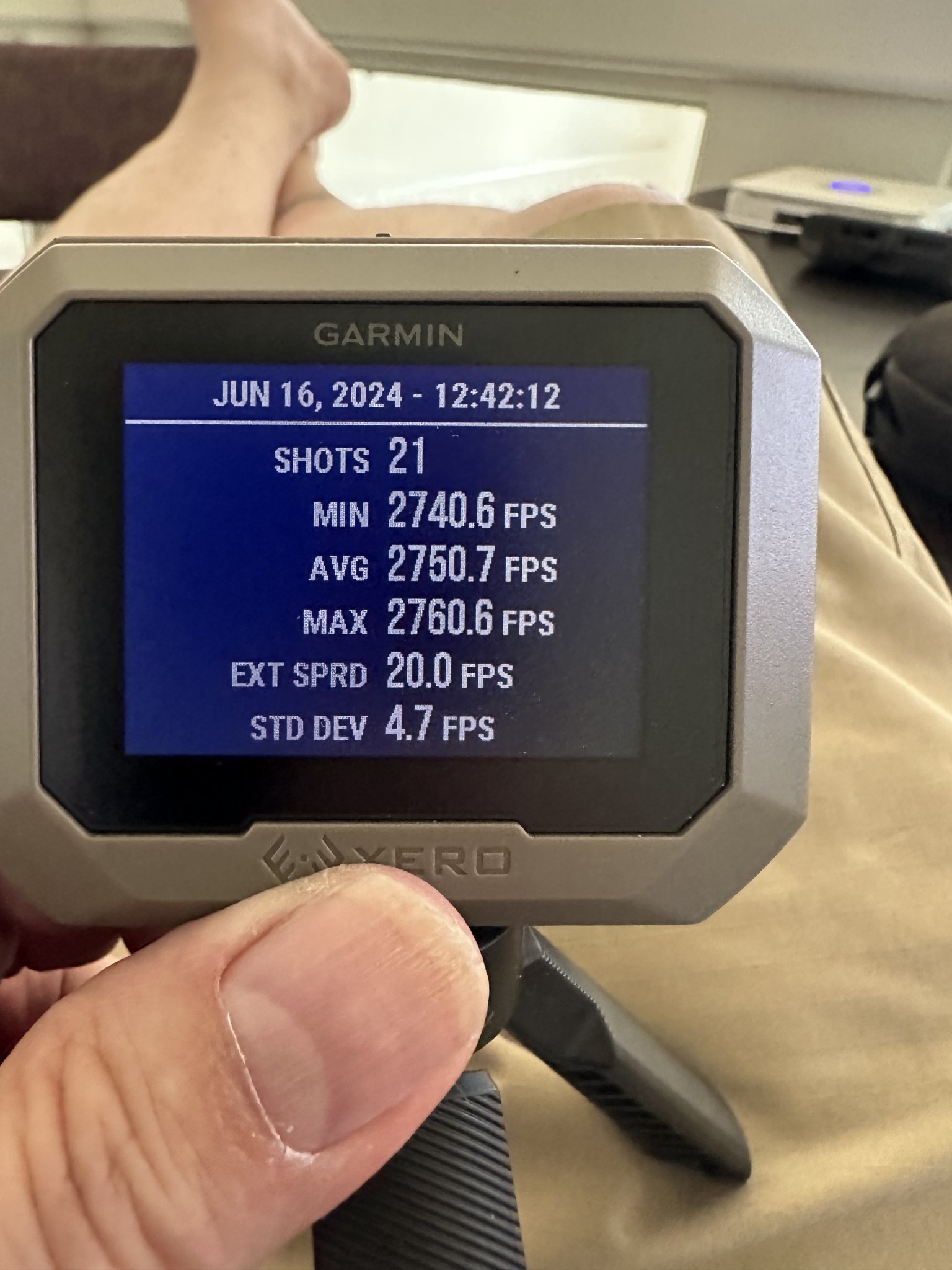

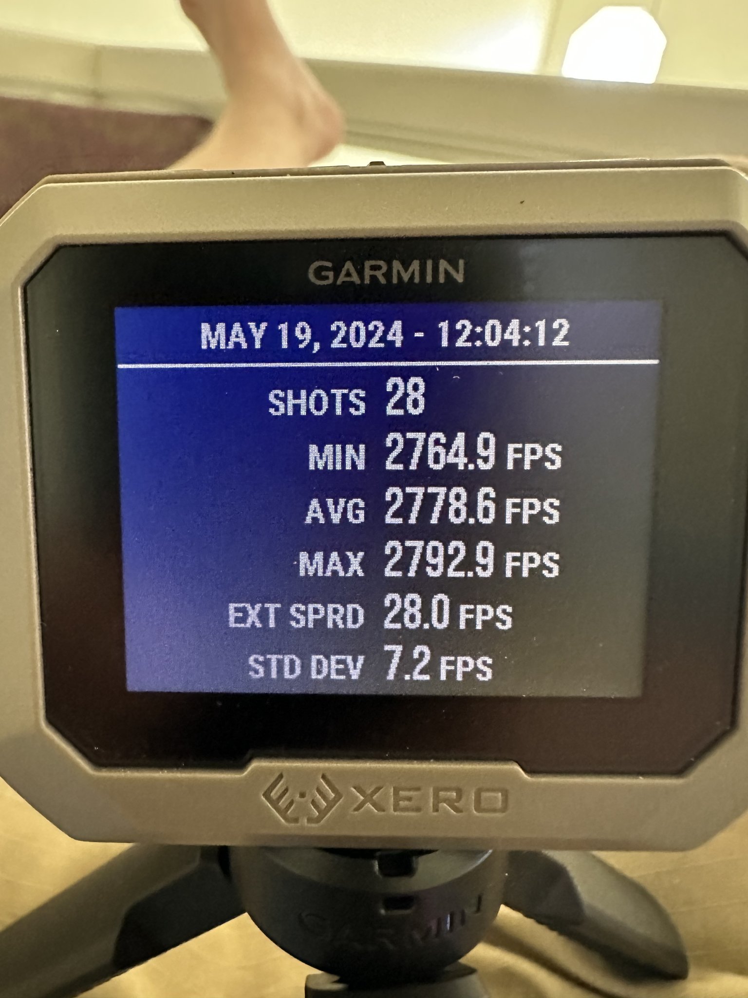

So my 6.5CM has about 1800 rounds through it and the velocity has been decreasing lately. Same brass/primer/powder.
With the Hornady 140 ELDM the CBTO was 2.258 and I was seating .020 off, or 2.238. It’s been a very accurate load. Today I measured and the CBTO was 2.293 or .035 difference (erosion). I’m going to load some rounds and reseat to .020 off and probably add a couple 10ths to get the velocity back.
Question: is .035 a lot or a little?
Also, does seating depth or jump affect velocity? From what I read so say yes some say no.
Also, does seating depth or jump affect velocity? From what I read so say yes some say no. View attachment 8440449View attachment 8440460

The difference in velocity is causing all my calculations to be off past 1000. I forget if it was 1100 or 1250 today but I had to dial up another .7 mil which I've never had to do. I know the barrel is getting worn which is fine.

What I’m seeing is velocity creeping up as the cases get harder and then falling back to normal after annealing once. If I anneal every cycle the velocity gradually creeps downward and then goes back up when I reload them without annealing a few times.
Certainly it won’t hurt to try. Or load in a 1x factory case to see.
I saw that video before. But what he’s saying doesn’t jive with what I’m seeing and feeling when I’m sizing and expanding the case neck and what the chrono says.
I'm not disputing what you've observed. But since I've not experienced that phenomenon as I anneal after every firing and metallurgists agree that repeated annealing of brass to the same temp and time does not make the brass softer, I don't have an explanation, though it seems to me something else must going on other than the necks getting softer with each annealing.
I agree. . .
It doesn't hurt to look at and try different things to see what's going on. :giggle:
Reactions: Mike Tackleberry
This makes sense. Think about what's happening. The case is hardening, so it springs back more. More spring-back = more effective neck tension. More effective neck tension = higher pressure. Higher pressure = more velocity.
Annealing every cycle won't cause the velocity to continue to go down. You can't over-anneal by annealing properly multiple times - as long as you let the case cool, that is. And yes, I've accidentally annealed the same case twice in a row and over-annealed, but it was because it was hot and I immediately did it again, causing the temperature to go above the target.
Without knowing everything that's going on in your process, it's hard to conjecture as to what's causing what you're seeing.
In the end, it all comes down to the pressure profile, which is driven by burn rate and the forces trying to keep the bullet in place (bullet weight, effective neck tension, seating depth, chamber conditions that might impact such).
I forget, how are you annealing?
Reactions: kthomas
AMP using the Aztec code for the lot.
I use a Lee collet neck die and can feel the neck is getting progressively softer with each cycle. So I don’t buy what he’s saying.
