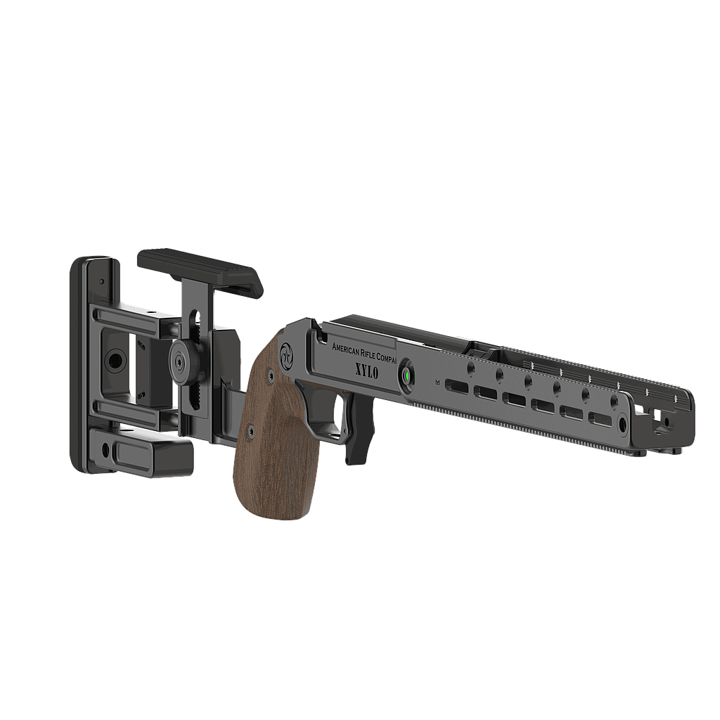

I'll go xylo.
- don't want to dremel anything to accomodate the trigger hanger;
- I want the thing run AW mags out of the box ( at least I have both mag latches just in case: Ted said the AW works with the standard, anyway)
- I don't want to go above 20# for this build. It will be a PRS rig, but 18-19 pounds are plenty for a Dasher build.
- willing to give Xylo a try since was introduced in 2019 as far as I remember
- I like the short HG, will use the arca extension when needed
- eager to build my "own" wooden grip, looking for some exotic briar wood for that...

I'll go xylo.

In the video Ted mentions that there are some Xylo fitment issues with AICS mags, not the AW mags.
My understanding is that the Xylo come standard with the shorter mag latch and then you can buy separately the longer to run AW mags. He has a Xylo with that longer mag latch installed in the video.
Reactions: Ichi
I thought he stated in one of these videos that it was the standard latch in the chassis. This would mean that you would need a shorter latch to use AICS with this action.
Post 1371 in the CDG "mothership" thread.
Mag Latches
The chassis in the video has the standard latch in it. Although I cannot speak to other chassis, I am guessing that their standard latches will work fine with the AW mags and will need to be adjusted or shortened by 0.065" for the AICS mags.
Ted
Downside I see is you can't run both mags of the mag catch needs to be changed as I have a pile of ai mags. But no aw mags yet. But that's a problem for 8-12 weeks from now
Really would prefer to use this if/when available.
Xlr envy pro or ai atx. The xlr has an adjustable mag latch, the atx comes with a metal tang installed to keep aics mags low. Remove that and the aw will ride high like its intended.
