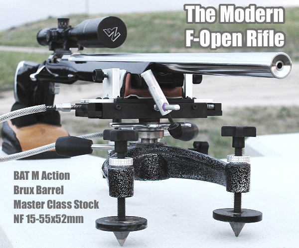

The F class open guys all use a 3 inch wide flat forend stock that wedges itself in the front rest. its almost to the point that its clamped in the rest. Super stable from prone
Any reason you don't want to use a McMillan/Manners/Foundation? I shoot a McMillan in PRS and don't find myself at a disadvantage compared to a stock on the positional stages
The stocks you are thinking of aren't gonna be ideal in F-Class, Mcmillan and Manners do make F-class stocks but they will be less than ideal in PRS.
If you wanna save a couple bucks might be better off to get an appropriate stock for F-class and then if you start PRS buy a chassis that fits your barreled action and just switch it back at forth. That being said you gotta ask yourself do you want to be competitive in F-class or are you just going to shoot for fun? If you want to be competitive I wouldn't cut corners, use a recipe that wins. That means a single feed action.
This ^^^ if you have never shot a purpose built F Open rifle with proper front adjustable rest and correctly sized rear rabbit ear bag they look and seem kind of clunky.
But when fired they slide in the rest and rear bag like it's on ballbearings and effortlessly slide right back to the forearm stop barely moving off point of aim if any.
Impressive for its intended purpose but pretty impractical for much else.
Close but the forehand cannot be wedged in the front bag and must lift out vertically otherwise you will be DQ'd. Never have seen a chassis at an F/O match bit have seen a few for FTR. The stocks are generally weighted to bring the rifle in just under 22lbs.
