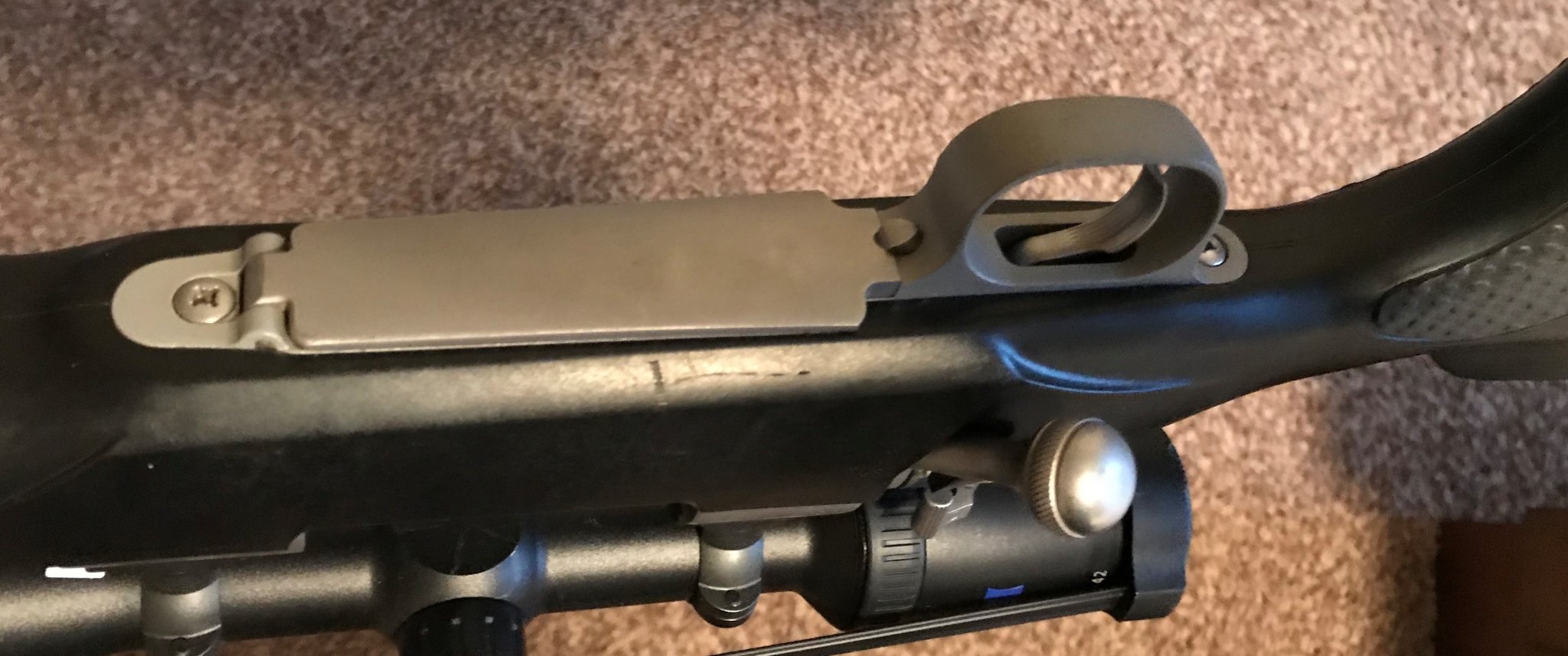

My real intent is to get a different stock or chassis and want to use a DBM instead of the hinged floorplate I now have.
What my pea-brain can't figure out is whether I buy a stock with DBM and simply install the stock, or whether I need to convert the mag first.
Can I simply remove the stock with the hinged floorplate, then install the new stock with the DBM? Is there anything else I need to do to get the receiver to accept cartridges from the drop-out mag?

That is not up to date information from MDT.
The current ESS chassis will work on any post 1984 model 70 with 7-1/8” guard screw spacing.
You do need to use MDT metal mags or trim the fronts of polymer mags.
Thanks for that - you are correct sir. I just phoned MDT to ask. He was confused by their own poorly worded answer under the ESS Q&A. It should not say what it does. It's not out of date - it's just wrong.
Good news is yes the ESS will fit my 2003 Win Model 70 which does have the 7-1/8 spacing. However he said 90% chance I will have to modify for the magazine by bending some tabs on the mag (? - must be what you are referring to).
Also he says most likely I will need to notch out my feed ramp in the receiver to allow the bullet tip to pass upward and not get caught. A little over my head; now I will have to look in the action while cycling and see what he means by that. I don't know if I am comfortable taking a saw or file or dremel to my receiver.
He also did say that Model 70's are a bit of a headache for them due to different fits.

that’s a great question that only you can answer. For me, it comes back to whether the rifle is a shooter before the change to chassis.
Also, if your main goal is just having a shooter with a DBM then there are easier and cheaper methods for sure. Comes down to whether that rifle has any sentimental value (first hunting rifle, dads rifle, lucky rifle).
personally, I also have zero interest in modifying my own action so it will feed. I have lots of faith in my ability to hose that up.

zog, need some clarification to answer your question.
Do you want a DBM that is reliable and feeds from readily available aftermarket AI or Accurate mags,
Or a cheap and easy method to convert?
If you are wanting the first option you can have your action milled to allow flawless function.
This is not a big deal but it is best accomplished by a smith with a mill.
Unfortunately CDI Precision is no longer in business, so you are faced with finding used or NOS bottom
metal.
Or, God forgive me.....you can purchase bottom metal from PTG.
Hope this helps.
Good Luck!
Thank again for your advice - I was not aware that I had to make a choice. My lack of knowledge, and why these forums are great.
I only want quality or it's not worth doing. Since posting this I got similar advice from a gunsmith at LRI in Sturgis, who kind of said the same thing. He told me that I can get any of about a dozen DBM's on the market and just screw one in, some will have gaps all the way around and some I would be trimming with a chisel or box knife in the stock, then filing the action, then cussing every time I cycle it, finally giving up and taking my wrecked gun to a smith.
Or i can take it to a smith and get the stock with DBM right the first time. Once again I have to make the decision as to whether my rifle is worth it, and it isn't.
The rifle's value to me is right in-between - It would actually be a fun little hobby to hack away and see if I could get a DBM to work, but the rifle is worth more than that. But it's not worth enough to spend too many $$$ on.
So I bought a stock on sale from Stockys (again VERY few choices for Win model 70 short mag compared to roughly one million choices for Rem 700), and will just screw it in and leave the spr-o-oing as is.
