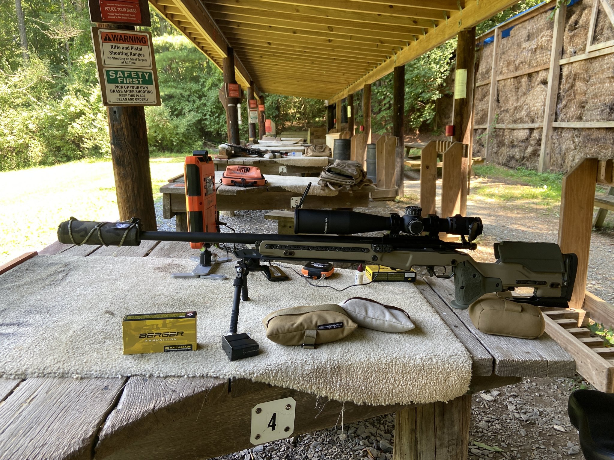

I have a McMillan Game Hunter and an MPA Hybrid Chassis. For bench/prone plinking, I think I lean toward the chassis over that particular stock. I really like the adjustability of the cheek piece, and the feel of that vertical grip and thumb shelf. I do realize there are stocks out there with those same features, but I do not own one. For target shooting, I vote chassis
