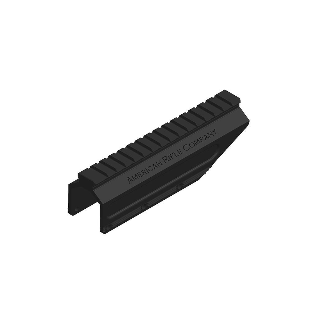

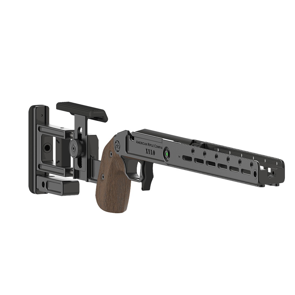

Check out our Xylo chassis. Everything forward of the sliding butt assembly is machined from one big and expensive chunk of 7075, the strong aluminum, as opposed to 6061 which is the cheap stuff. The 20 MOA NV bridge connects to the forfend of the chassis by way of six conical head screws which work to draw together a serrated interface between said fore-end and bridge thereby unitizing the two. I'm not aware of a better system available from anyone. Some chassis have tubular fore-ends with 12 o'clock rails but as far as I know, those fore-ends are bolted to the portion of the chassis to which the receive and scope are attached. That's kind of a shitty place for a joint considering the fact that bipods are usually connected to the fore-end and invariably impart significant loads to the joint. That's not so say the a connect can't be designed to withstand those loads, but was it? That's not something you need to worry about with our chassis. Check us out and thanks for your consideration.
