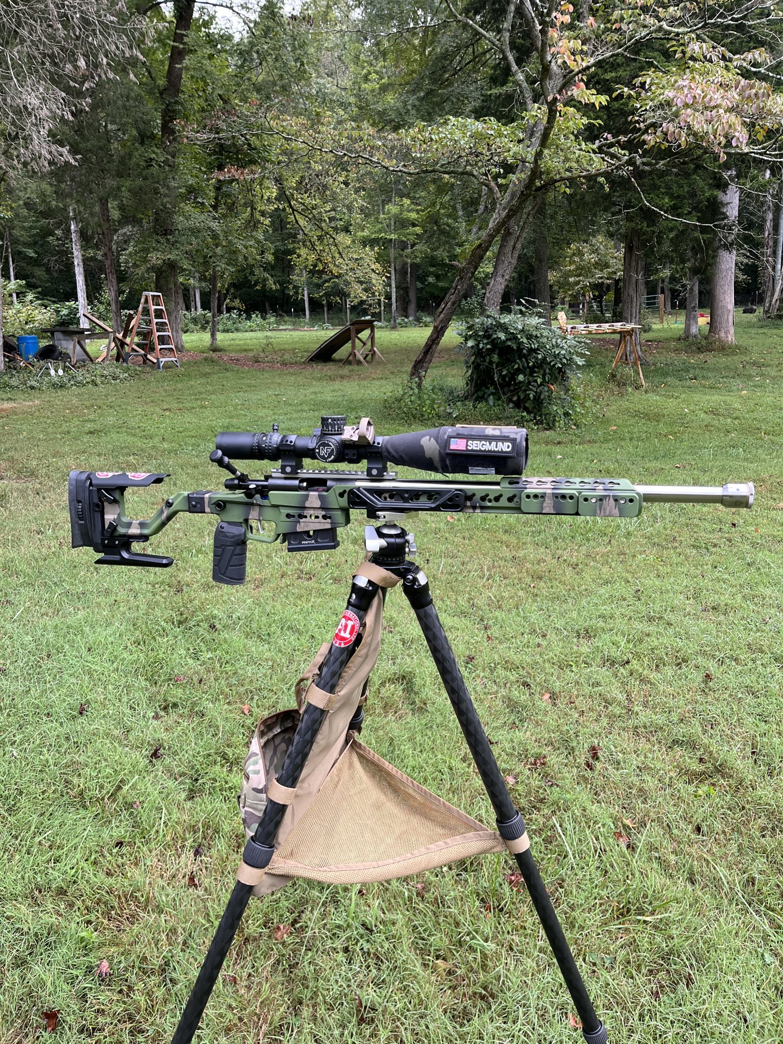

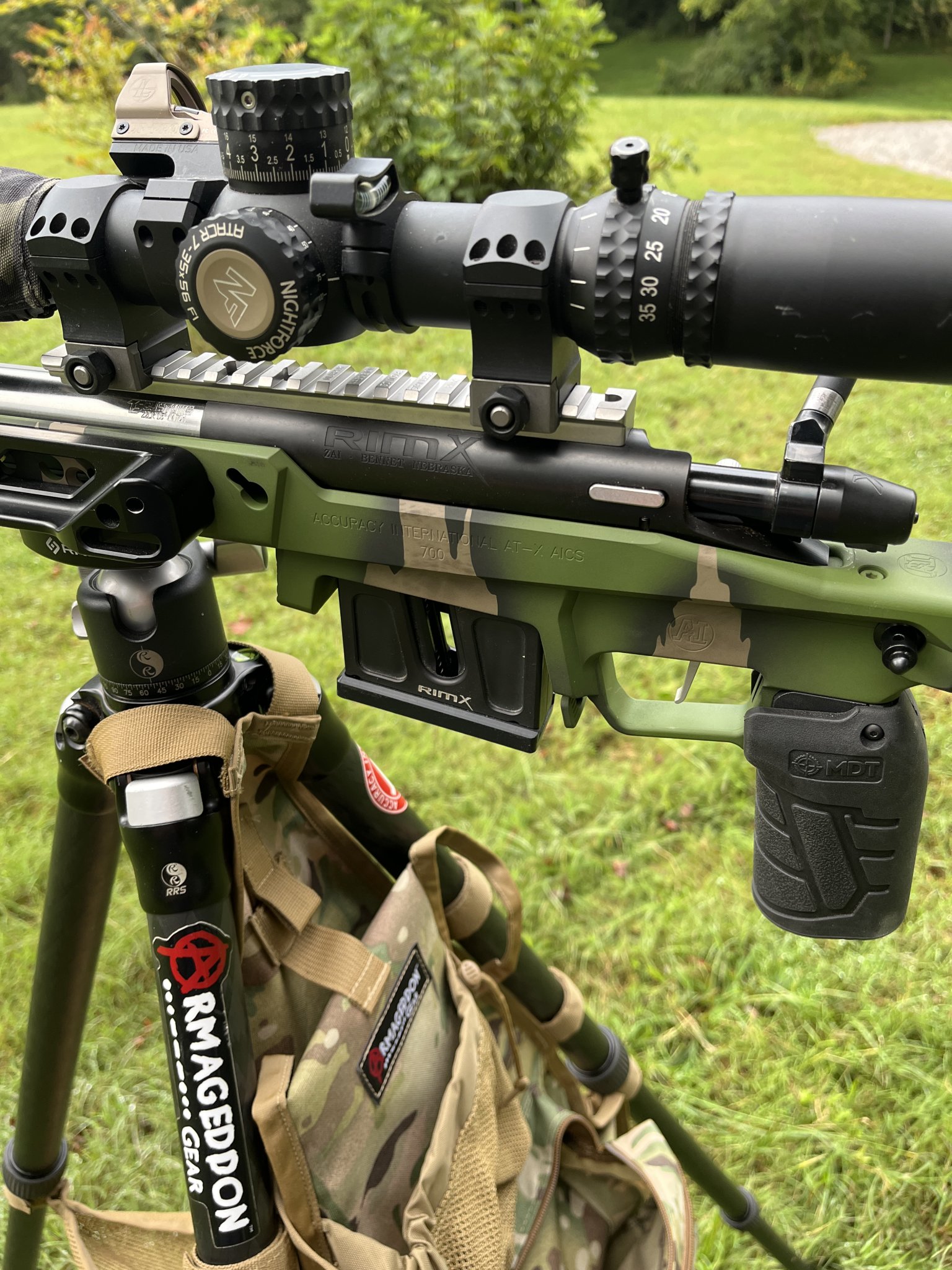

AT-X AICS, RimX 22. No fly's on anything.
