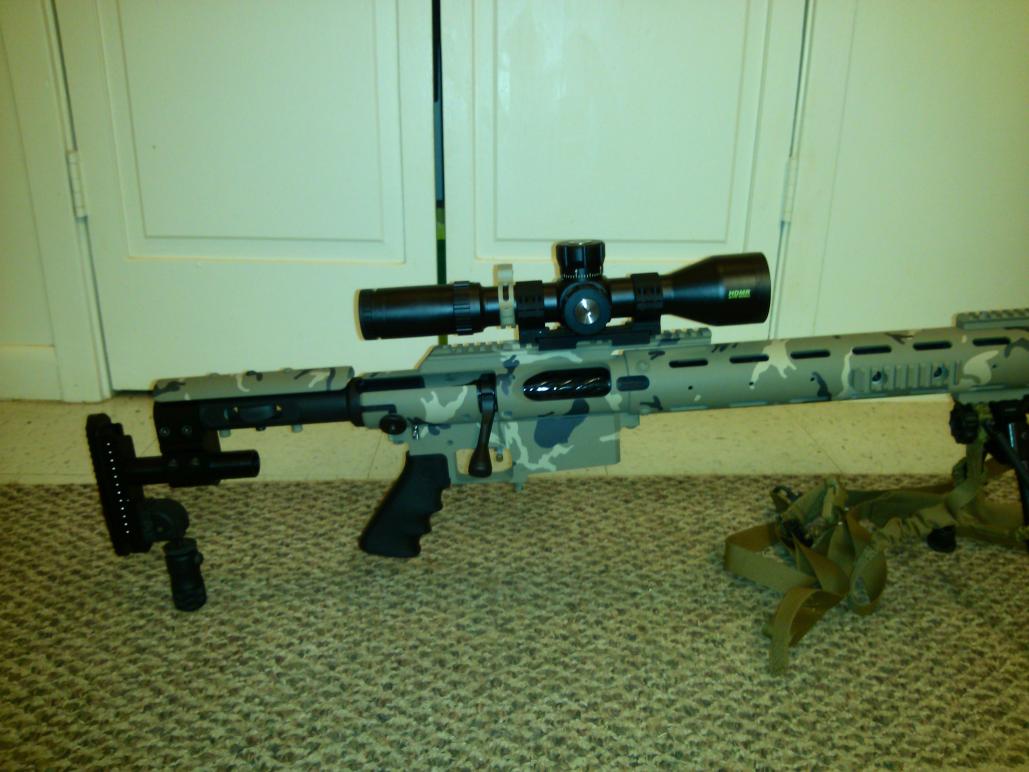

Check out PDC Custom, they were one of the few that could fit a Savage long action
<a href="http://s94.beta.photobucket.com/user/bjfergpls/media/shooting/IMG_0613_zps46100cbd.jpg.html" target="_blank"><img src="http://i94.photobucket.com/albums/l92/bjfergpls/shooting/IMG_0613_zps46100cbd.jpg" border="0" alt=" photo IMG_0613_zps46100cbd.jpg"/></a>
Craig was great to talk with, price was reasonable, and he hit the deadline he promised me. I have shot it once and the difference between a stock, even a very nice one, and a chassis type setup is unbelievable.
I started playing with the Rock Solid Chassis and I have to say Todd has a winner there. Not to take away from any other chassis, but he does a great job making a solid Chassis.
His chassis also fits a nice variety of actions, as an example very few will fit the old style Bighorn Action as the lug is forward, his allows the Bighorn to drop in. (I did bed behind it)
Dropping it in and tiny bit of bedding and this was a very accurate chassis.
