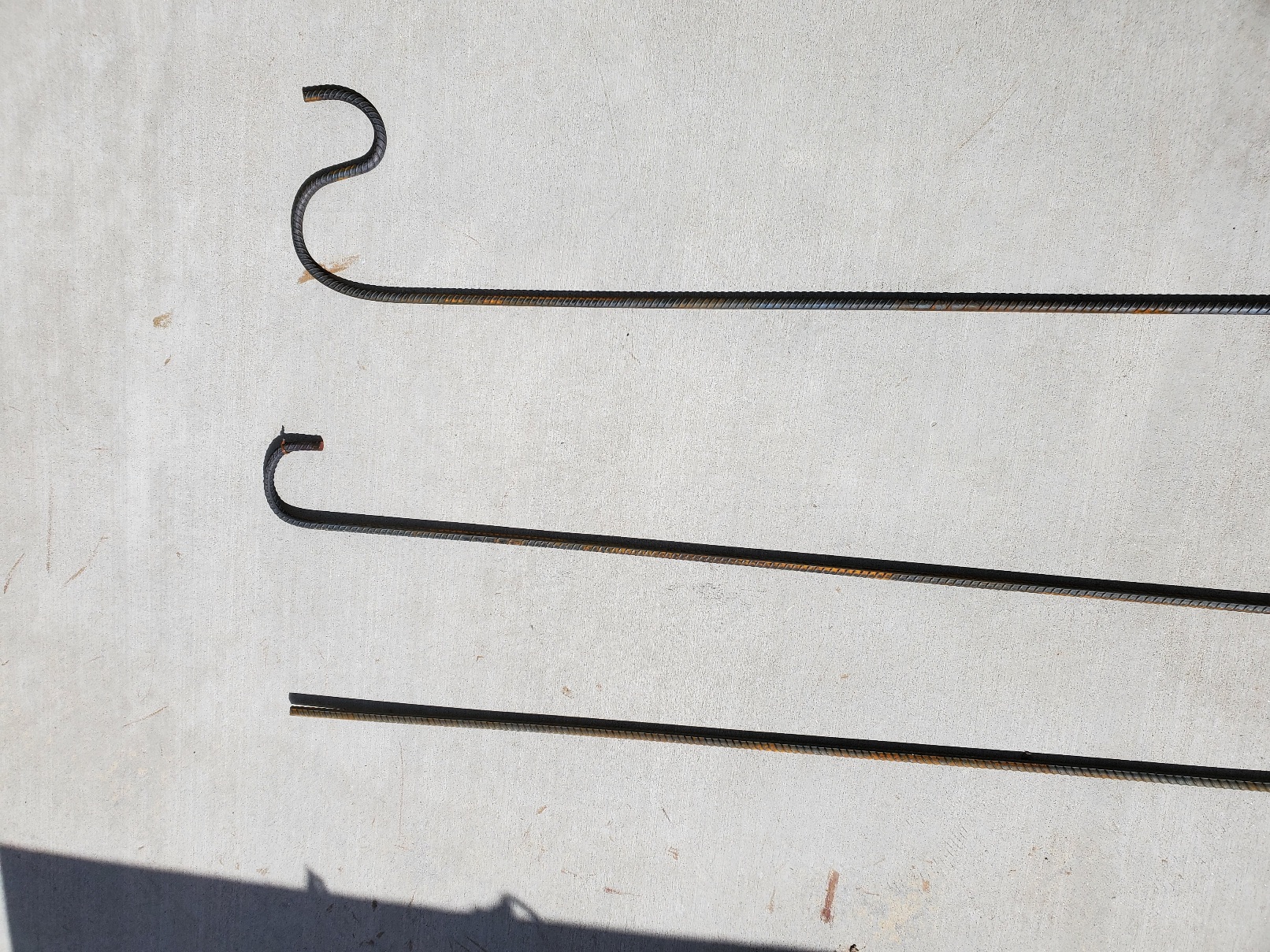

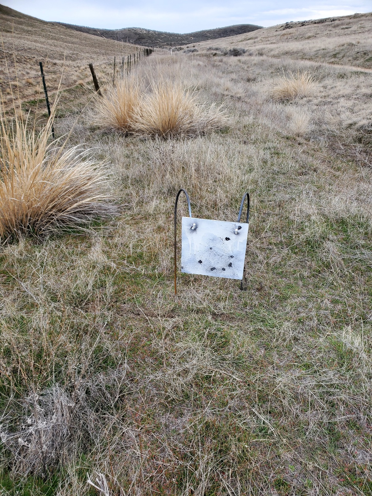

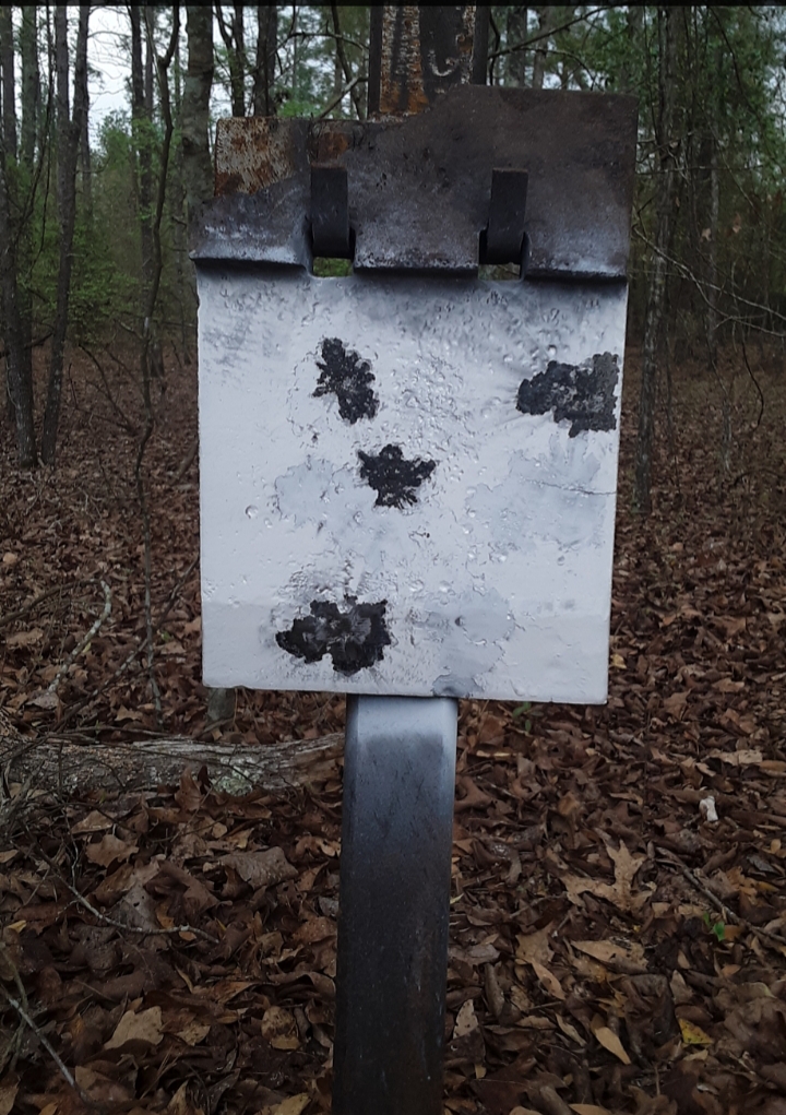

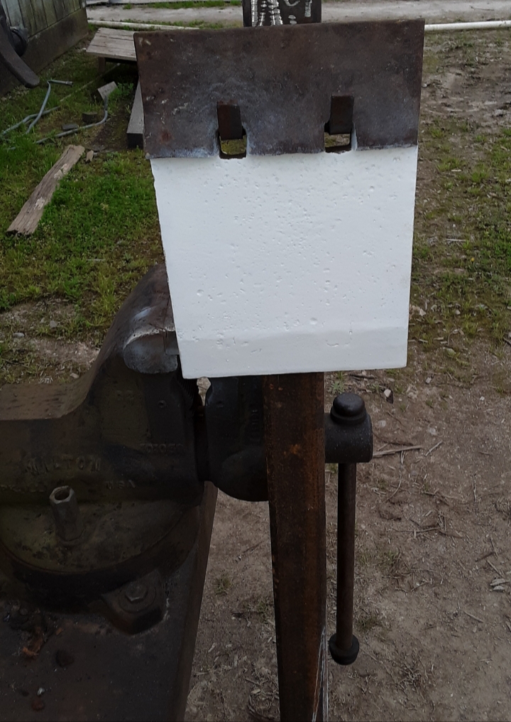

being the cheap MFr that I am I've been looking for the cheapest way to set gongs up out in the field. BLM land to be more specific. came up with this. surprisingly it can take a few hits at distance.
about $4.00 at HD is a 10' stick of ¼" rebar. cut in half and bent on the vise to make a sheapards crook hanger.
Looks good!

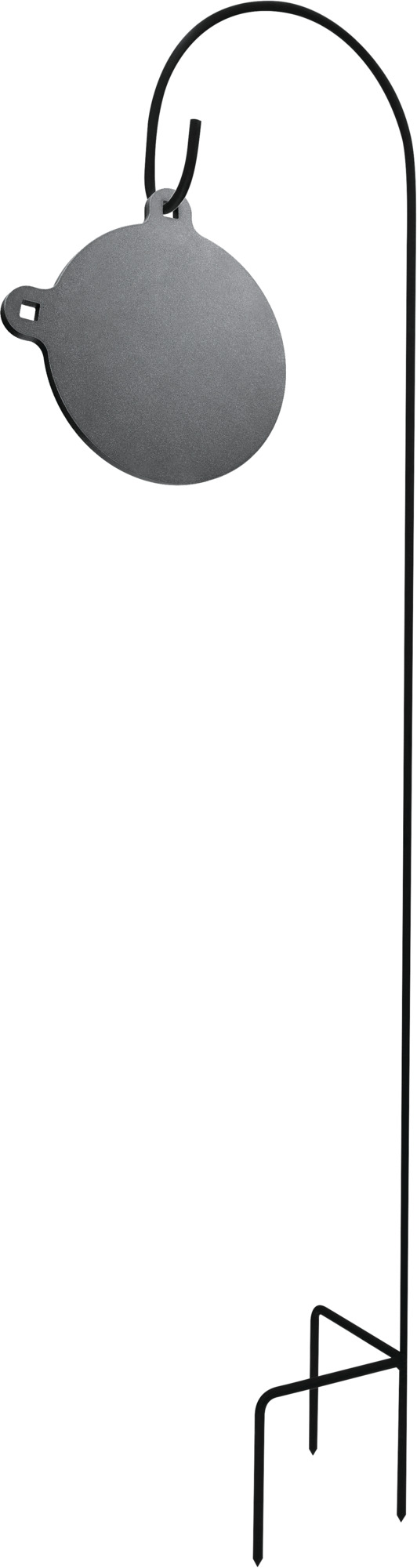

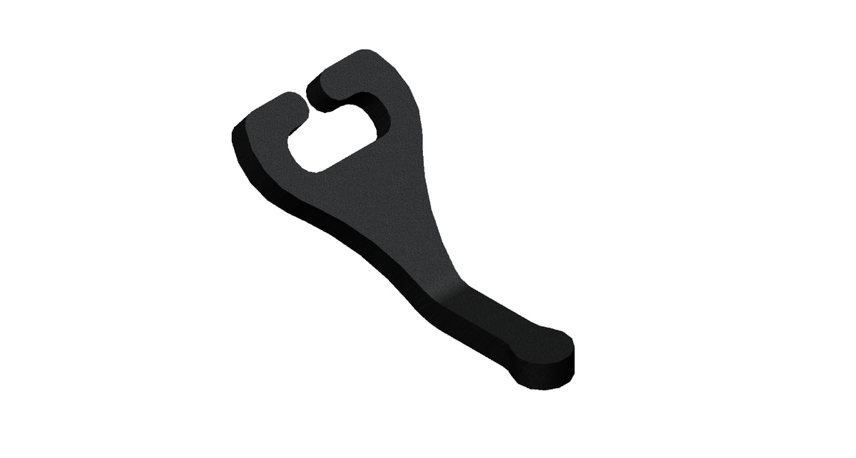

I was turned on to these by an instructor and I've been very pleased so far. T-posts are cheap and easy to put in or take out. The pricing on the targets makes me think they're not really AR500 or somehow got some cheaper grade of it. Personally, I've switched over to all 1/2" plates and even those get a little beat up over time by rifle fire.
Get these hangers
Then get whatever sized steel plate you want and all you have to do is pound in the t post wherever you want it, put on the twist lock, and then put the plate on it. Only issue I've had is that the t posts will loose a chunk when a miss hits them. Wasn't me, must have had some friends make a bad shot or two. :)
Reactions: camocorvette
Get these hangers
Ive looked at those. do they only work with their plates that have the keyhole or any plate? $13 hanger + $6 T-post. $40 for a Tpost Driver.

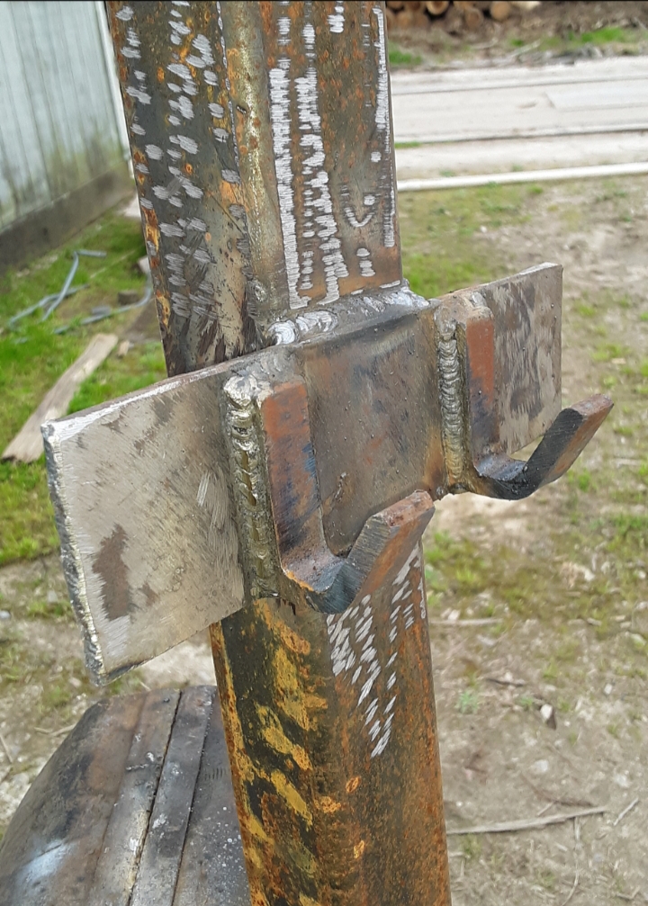

As a former welder and custom metal fabricator, I’d say, the cheapest gong hanger would be some 1.5” x 1.5” .250” wall square tube, a welder, a bandsaw, a tape measure, some lengths of chain, some good Rustoleum spray paint, and a “can do” attitude. 👍🏼

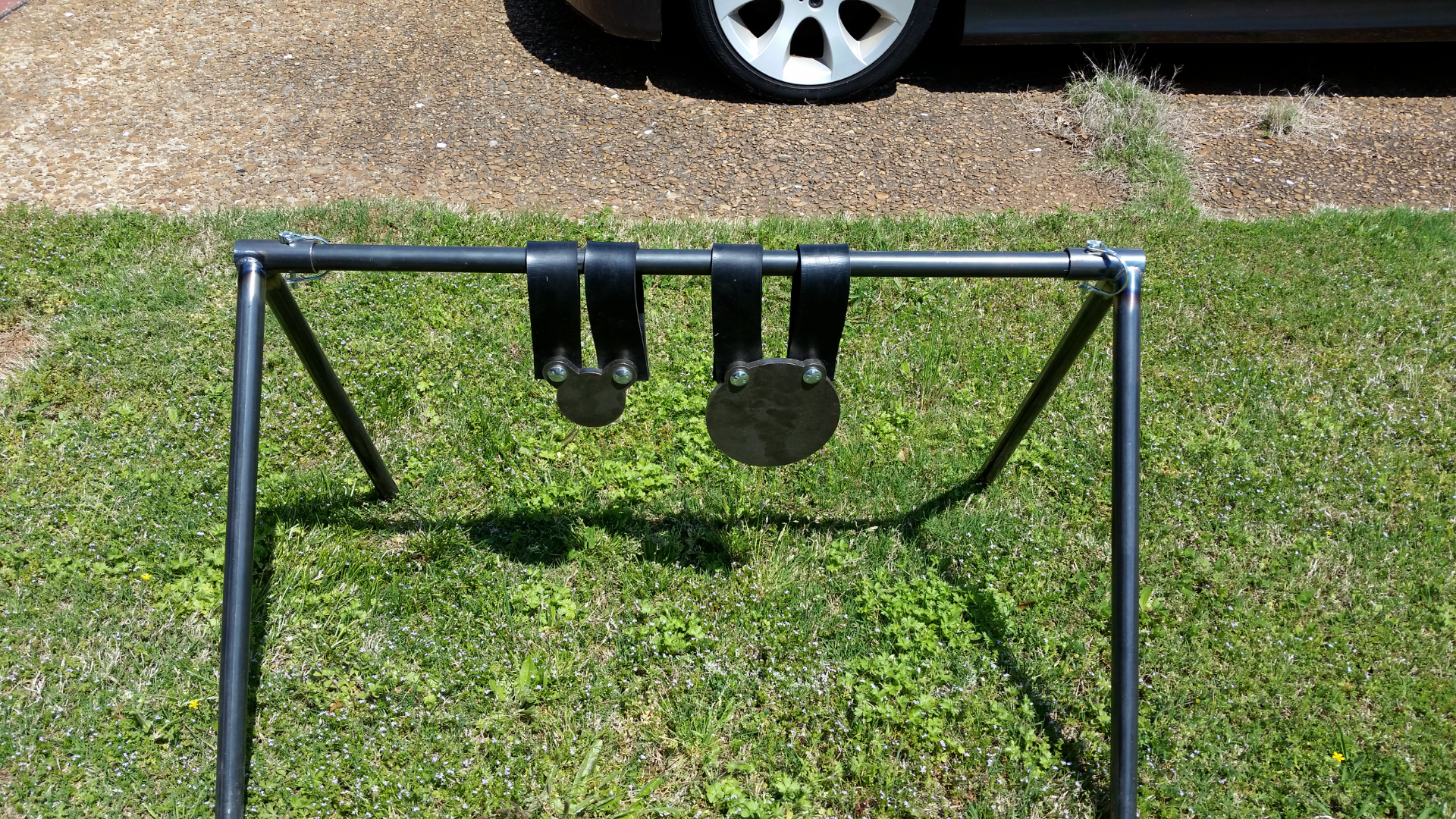

IF(big if) someone made exactly what I wanted I probably couldn't afford it..so I build my own.
Reactions: FuhQ
where do you get the rubber straps?

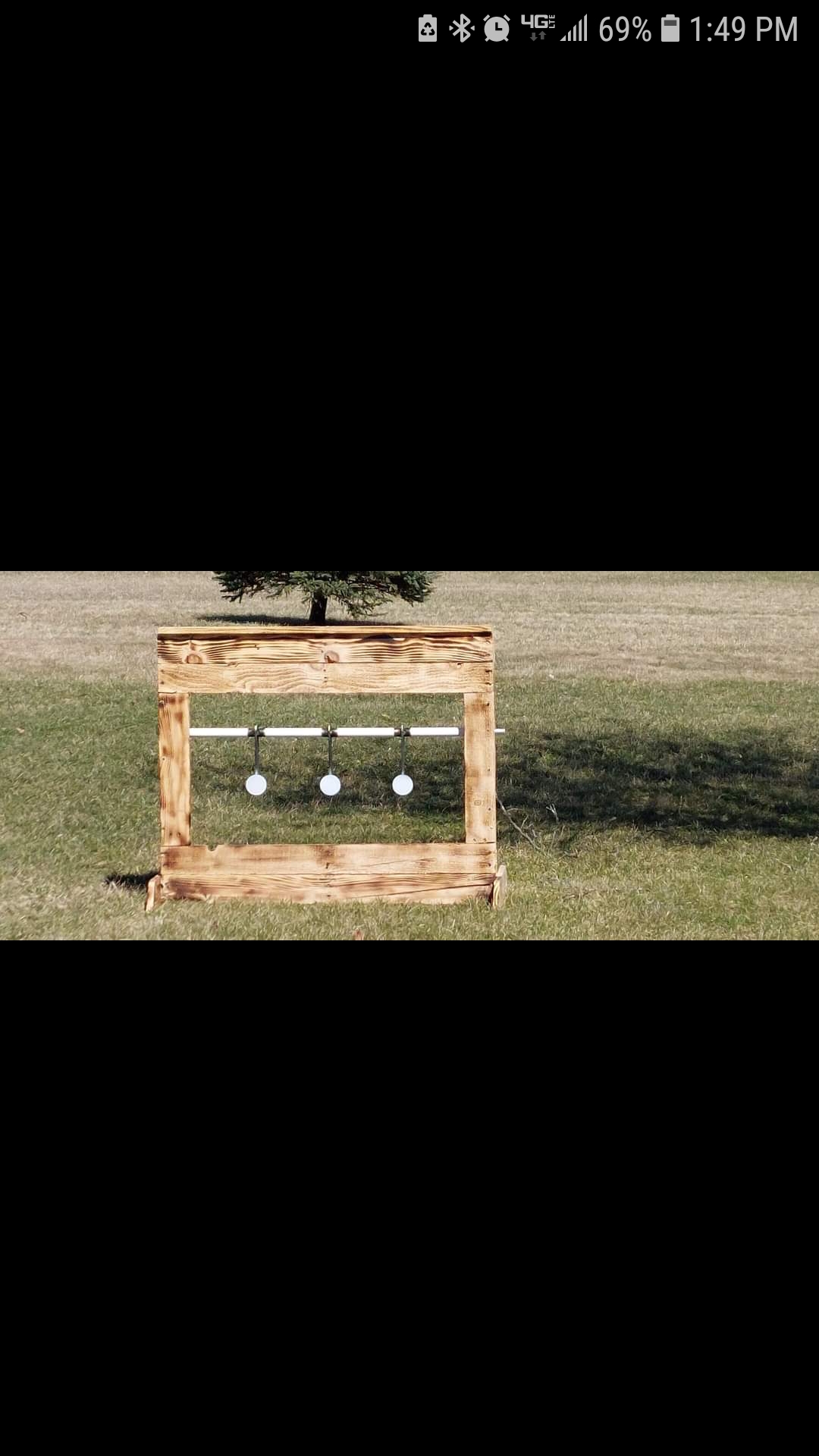

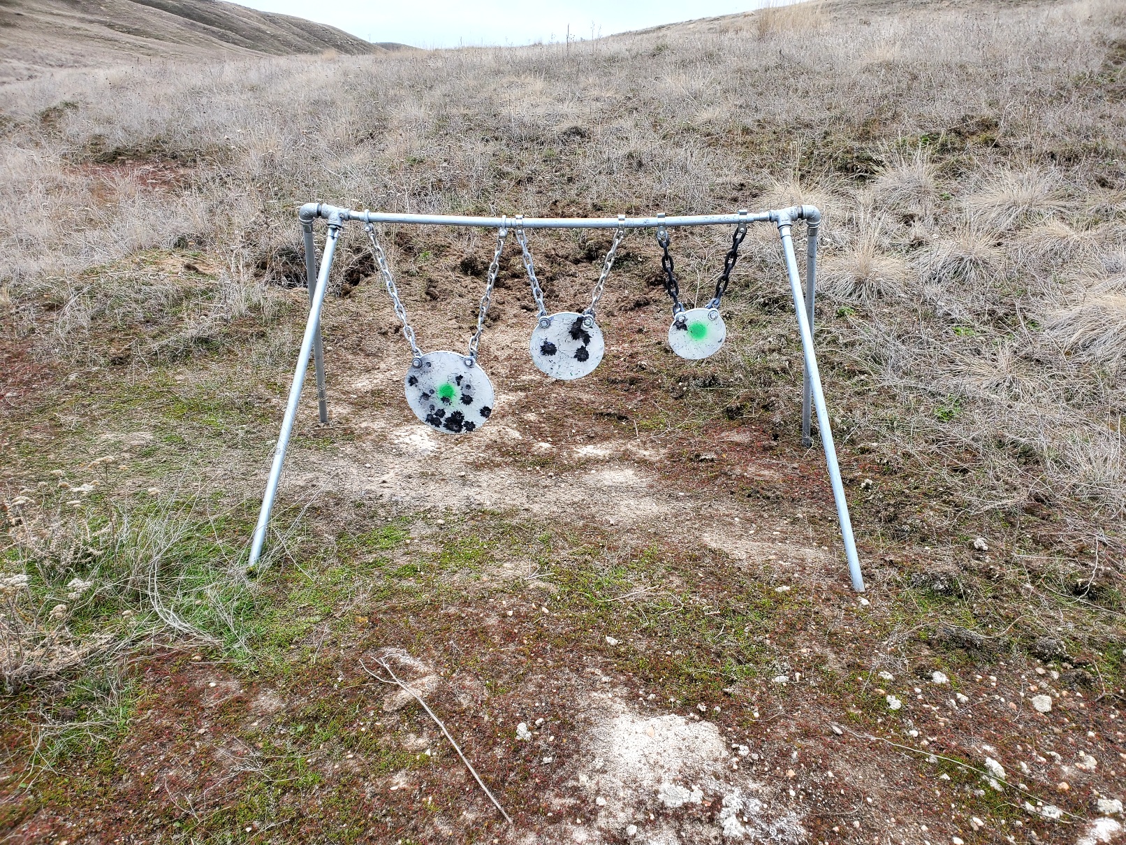

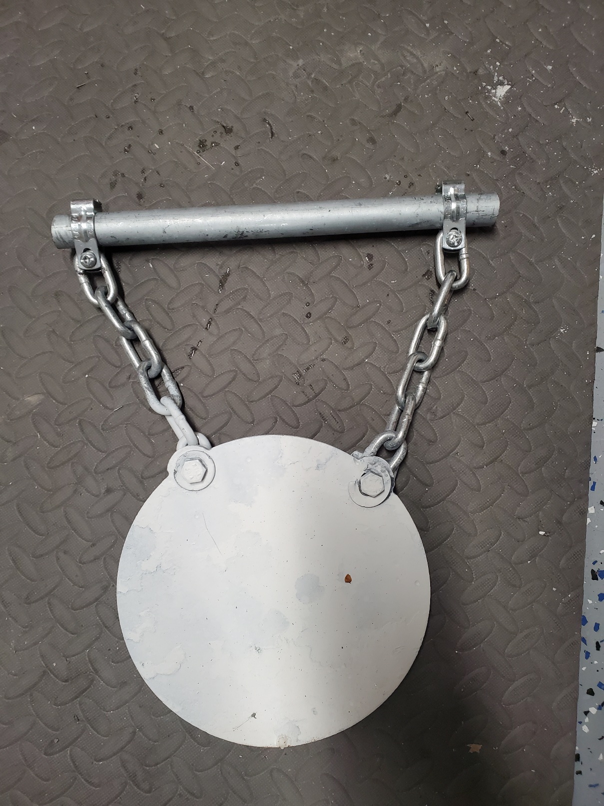

my previous multi gong rack involves misc electrical conduit connections and chains.
I attached each gong to a section of conduit that can swing freely. this reduced the stress on everything and made setup easier.
old conveyor belt or rubber horse stall mats will cut up into nice hanging straps.
Those are just 1/4"x2" rubber gasket strips that come in 16' rolls. Got a couple rolls at the surplus store for $5. I tried chains for years but they they only take a couple hits near a plate and she gone... The rubber takes a good bit of abuse and just hangs in there.
