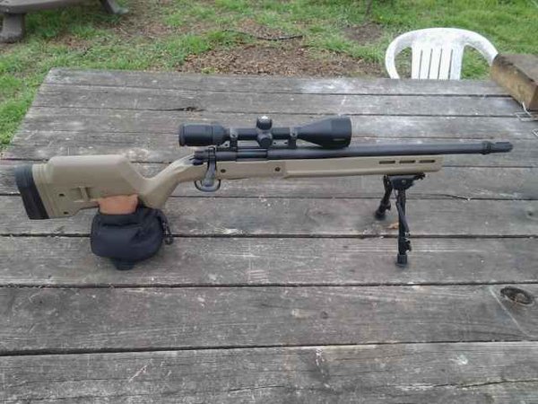

    My sa rem 700 spr 300 black fit like a glove.
    Had about 3/16th on either side of lug, not regreting it.
