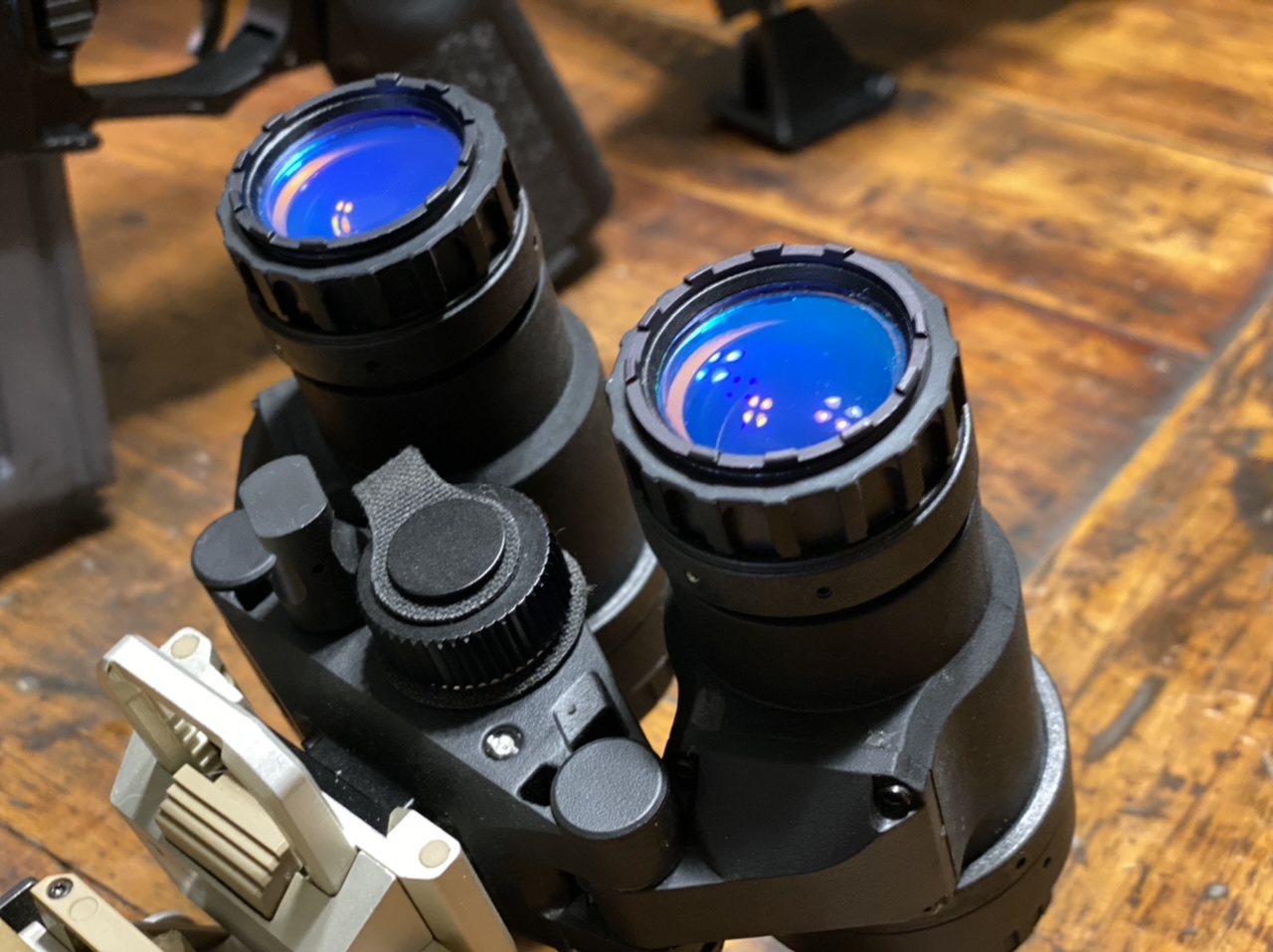

Ethers are nice and light, with an improved eyebox. It’s really the objectives that seem to make more of an impact. The custom RPO’s in my DTNVG give them that little extra push to make them really special. Not an epic difference, but also lighter and 1/4” shorter than .MIL objectives — which doesn’t *sound* like much, but looks and feels like more. Then the slight, but noticeable, added clarity and edge-to-edge distortion-free image is, at least to me, worth the extra coin. If I’m paying $10K for a set of world class binos, I’ll spend the extra $2-3K to push them over the top.
Ethers are nice and light, with an improved eyebox. It’s really the objectives that seem to make more of an impact. The custom RPO’s in my DTNVG give them that little extra push to make them really special. Not an epic difference, but also lighter and 1/4” shorter than .MIL objectives — which doesn’t *sound* like much, but looks and feela like more. Then the slight, but noticeable, added clarity and edge-to-edge distortion-free image is, at least to me, worth the extra coin. If I’m paying $10K for a set of world class binos, I’ll spend the extra $2-3K to push them over the top.
ya ill be honest If i could do it again I probably wouldnt get the ethers. Its not a big enough difference to be that noticeable. pvs14 eyepiece accessories dont fit them. and with the reputation to scratch Im afraid to be all horta driving my nods into a swampy drink with them. if you know what I mean.

OP, other considerations: given the timeline for your tubes you might want to preorder a DTNVS. It’ll be available by then, barring some major issue. You could also save money by getting the RNVG if you don’t need the tubes to fold back against the helmet or shut themselves off.
I like the MAWL because the switching takes care of the spill from the Illuminator. No need to dial it up or down manually. The switching is intuitive.
Thanks for the advice! So if I understand this right, the general consensus on the NVG setup is to order the DTNVS (rather than DTNVG) due to marginal increase in both cost and performance, correct (as well as lighter weight)? 10k is a lot of money and I have no issue dropping another 500 for a lighter weight setup with marginal improvement if this really is the case. I'll reach out to TNVC and see what the deal is with the DTNVS if i get some confirmation this is the way to go.
I would also think about whether or not you consider manual gain to be a critical feature, which BNVD's have.
