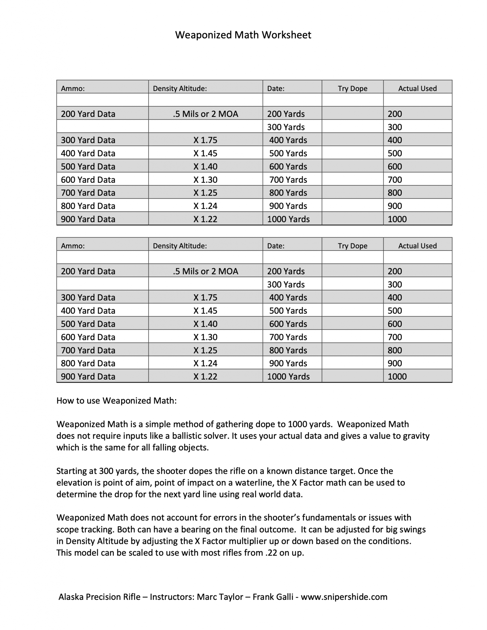

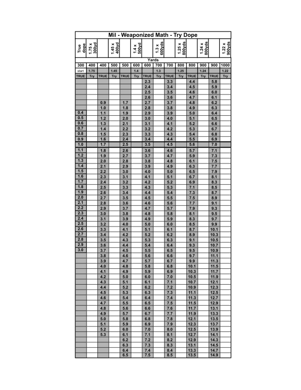

This is all you need, Weaponized Math
This is pre-Trued data, you can start at 200 or 300 (sheets begin at 300 )
200 = 2 MOA or .5 that gets you there within an inch
200 yard dope X 2 will get you started at 300 or you can go 1.96 for a dead on.
Once you have 300 you use weaponized math
300 yard dope X 1.75 = center strike at 400 yards
400 yard dope (mil or MOA) X 1.45 = center strike at 500 yards
Simple
Zero inputs with Weaponized Math and its Pre Trued......

It’s not for the lowest, it’s pre trued data that can immediately put into an app to correct it completely vs trying to chase it as you described.
I use it every time I dope a rifle

Don’t Discount the quality of Weaponized math. Using the tools available to solve problems, is the mark of an intelligent man. Creating such tools, is borderline genius.
I obtained a good velocity figure, using a quality Chronograph. took the rifle to a range that offered good wind protection and known target distances. Found the exact scope settings to hit every target from 300 yards to 800 yards.
After being introduced to Weaponized math, I cross checked my settings to those recommended by Weaponized math. They matched almost perfectly.

Weaponized math works. It takes out all kinds of possibilities of errors using a ballistics calculator. Ballistic calculators work too, but you have to get the inputs right and there are a lot. Picking the wrong rifle profile, having your density altitude set at mount everest, experimenting with a different 0 range and not changing it back to 100. These are all examples of mistakes that some dumbass has made.

I know you can probably just wing it at 300 yds, but playing with the numbers it looks like multiply 200yd value by about 2.6 to get to "Try Dope" at 300
200 should a straight X 2 or actually 1.96
2.6 seems way off when you consider most stuff uses 2 MOA and 300 uses less than 5 in most cases.
.5 and 1.0 Mil is generally correct, a very short 308 will be 1.5 mils at the worst so it would depend where you rifle falls within the caliber
But 2.6 would be an extremely slow caliber
2.6 was the factor, not the mils/MOA.
I looked at JBM ballistics for 3 loads.. the way I was seeing it was if you take the dope at x divided by the dope at x-100yds you get the factor.
so from JBM a 2650fps 175 SMK gives .5 at 200, and 1.3 at 300..so 1.3/.5=2.6 factor
2750 fps 175 smk gives .5 at 200, 1.2 at 300, so 1.2/.5=2.4
a 75gr 243 going 3300 gives .3 at 200, and 1.0 at 300, so 1/.3=3.3..
The factors given on the weaponized worksheet were pretty much spot on from 300 to 1000 for what a JBM solution provided (for a 2650fps 175gr).
300 was 1.75, dividing the data in JBM gave 1.77
400 was 1.45 and1.43 from JBM
500 was 1.4 and 1.36
600 was 1.3 and 1.31
700 was 1.25 and 1.25
800 was 1.24 and 1.24
900 was 1.22 and 1.21
So pretty cool way to get close without using a computer or knowing you velocity. Just one small sheet...

I honestly don't think you can do that, you have to shoot it, which is why computers have to be trued.
A 243 needing .3 is not gonna use 1.0 it's gonna be closer to .8 if that, so imagining the numbers will be "close" especially up close but they will also show a bit of deviation doing it that way.
Remember weaponized math was developed taking the dope for 16 students across 3 different classes, and then putting everyone into a spreadsheet. So 48 different rifles where the actual drop was recorded, and because we move people to a waterline you have an actual, You aimed here and hit here result. That said, nothing posted will be a miss on a plate. None of those numbers are a miss. If you need more than .3 to adjust you probably did something wrong. We also see a lot of people with their dope have lower elevation because they recoil back and up so the dope is off as they have to come down in elevation. I saw it with the riflekraft students too, many rock back in the bags and hit high so they have to drop their data. Weaponized math cannot fix back fundamentals.
308s are slow so adding .1 or .2 to a dope is easy, but just because JBM says it needs this, doesn't mean the rifle will agree.
The fringe velocities will always be slightly off, the edges are never perfect. We need velocities that sustain supersonic speed across the entire range and in case of stuff going slower the rate of decay will faster. The optimal is 1300 at 1000 yards at a minimum for dope to line up 100%. The faster you go the more predictive it will be.
Being .01 or .02 in the X factor is minor, would depend on altitude too, up in the mountains bullets fly better so after 4k DA you would pull a bit out of the numbers.

If the 243 is closer to .3 at 200 and .8 at 300 that fits better with a guess of 2.6.. .8/.3=2.6.
I'm not sure how to explain it.. The sheet says weaponized math is based on the drop from gravity, and looks to me like this is also reflected in the JBM data, though through different math.
All ballistic solvers know about gravity. But ballistic solvers are just a model. Weaponized math is a model.
All Models are wrong. Some models are useful.
What Weaponized Math process gives you is data to true your model. Its real world DOPE. Now you can use that to get BETTER predictions from your JBM, Kestrel, Whatever.
Solvers use MV and BC as parameters to give you a prediction. Weaponized math gives you data (Most people ignore the "Actual" column, but that's the whole damn point is to get that column). You take that data to your solver and make the predictions line up with your real data. Thus you get a prediction in line with YOUR data. Not what the solver thinks it should be. You can tweak your SOLVER MV and BC so that it gives you what you actually shot. Then you get much better predictions rather than the random "All rifles will shoot the same"
Whats my MV on Hornady ELD-M Match? Dunno Never Measured it. My Kestrel says 2730. Where did that number come from? I made the "actual" numbers from WM line up with my kestrel range card (100-800) by tweaking the Kestrel MV. If I need to adjust 800-1000, I use BC.
Solvers are a guess. Don't guess. Measure.
Then when you truly have to guess, you've got data to back that guess up.

THE UPDATED WORKSHEET that we use to get hundreds of students per year on target with first round hits.
It views near-to-far, just like the range you are looking at.
USE IT. Start from lower left and move to the right. Take that Actual number up and left, do the math and repeat.
You're welcome, shooting world!
---Taylor
  • *WEAPONIZED MATH WORKSHEET .pdf
