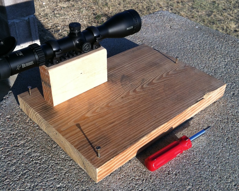

I made this fixture to do scope testing.
Just so everyone understands, this does not have to be done a 100yards. I routinely do this in my backyard at 25 yards. Instead of spacing the mil points at 18" apart, I space them at 4.5" to simulate 1/4th of the distance.
I also use a Monfrotto tripod with hog saddle. It is stable enough to just turn elevation and windage knobs. It gets the job done.
In my opinion, you need a fixture onto which you mount the scope, and can clamp onto a table or shooting bench. It helps to have the fixture actually contact the benchtop via 3 fine-thread bolts (leveling jackscrews) so that you can put a level across the pic rail of your fixture and level it.
Yes, you can perform a test under live fire, but they you are adding marksmanship, ammunition quality and rifle repeatabililty to the list of variables. It's really best to eliminate those and test JUST the scope.
