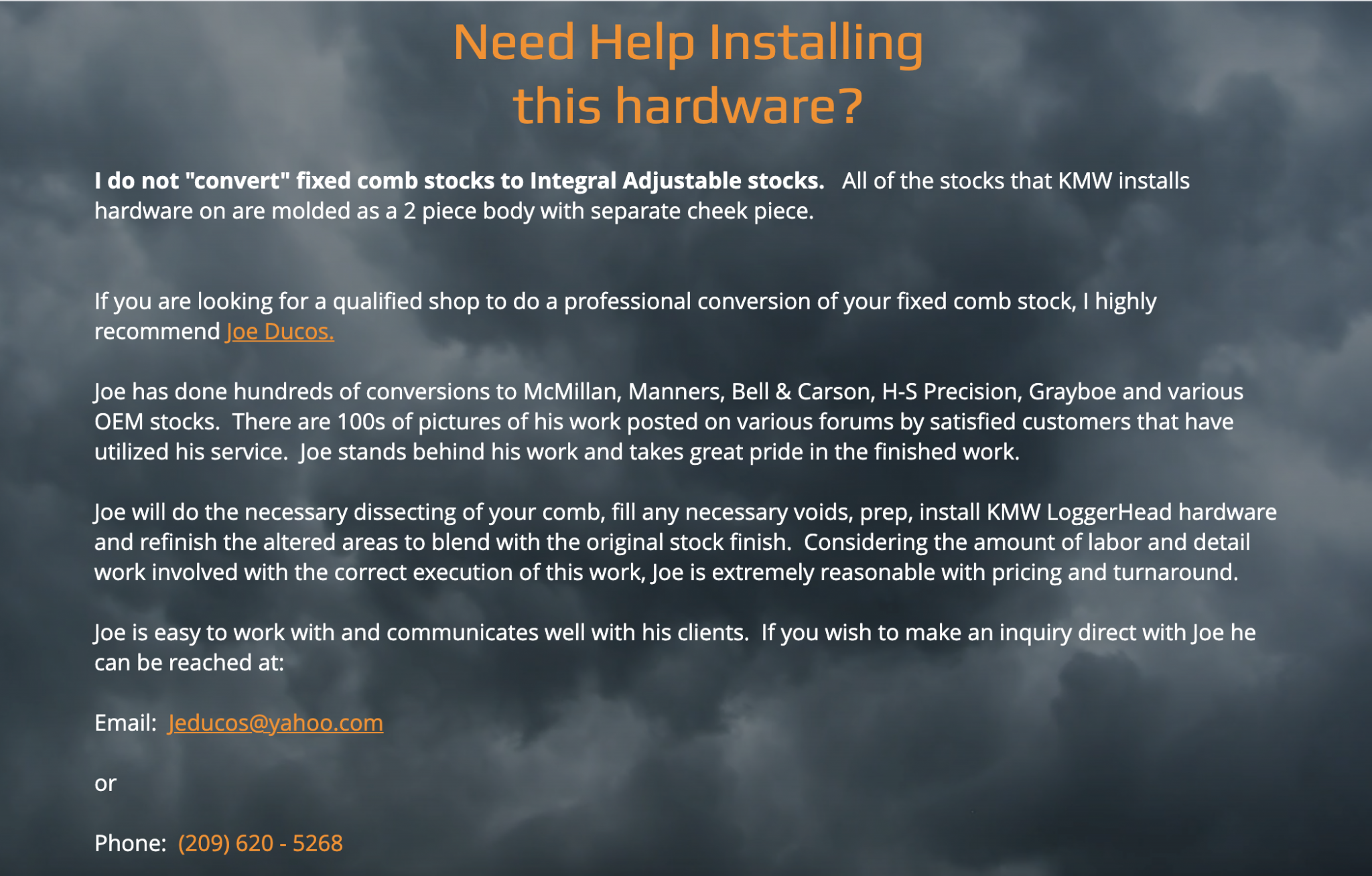

This is who Farmall was referencing - he's a member here as well. Not sure if he'd be able to do anything with the Seekins stock, but worth asking. He does top notch work!
Thanks! I contacted Joe at the email address you sent and he has been super responsive. I ordered a victory titan since it is fairly cheap to see how I like it and how much it weighs. I need a riser on another gun too so if I don't love it for the element I will put it on that savage.

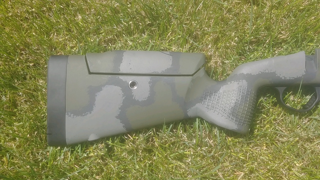

This is a stupid question to most of you probably but I have need had experience with a stock with the kmw loggerhead hardware installed for an adjustable cheek riser. I know it is standard on some of the nice stocks like the manners. My question is how exactly does it work? From what I can tell you use an allen wrench from the side to lock it in so it can't pull out and it looks like you use e-clips to set your height where you want it so it is the same when you take it on and off? I have seen reference to it being adjusted side to side (toward or away from the shooter) but how is this adjustment made? If anyone knows of a review or video showing all of this I would appreciate a link. I have been searching but can't find anything.

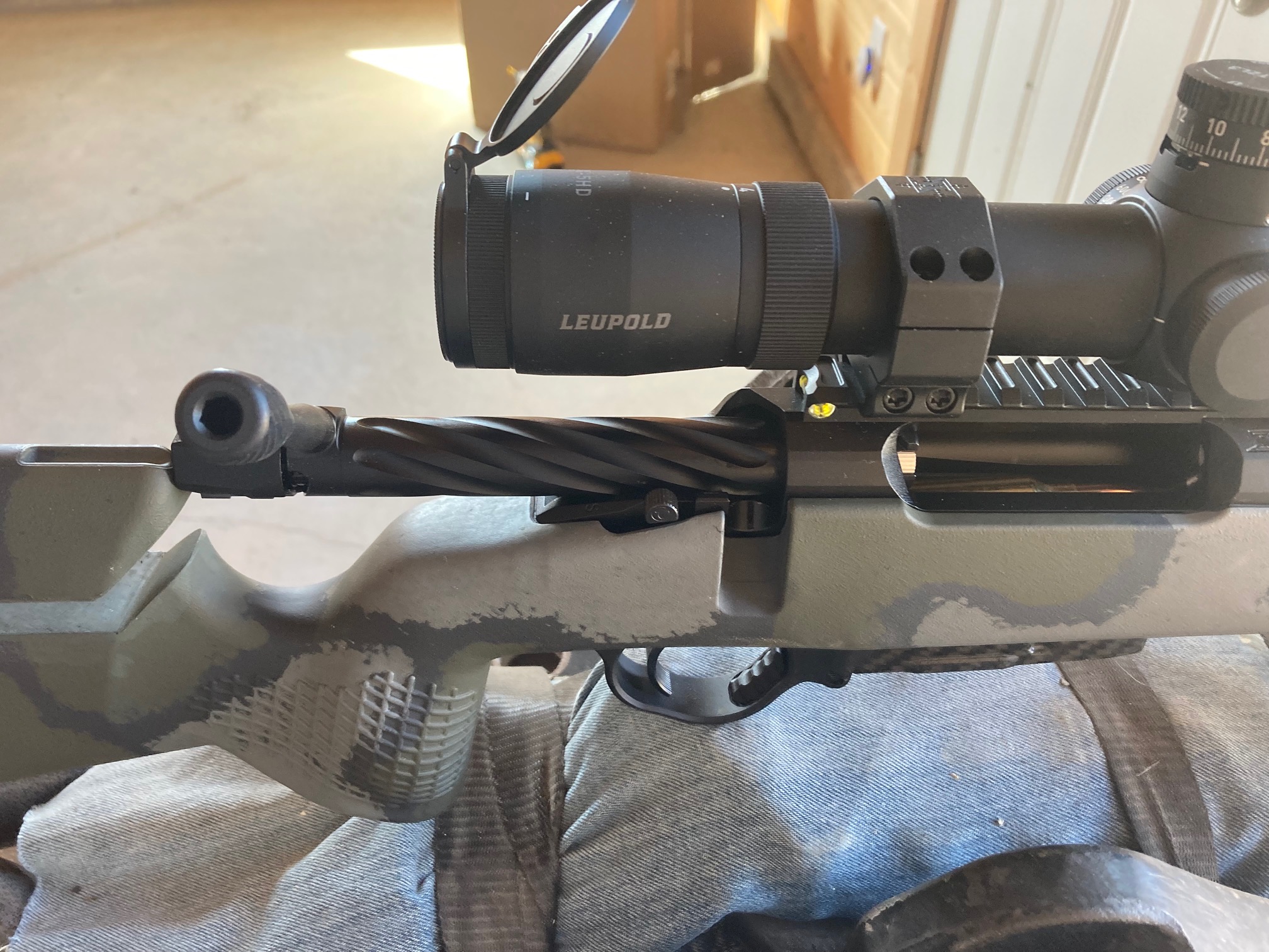

I realized today there is a problem. With the riser adjusted the bolt can't open far enough to chamber a round from the magazine. Some material will have to be removed from the riser. I texted the Stock Doc and he said to send it back and he will fix and send it back the next day.
