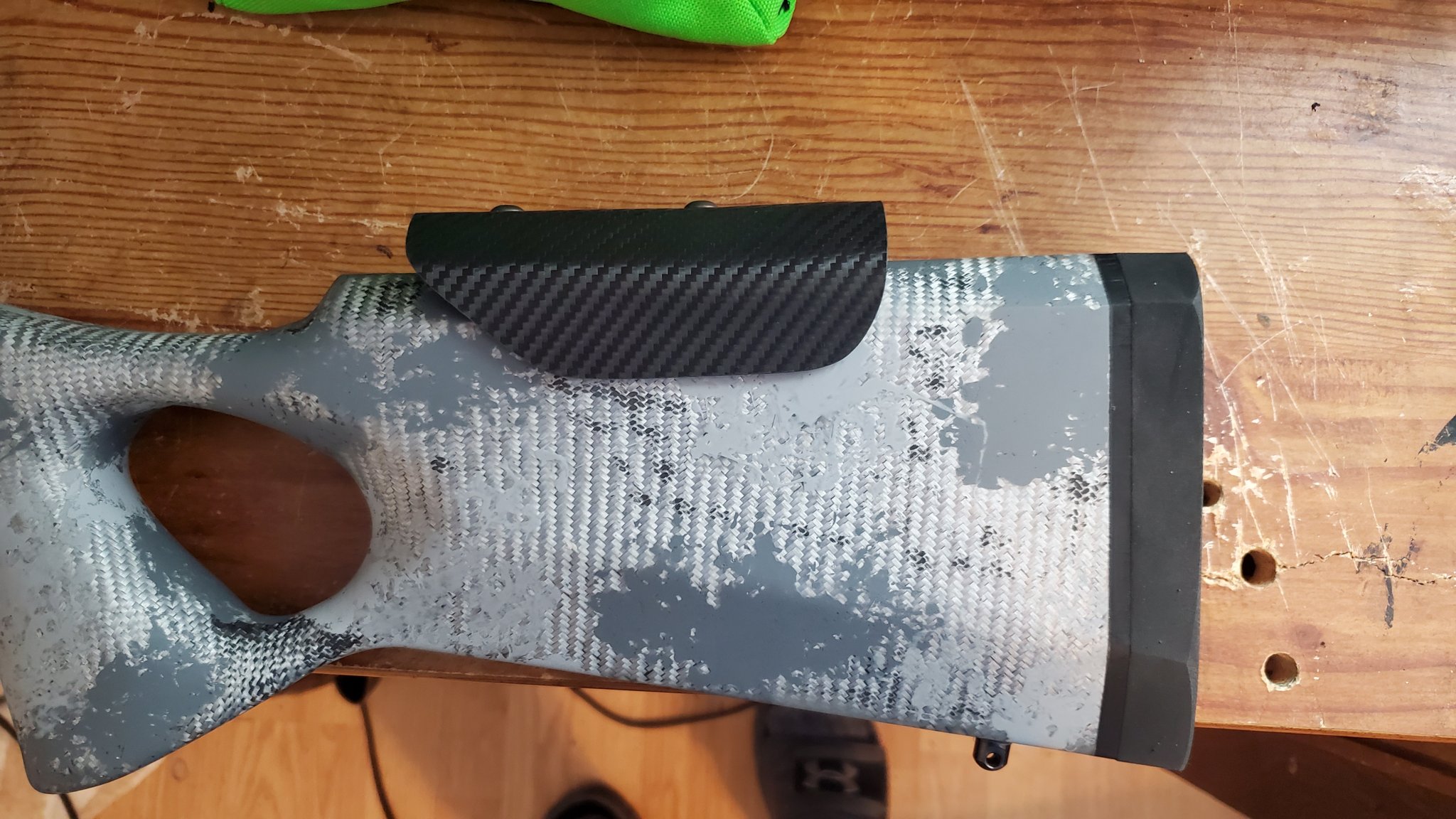

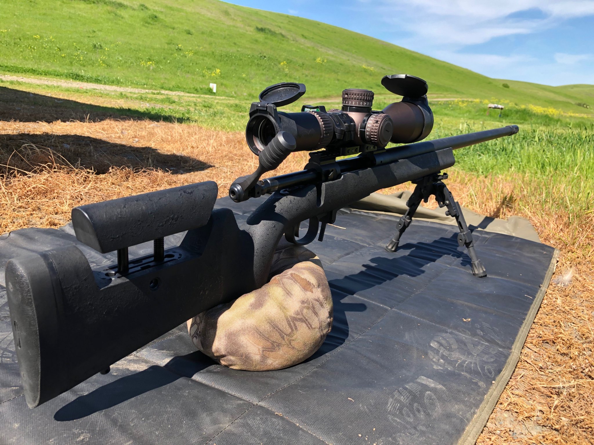

I put a KMW Loggerhead into my HS Precision. This is the same hardware that Manners uses and I'm a big fan.
There's a guy by the name of Joe Ducos in Modesto who did the modification on the stock. The key selling feature for me is that you can slide the riser side to side to allow people with wide cheek bones to get lined up better behind the optic.
Reactions: Multi-Tool
I like that setup!

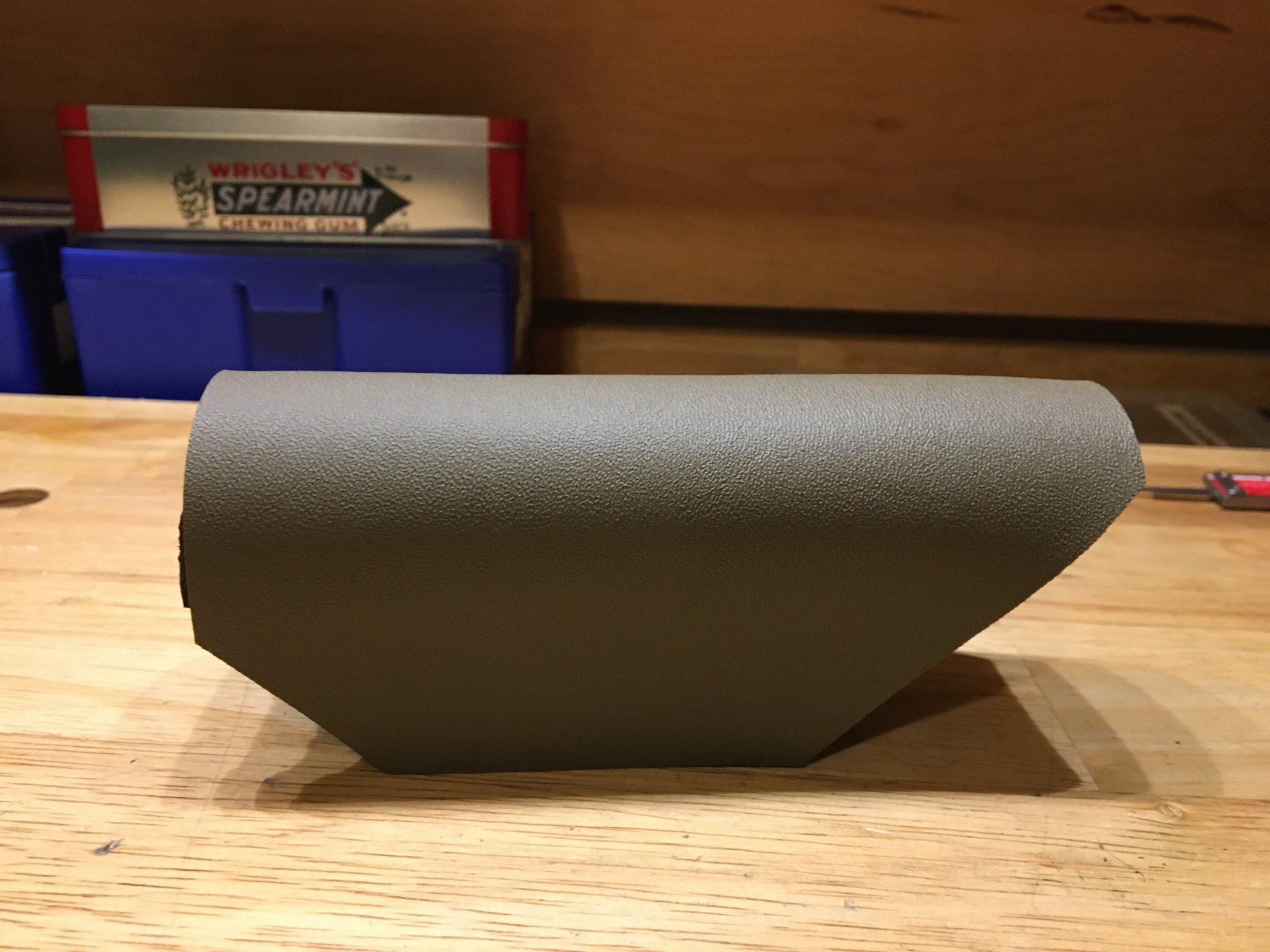

I bought one of these. Has Velcro that holds it to stock. Works great! It is just kydex.

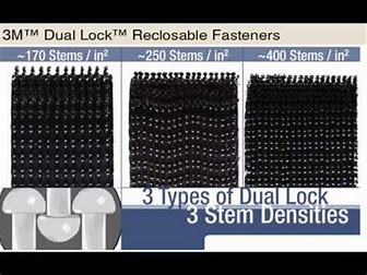

I just had a thought for your problem. Drilling holes in your stock would suck so my alternative that I offer to you is this:
Go to McMaster Carr and do a serch for 94935K17. It is for some "snap together fastener."
It is basically super Velcro !! It would certainly grab with enough force and it's design would prevent your cheek piece from moving at all. It can be repositioned like Velcro but it is a much different product. 3M makes it and it is called Dual Lock. I have also bought it at Radio Shack, Home depot and Lowes but I know what it looks like. The photo called "dual_lock" is the way you will see it at your local stores.
It is really some fantastic stuff !! Both side of the material are the same shape and the little heads interconnect firmly. Once your introduced to it, you will find plenty of uses for it. I have included a photo of stem densities but you don't need to know that. You will end up with 170 or 250 and either will work great. The advantage to going to McMaster Carr is that you can get different widths and lengths.

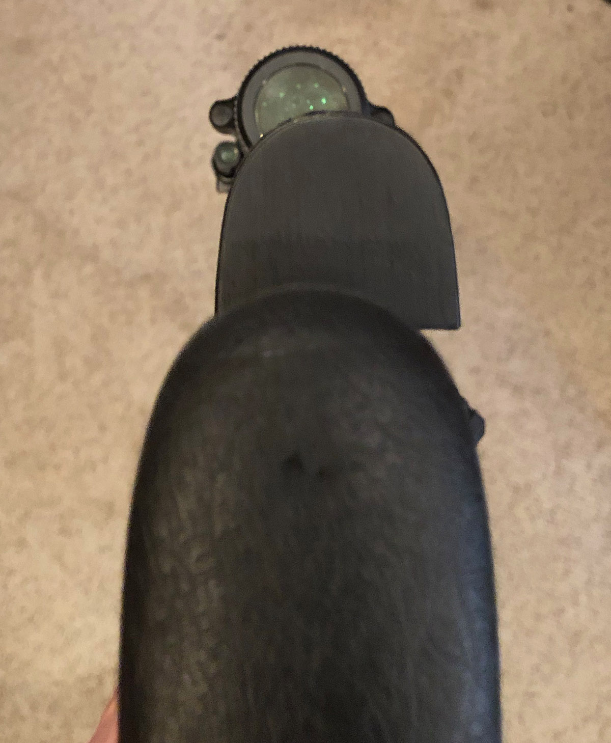

I'm working with a Kydex company right not that will mass produce some kits for me. You have to drill and install 2 threaded inserts just like you would for flush cups. Manners will actually install the hardware if you order a stock from them. Then it has shims of various thicknesses. I needed a super light weight option for hunting rifles. This is my first prototype. After I get this first batch back, I will be looking for a couple DIY guys to install them and give me feed back. Kit will include inserts, spacers, screws and the cheek piece.
Reactions: Codyarkansas
What does the hardware look like on the other side?
Will it be adjustable fore and aft, (please say yes) or is it more of a hope you get it correct or you'll pinch your cheek?

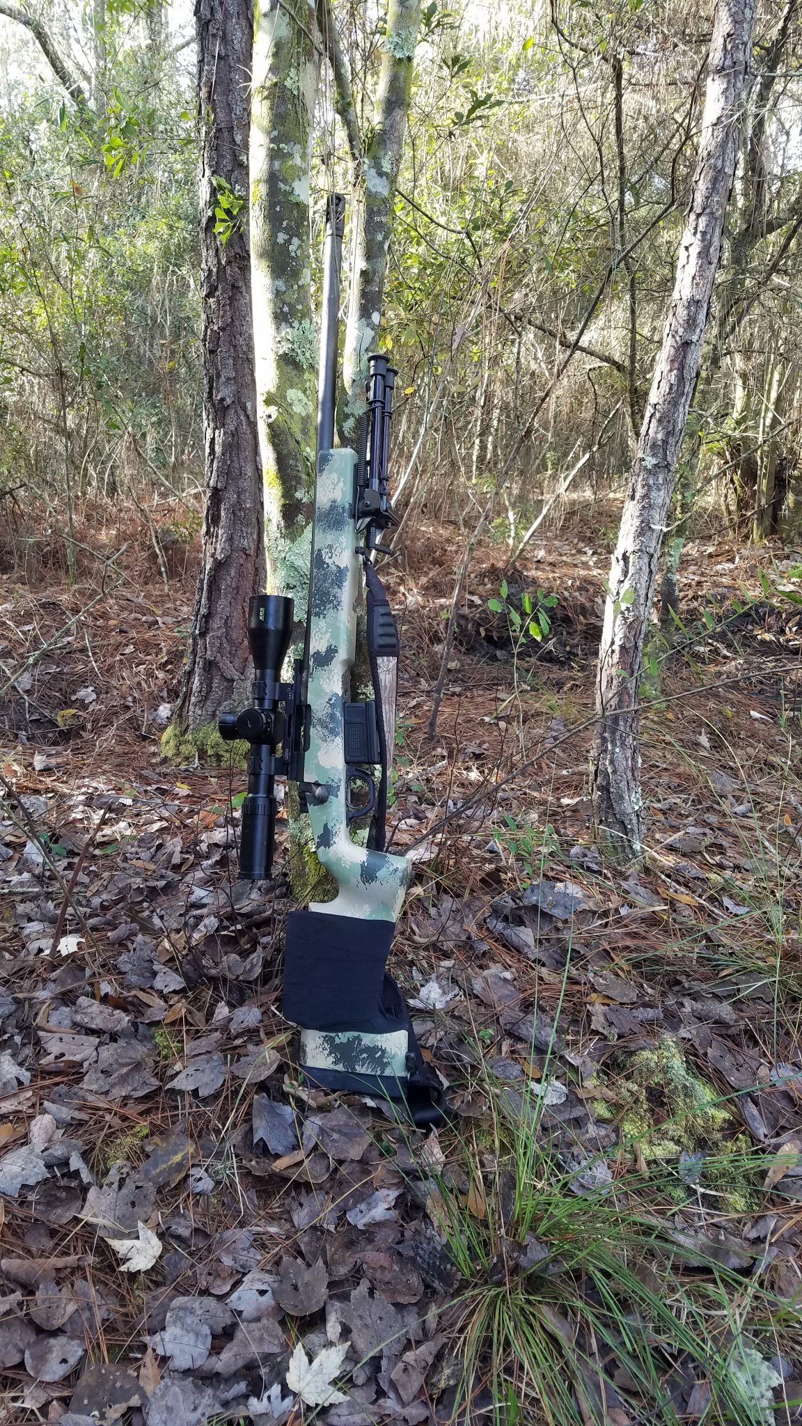

My most recent DIY project:

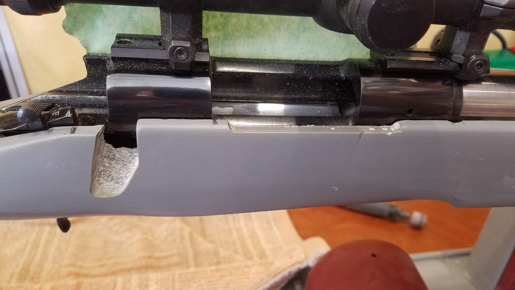

This Macmillan A4 was inletted for a Winchester when I got it.
Had to install pillars, a cross bolt, clean up and re-do the ejection port and bolt handle cut out.
Installed Magpul bottom metal (okay, plastic) and painted it.
As you can see it needs a cheek riser.
Built a temporary one out of rolled up tool drawer liner and K tape. I used the K tape so it wouldn't gum up the paint when I remove it.

It looks the same on the other side. Has 2 screws from the top. For right now, I am not drilling the holes in the riser itself to the user can set it where it is. And really, you dont, or at least i dont, feel the screws. I might try some thicker kydex to recess them a tad. I had also thought about drilling a few sets of holes in the front and rear to add some adjustment. Shoot me a PM and Ill write you down for when I get a few kits ready.

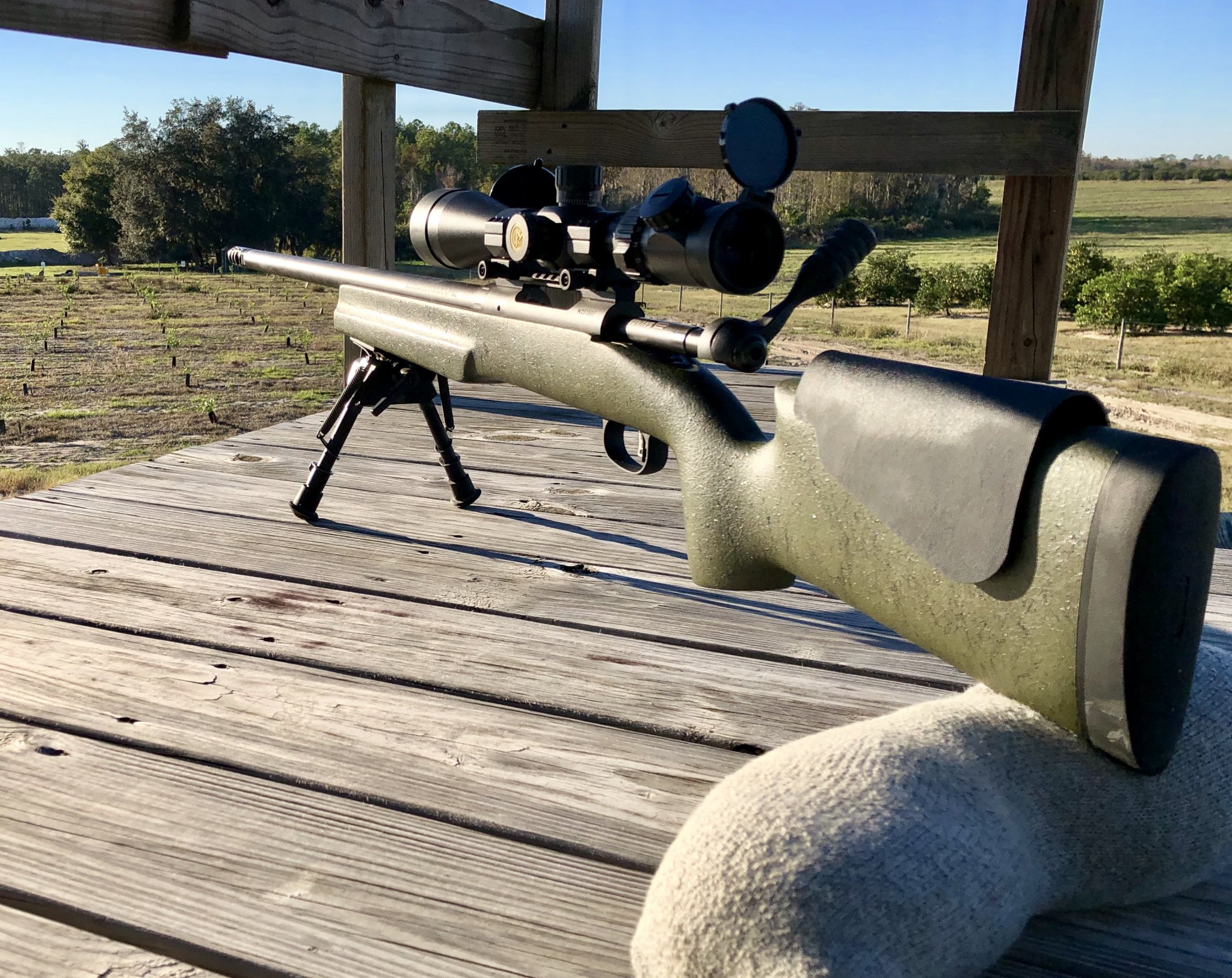

I know this is a bit of an older thread but I am posting for the benefit of those who will be coming to it going forward. I recently found and purchased the Titan Universal Cheek Rest for my t1x and I really like it. It's $30 USD, and does what it needs to do. The intention is to screw it into your stock, though you could get away with taping it if you didn't want to screw it in.
