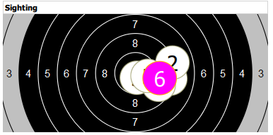

    Yesterday I noticed I had problems with parallax when shooting prone at a scatt target at 9 yards away and this is my actual training distance at the moment.
    I then improved and lifted my cheekweld about 0.1" and now tested it.
    Method:
    Stock: GRS Sporter with padded cheek pad
    Scope: Athlon Cronus
    I am using 25 yard parallax at 10 yards at 4.5X zoom with illuminated reticle.
    I always set parallax at the ranges at max magnification but I think it is impossible to rule out parallax error completely in my normal shooting or when time is limited.

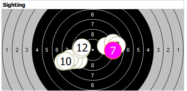

    I placed my head in 6 different positions that I feel comfortable and surely use at the range too head and shot 2 shots.
    All of the shot pairs ended up being very close together but the difference between head positions was very clear.
    It seems that it did not matter if my head was too front or back, the main issue was that the cheek pad roundness causing my head position to be sometimes just a little bit too low or high.
    And because the cheekweld is round, the hits also followed similar angled fall from up-right to low-left.
    What surprised me that between all the different positions, I could not get hits to the center but instead they grouped as 2 distinct groups.
    I think this is due to learned positions or just there are some comfort zones in the cheek pad that I have accustomed to use?

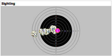

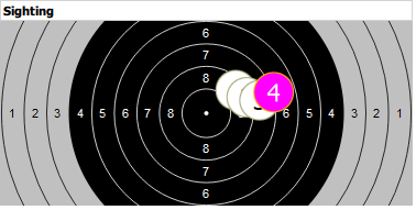

    I am now much happier with the parallax error than before the cheek pad improvement. I ran another serie of shot pairs, without looking any aiming help from the computer screen for the bullseye.
    I then wanted to see what is the maximum parallax error for fun and moved my head all the way to left until the scope just barely started shadowing.
    So it seems my whole parallax error pretty much covers the 1.8" target (10m air rifle target) at said 9 yards
