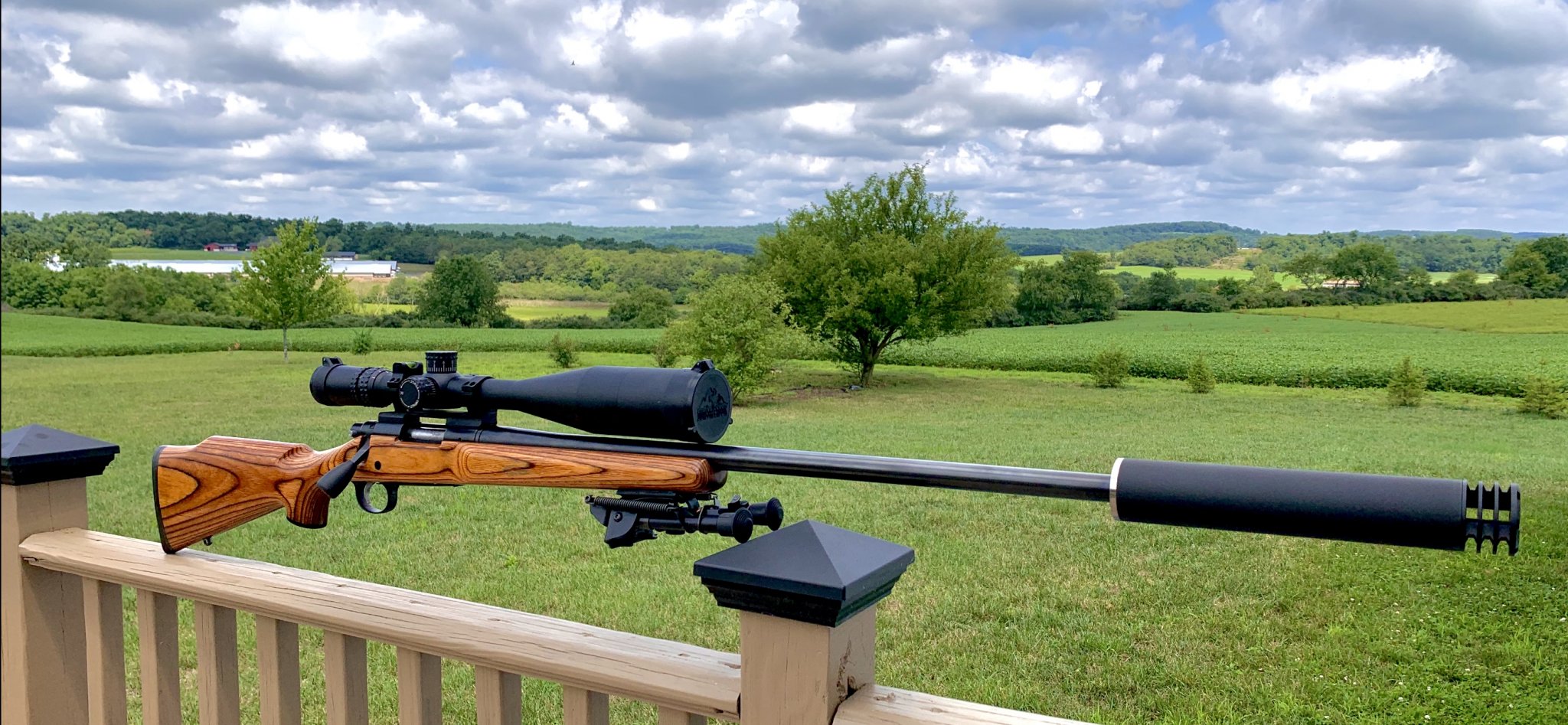

    Whats everyone running on their big boys?
    I am picking up a 338-408 cheytac soon and also would like to get into the ELR game down the road (possibly 375/408 cheytac) so would like to hear of cans that can handle basically anything thrown at it and is good up to 416 cal.
    I currently have a 338 silencerco harvester big bore that I bought initially to use on a custom 300 rum build I wanted to do (had a buddy with a 300 rum w/ a 30” bbl and same can and was a dream to shoot) but came across the opportunity to buy this 338 cheytac don’t feel comfortable trying the harvester on it. So the harvester bb will serve as primary duty on my 223 I suppose (I like the look of big cans anyways) 🤷🏼‍♂️
    Anyways the elite iron cans look nice, watched a yt vid of their “factory” and looked very impressive. So I was wondering what everyone else is using out there and also would love any input if you have experience with multiple cans and how they stacked up vs each other. Weight isn’t a concern of mine, quieter the better.
    Thanks in advance!

    Well I have a lot of cans but I think you'll find that most folks don't have a lot of the big bore shit like that. And if they do, they don't have many. I have an Elite Iron .338LM can I bought a few years back but don't have a .338 rifle yet (41f and all that shit). It's a well made 316SS tube with baffles and it's about a foot long and 1.75" wide I think. It uses a brake that reflexes about 2" so it only adds about 9". It looks like a performer.
    But I also have a .50BMG can from Elite Iron and that one I have used. It's a fucking tank, Dale doesn't fart around. Baffles look like half inch steel plate. The brake is the same brake Harris uses (he makes 'em) and the can and brake both time to the rifle without the use of shims. Both have wrench flats per my requirement (he's a full custom shop too). You can't go wrong. Oh, and the cans only cost me about as much as typical high end 7.62 cans. SS is heavy, but I've never seen BMG cans that weren't. It's safe to figure a .408 or .416 can will be built to similar if not same specs and as far as THOSE caliber cans go, well, Elite is the only one I'm aware of that makes 'em and certainly the only one I know of I'd trust.
    Don't expect the same kind of performance though, they serve a different function IME, with a BMG they basically work like big ass flash hiders and make it harder to tell where the shot came from or how far off the shooter is. It's still loud as fuck. Recoil is still like getting kicked in the shoulder. You still need ear pro, but you may be able to get away with only one pair vs. the usual plugs plus pro.
    So Elite Iron is GTG, one I can safely say stay away from is AWC, if they're even still in business. OSS (?) made a reflex can, not sure I'd go that route. Barrett makes one now. Uh, AAC makes or made one. I'd also be wary of any QD BMG can but not sure about Cheytac. There's a reason the rifle below came with a threadover brake but they never made a can to fit it... Dale told me all about it. He won't blow smoke up your ass either, he's a good guy.
    The can matches the rifle perfectly, how he does it I don't know, but they offer any color or combination of Cerakote.
    Glad I got the .338 can out of the way, even if TBAC makes one now Elite should still be on your short list for large caliber cans (if you need a .338 can and need it lightweight, TBAC is the goto, if weight isn't a concern then Elite). Both are precision oriented suppressors FWIW, so that comes first. Both companies are top notch, best at their game and won't lie to you. I can rest at night sending you to either of them.
