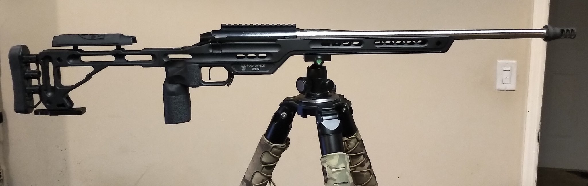

Well, I said the hell with it and ordered the origin and a 20" proof carbon fiber barrel. The AI chassis I want is out of stock so thats gotta wait. I already have a Timney HIT for it.
I still haven’t been convinced that spending more than the origin actually gains you anything tangible. I don’t think you’ll be disappointed with it, I’m certainly not.
Reactions: Another Casual
Origin and a proof?
You'll like it. Good call.
