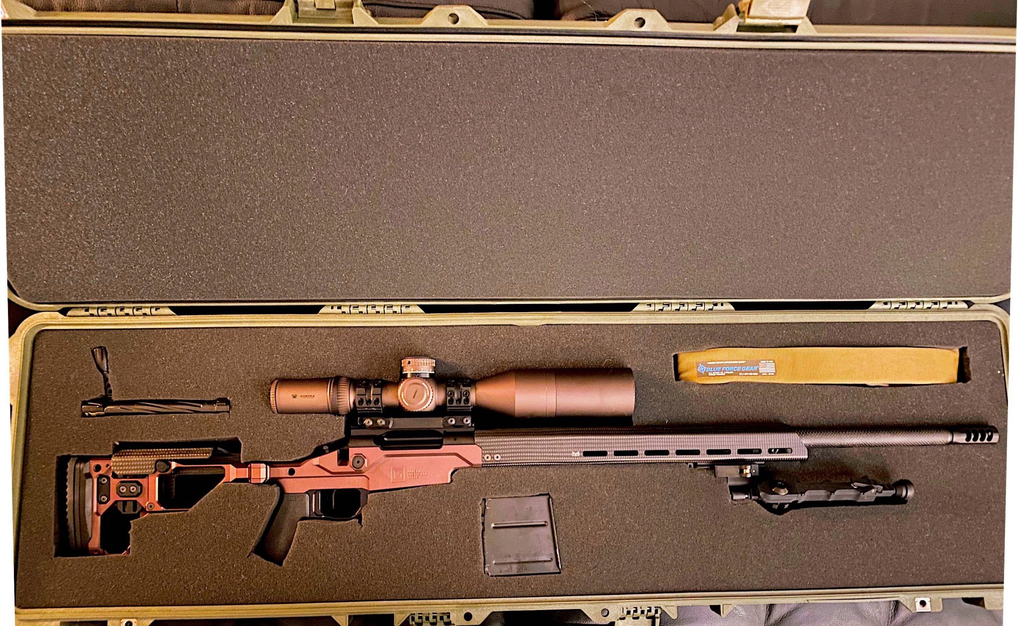

Around Christmas, I bought an MPR in .300 Win Mag with the 26 inch carbon fiber barrel. I mounted a Razor ii in a Spuhr unimount. Picture of the gun below.
I proceeded to take it to my local indoor range to zero the rifle and chrono loads before taking it out to my outdoor thousand. CAs recommends a "barrel break in" that is completely ridiculous. Check it out on their website. I forwent any break in as its <nonsense> (this will become relevant later) and began attempting to zero my rifle. I spend two hours shooting Hornady 178 ELD Match. At 100 my first group completely covered edge to edge of a standard ST-4. Like truly thought something was broken. Such a large group it wasn't even measurable. Due to this, I brought in my target to 50 with a fresh target and began again, hoping to get a group closer and figure out what was going on. I allowed for about a 10 minute break. At 50, I would be able to get a 3 or 4 round group in a roughly 4 inch group (still so unacceptable) and then I'd get a unpredictable POI shift from 4 to 10! inches. And would be completely back to square one attempting to figure out what the hell was going on. I mean I still hadn't even gotten a rough zero. After 5 strings the groups were so open I had trouble identifying which shot was from which string on the 4 quadrants of my ST-4. This continued for TWO HOURS with different lengths of time to cool the barrel, putting up fresh targets, readjusting my rear bag (at one point I started questioning my sanity and if I even knew how to shoot), and trying every thing I could think of. I'd readjust my Razor ii zero and what do you know, if it wouldn't jump halfway across the paper again. I ended up giving in after two hours of chasing zero and way way way too many rounds of .300 match ammo... Nowhere closer to having any resemblance of a zero. I should have saved the targets but I was so pissed I didn't think about grabbing them. Sorry.
It's heat soak guys... It's heat soak... Like all these reports of heat issues with CA barrels are completely true. I DEFENDED CA against these rumors when I first got this gun. How wrong I was... The occurrence of POI shift would roughly correspond to the length of time between strings. However, no POI shift was ever the same and never returned to a previous zero. It was not consistent either and I'd experience groups and group shifts from 4 inches to over 10 inches. And before anyone suggest I don't know how to mount a scope... I checked all rail screws with a inlb torque wrench. I mounted the Spuhr and Razor using manufacture specs, using rosin on the interior of the rings and triple checking all torque readings. Unless my brand new Razor ii has a SERIOUS problem (which we all know is extremely unlikely) then its most likely the gun. Also the fact the POI shift would change relative to round count and periods of rest is really indicative of bad barrel deficiencies.
I called Christensen Arms and received a rude reception. The guy on the other end started off by condescendingly asking if I hadn't followed their break in. That I should have followed their break in. IMO CA having this policy on their website is just an out to allow them to brush off defects on to the owner. It's well known that modern barrels see ZERO improvements with break in. Tolerance and modern milling means there is no need for a "break in" anymore. When I walked the rep through my barn sized groupings and insane wandering zero, the CA representative was entirely dismissive and LAUGHED saying "well yeah this happens to all guns when they heat up". Like yeah thanks for that wisdom guy. Like thats basic physics, pretty sure its called the thermodynamics... Obviously hot barrels have a POI shift. But a shift AND spread of 4 -10 inches at 100 yards for a $2,300!!!! rifle is absolutely bat shit insane... like insane. The CA rep then proceeded to tell me that using 178s was also the problem and that 200grs would shrink it to sub MOA. like... no words... Obviously certain guns don't run certain pills well, but at a 100 yards, you cant tell me a different grain is going to fix a 10! inch shift and a group I can't even measure. After talking for 10 minutes the rep begrudgingly offered me to send in my rifle under warranty but I was so pissed I said I'd call him back if/when I decide to do so.
I have defended CA's, before I even shot this rifle, in this. They have a stellar reputation. They have won precision gun of the year. Always sold out online. I was THRILLED to pick up this rifle and told everyone this was to be my lifetime precision gun. I don't make a ton of money. It took months and months of saving to be able to purchase this rifle. For $2,400 this thing should be resilient and reliable. Obviously guns have a POI shift but it should be at least be repeatable or make some sense. And it sure as shit shouldn't be a 10in shift at a 100 yards in a .300 made to shoot at a thousand. If I could sell this monstrosity and buy an MPA, or hell even another budget ass plastic ass Savage (I <3 my savage, no offense to you) Id do it in an instant. But truly I wouldn't even be able to bring myself to dump this garbage off on someone else. Many people may have good experience with CA but it isn't worth the risk of getting one of these lemons.
I went from defending Christensen Arms, to urging people to never buy one of these rifles. What the hell Christensen Arms...

That's sad that you are not happy with the rifle. I have a CA traverse in 7mm and it shots awesome. I did find however that it does not shoot Hornady Ammo very good at all I don't know what it is. Does seem like you should send it back to them if you are not happy.
I would suggest trying it with a proven scope just to rule out the possibility that your new scope isn't the problem, as unlikely as that may be. No need to put dozens of rounds through it, just one 5 shot group will be difinitive. If the problem persists, send it back and give them the chance to make it right.
Where I raise question is you saying the POI is changing and not returning, aside from the barrel loosening, thats not indicative of a barrel issue. That suggests it's more than likely and optic or mount issue. Are you sure you checked the base screws, mount screws, and cap screws? Did you confirm this optic on another rifle afterwards or run another known good optic on this rifle?
No dog in this fight. But I would do as above and test it again with a known optic while rechecking all mounting screws.
However if it is indeed the rifle, they have said they would take it back and check it out.

.300 Win Mag has a tendency to loosen up shit. I always properly torque my mounts to spec and my chassis. but without lock tight, after a few boxes of shells its loose again. I would check the VORTEX and SPUHR first. Worst case scenario is to send it back for warranty repair at no cost. Their customer service has always treated me good so dont know whats that about, maybe its the coronavirus cabin fever.....or maybe you started the conversations dickishly. I wasn't there so who knows. I have several highend weapons and the only one I have never had a single issue with is my old reliable Remington 742 woodsmaster.... with that being said, quality is not what it used to be, however give their team a chance to fix it before blasting them. I always save my blast off Ape Shit review until after I receive the gun back from the company and assure the issue was or was not fixed. We all understand your frustration in paying good money and expecting a product to perform. I do certain stuff for a living and have had $20,000 + Rigs fail in battle when I needed that bitch to kill. Anyhow, shit happens bro give them a chance to unfuk themselves and if they dont unfukit blaze em.
I just bought a Mesa lr in 300 prc with the steel barrel and was hitting small steel targets at 500 meters while I was braking in the barrel. I’ll admit I skipped some of the cleaning steps after about 10 rounds and no copper showing. The gun had definitely been test fired for moa. I would have put it away thinking something wrong a lot sooner. I was watching a guy at the range a while back having similar problems. He never got a round in paper at a 100 yards after 2 boxes of ammo.I didn’t say anything and tried not to be obvious I was checking his targets but it was such a dam good looking rifle. I think men put way too much pride into shooting. It should be fun and always something to learn
Also, how much time do you have behind a light weight 300wm? I have a friend who claimed his custom 300wm didnt shoot. I showed up to help with load development and started knocking out half inch groups. This was in a 13# rifle. Most of his trigger time was on 6.5 creed, 223 and a 308 gasser. NOT saying that's your problem. Just asking. Hell most people cant keep my 300 wsm featherweight on a pizza box after the first round off the bench.
