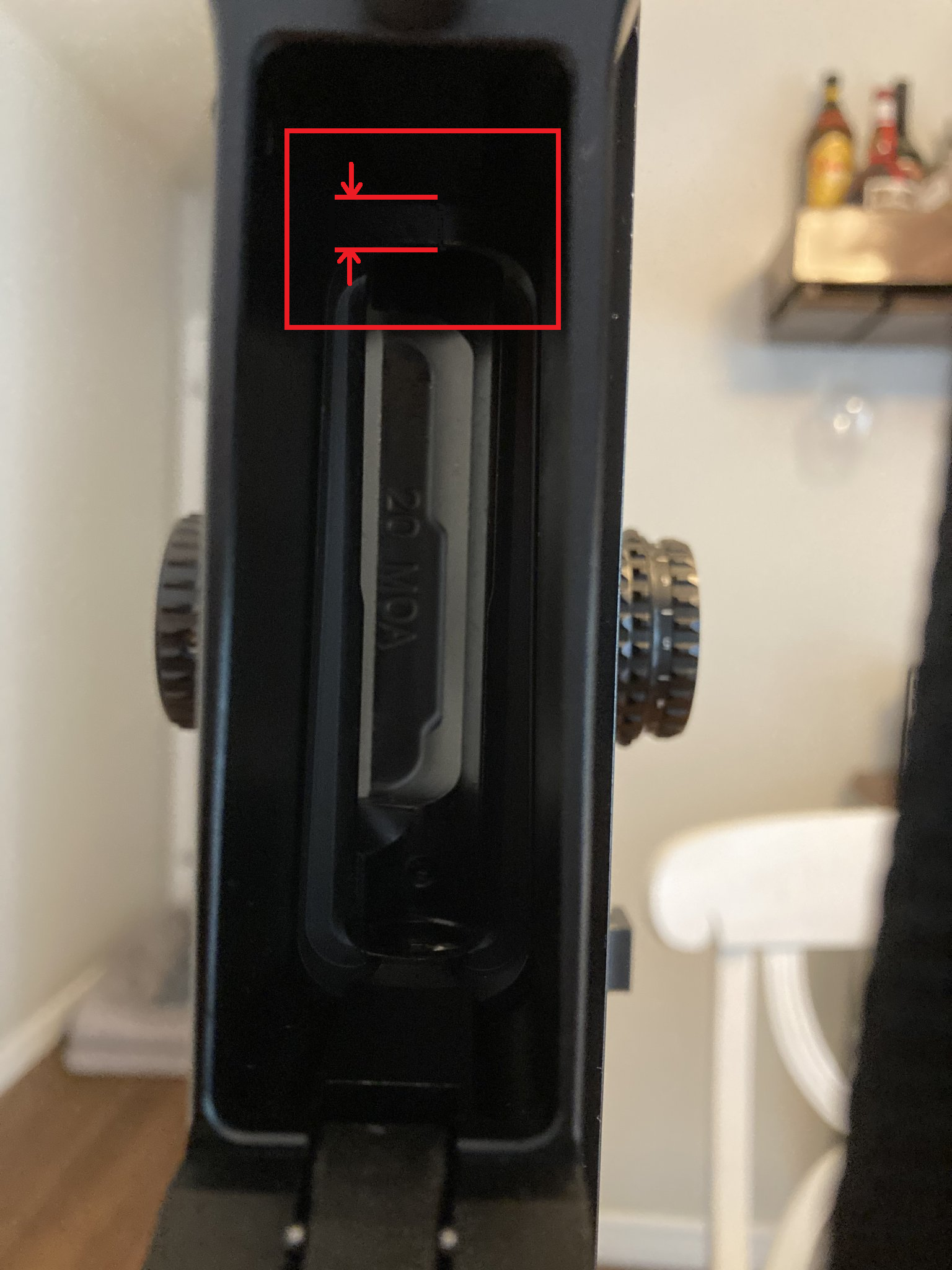

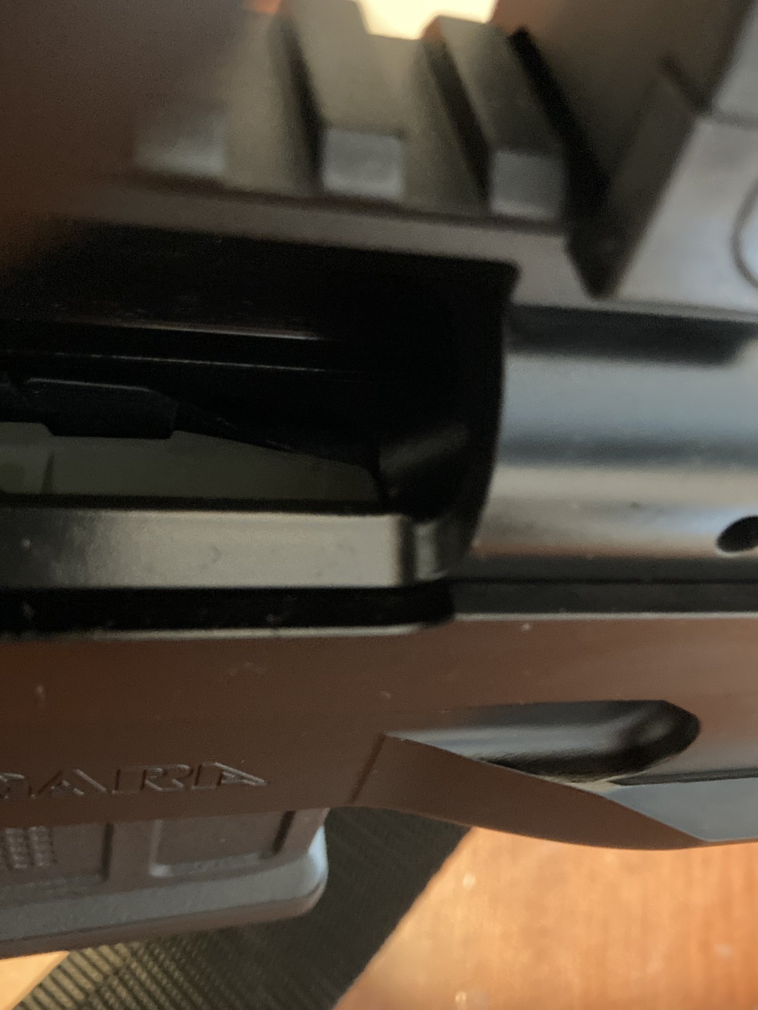

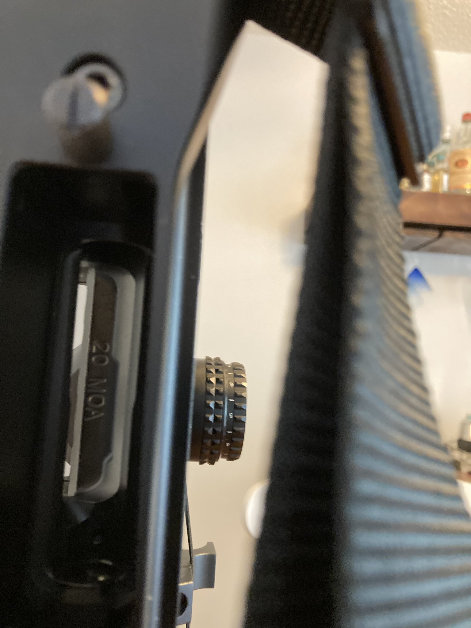

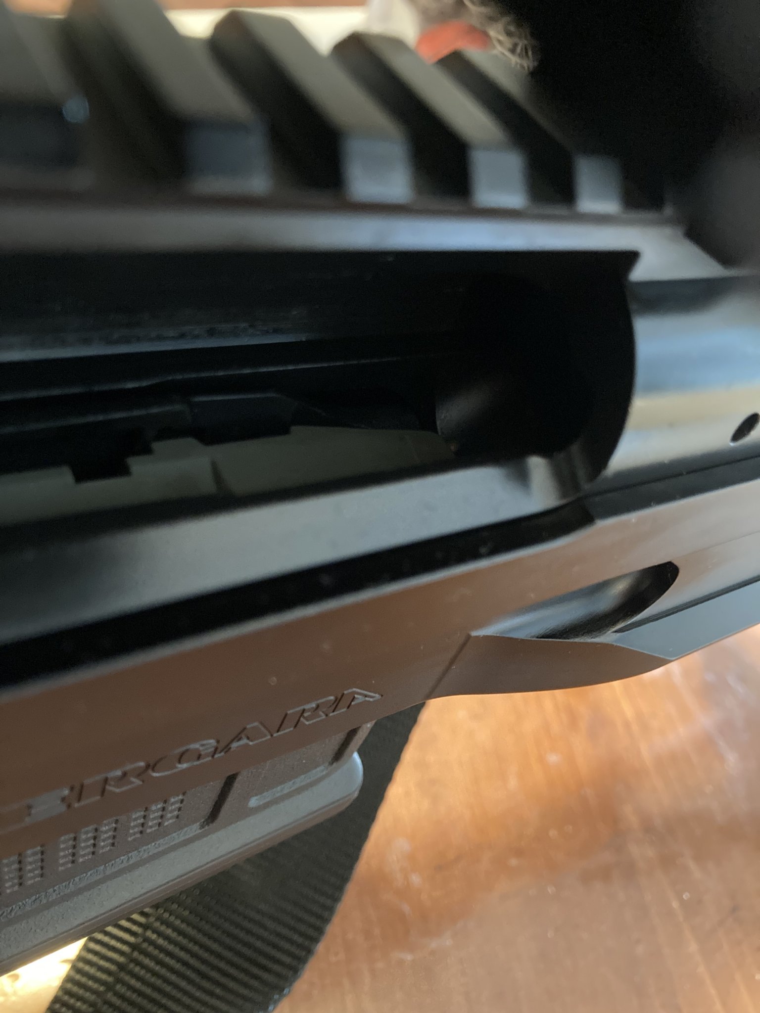

    Not sure if these pics help. It’s pretty difficult getting my old iPhone to take decent detailed pics. As you can see though, there is a gap between the mag and the feed ramp.
    That's perfect, thanks. Looks like it has the same issue as the standard B14 action, the receiver protrudes into the mag well. It's the rim between the two red lines I added to your pic, and this is the section that the bullet tip hits when loaded too long.
