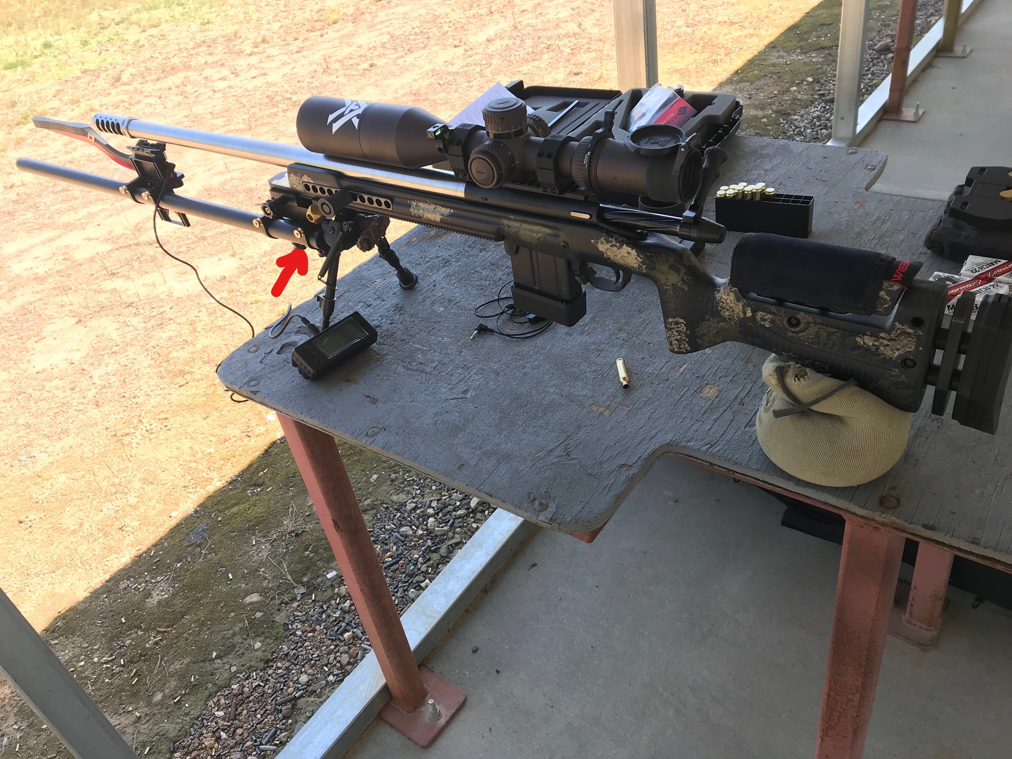

I have the Wiser Precision Magnetospeed mount and really like it. Easy to adjust and solid. It has an adjustment that allows for angle adjustment which is nice if not on perfectly level forends.
MK is best but I found that the set screws were too small and I increased the size of them all. It's not a fantastic set up that doesn't ever move. It was pretty good before and my wise mount broke so...

How far can you extend that? 24 inch barrel with a 9” can? thx
Yeah that is a 26" barrel on there now and you can see with the almost 4" brake there is still plenty of room. You should be fine with it and your set up.
