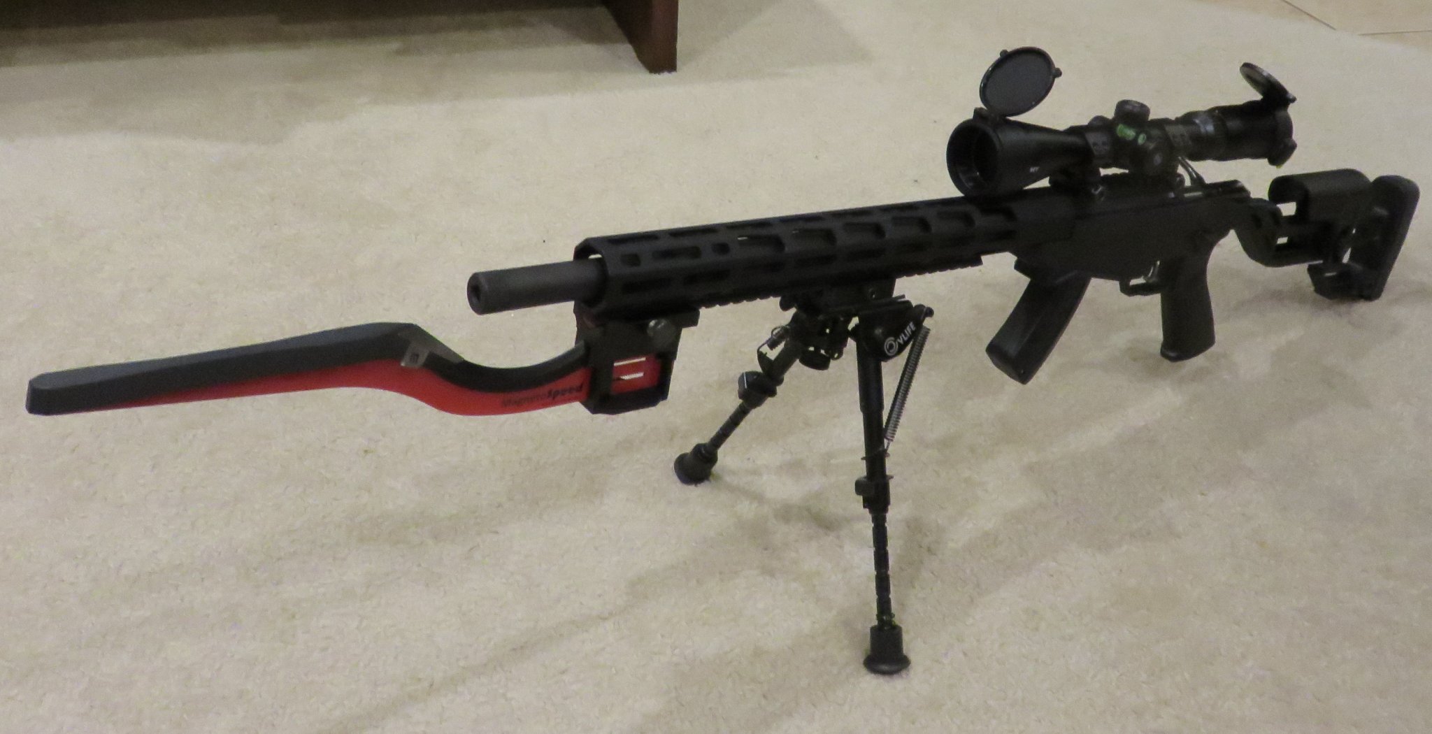

I feel a LabRadar is a great tool and probably best if one is shooting ELR center fire as it produces a lot go good data from down range. But, it can be tricky in that it too often doesn't pick up a reading . . . particularly if your in close quarters to other shooters (though the recoil trigger helps with that some).
I like my MagnetoSpeed v3 for my .22's. I get consistent good readings, and it's quite accurate. It's light and easy to mount. So, I really feel this is the better choice for rimfires.
