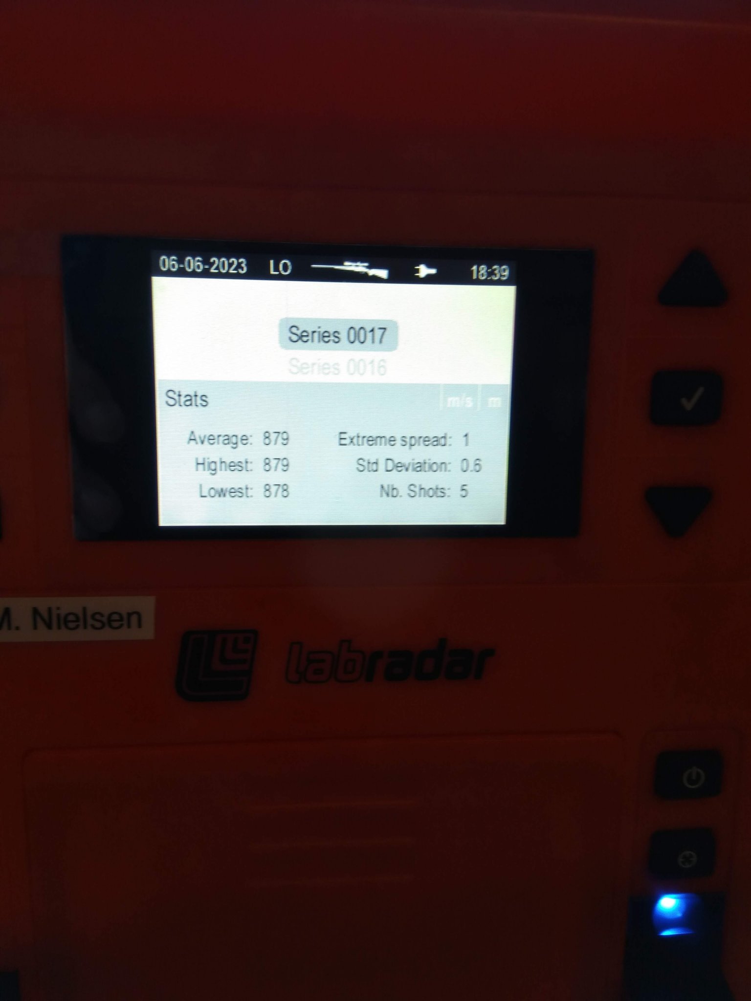

You mean something like this? ( the values are metric )
LOL. I can post a picture of a 5 shot string with zero ES and SD. Everyone has those cherry picked groups. So, no, I don't mean something like that. I mean actual long term data.
Your understanding of ES is just not how the stat works. When you have those types of strings, they are on the absolute end of outliers are all but worthless. The fact that you even posted that pic illustrates your lack of understanding.
We want to have a decent idea of what our ammo is capable of long term. Which is why SD is such an important number and ES really isn't.

This was one of my typical loads for the 6,5 - 284 and it was not a part of load development, but a QC before entering a long range match.

Yeah, agree with the sentiment that the different equation for SD doesn’t mean much in the grand scheme of things. Nor does the round up bias the LabRadar has. What’s more important is the narrative many people create that doesn’t allow them to critically analyze their assumptions. I don’t want to hand any of you those assumptions that you’re not familiar with. Keep searching for yourself and maybe you’ll find it. Make an effort to assert why the Garmin has “the right” SD even when you believe it doesn’t. I’ve entertained a few “rationales” as to why the LabRadar’s equation is appropriate. I clearly see how you all see the standard and my point is the standard you’re seeing is not the consensus practice standard.
